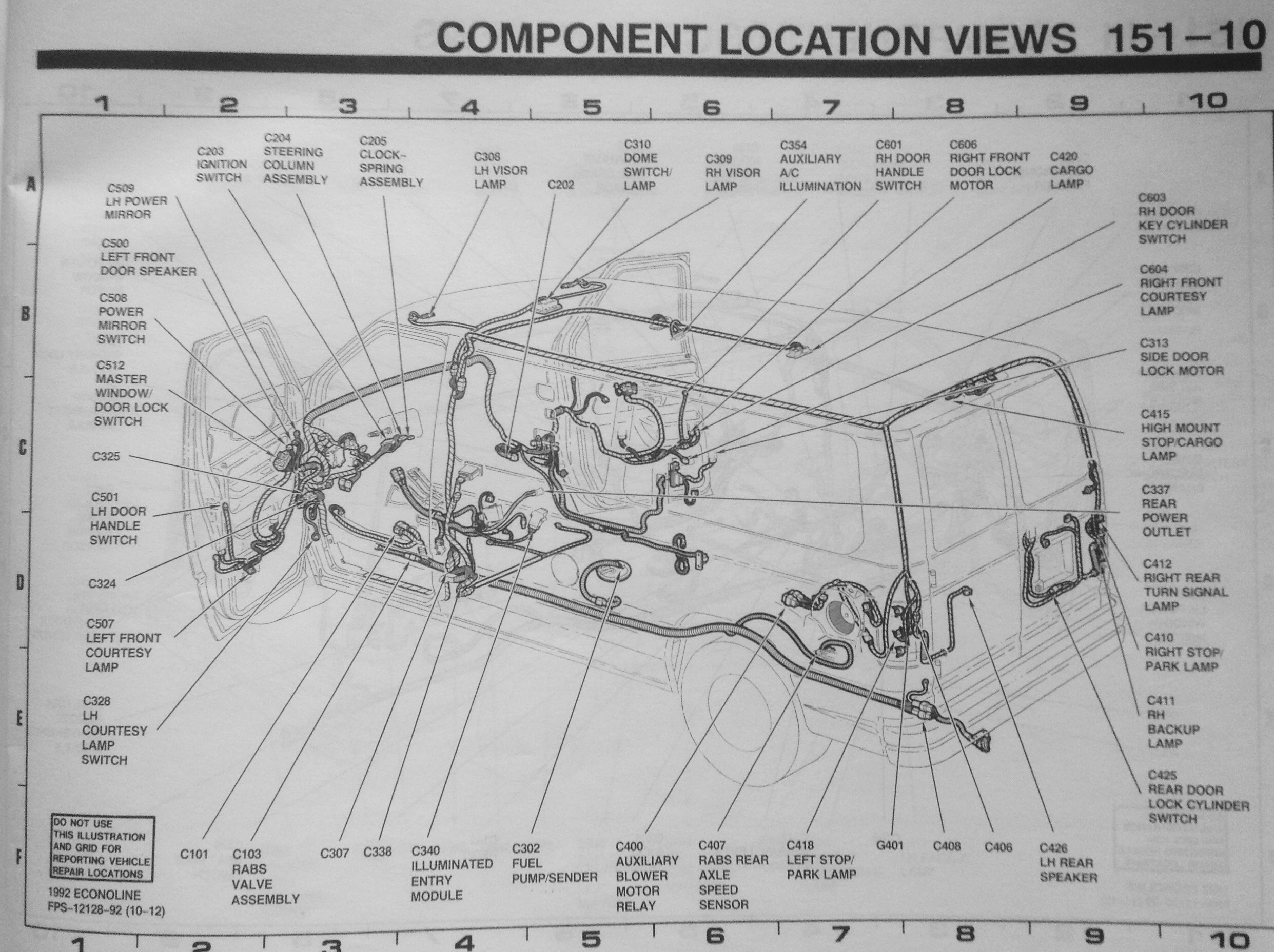

According to my 1992 Ford Econoline Electrical and Vacuum Troubleshooting Manual (*), the light green (or later light green with red) brake wire does go along the driver side, then shoots up behind the driver and back along the roof, while the other trailer brake wire follows the lower left body line back to the trailer connector.

You must be right. The diagram shows lower left, but I can see now that it is likely along the frame. (see pic below)Blue~Go wrote:PS: At least on my year, the Ford trailer wiring "schnozzle" wiring runs along the driver's side frame rail under the coach. Maybe all cutaways do that since there is no interior Ford floor.

This is just one of many wire, ground, junction and connector location maps in the Electrical & Vacuum manuals. Most useful to us cab forward and chassis below, of course.

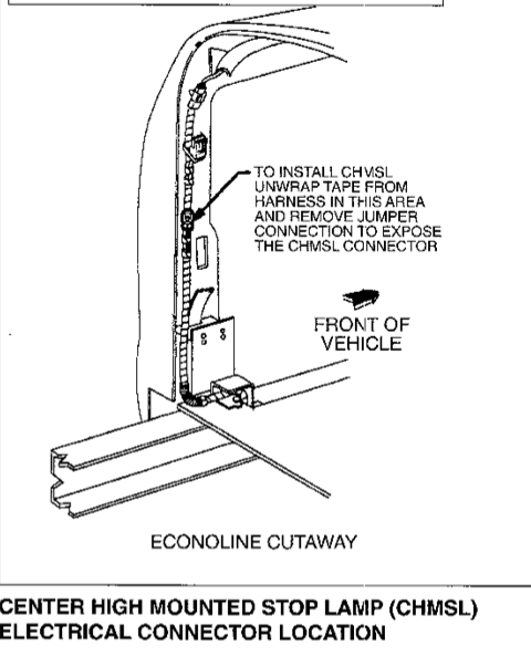

Say, I don't know if this would be of use (or exist in yours), but in the 1998 Ford Incomplete Vehicle Manual they (also) show a wire for a CHMSL (center high mounted stop lamp). What they show in the sketch is that it's in a bundle that runs vertically in the pillar behind the driver -- just aft of where the seatbelt runs vertically along that same area. It's hard to tell from the sketch, but I *think* it's coming from the step well area, running vertically where I described, and then maybe ends up by the roof.
They point to the center of that vertical run (in other words halfway from floor to ceiling) and say "unwrap tape from harness in this area and remove jumper connection to expose CHMSL connector."
Okay, that's not as good as a diagram is it...
