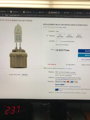

My driver side fog light is burned out. The passenger side still works.
I'd like to keep it stock, so I found a replacement bulb that I'm ordering and will see if the housing it comes with will work. If not, I will take the bulb
off and solder it to the OEM mount.
I prefer this to the fog lights online at Amazon or Autozone that are linked above that have the blue plastic face.
Has anyone done this before?

Re: Fog Lights/Driving Lights
Posted: January 19th, 2021, 5:40 pm
by chin_k
Soldering may not work, and you may have to crimp it if the leads get really hot.
Posted: January 19th, 2021, 6:35 pm
by Astrodokk
It looks like the OEM ones are soldered in, so why would it not work, because of the metal type?
I'm not a great solderer, but it looked like an easy enough job.
What would you recommend then?
I hope I can use the bulb as is when it comes in.
Posted: January 19th, 2021, 7:44 pm
by chin_k
Oh, if they use solder, then maybe it is fine. For some high temperature bulb, they only use crimp due to the high heat. It is very likely that it is not the case for your application.
Posted: January 20th, 2021, 9:18 am
by Astrodokk
I checked the bulb again and it looks like it may have been spot welded rather than soldered.
So I may have to re-think this.
Perhaps replacing both fog lights is the best way after all.
Posted: January 20th, 2021, 9:53 am
by chin_k
If they are not that expensive, you may try to solder it.... it may work. As long as there is nothing that can be damaged if the solder drip down, you can just turn the lamp on for a few minutes and inspect. You can also do that externally if you do not want to go thru the hassle of installing it.
Posted: January 20th, 2021, 4:29 pm
by Astrodokk
Found the bulb and the male connector at Autozone.
The original connector metal elements had corroded and dissolved.
I'm just glad that the lens is intact, otherwise that definitely would have to be replaced with a different design!
