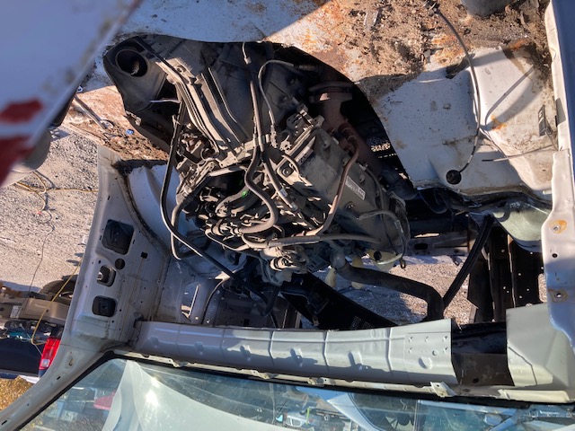

dash from the donor is complete as well as all the wiring pcm heater assembly and fire wall and floor section, ordered the new brakes for the axle

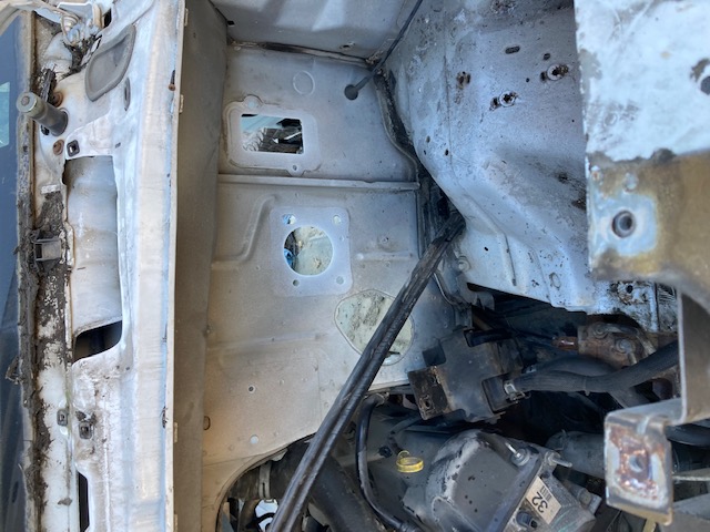

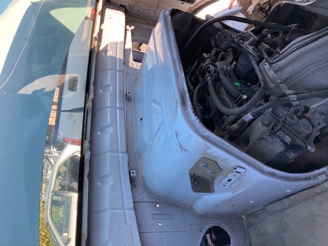

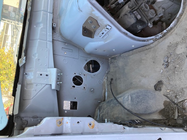

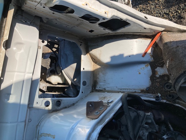

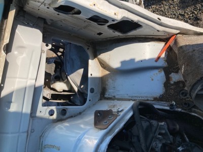

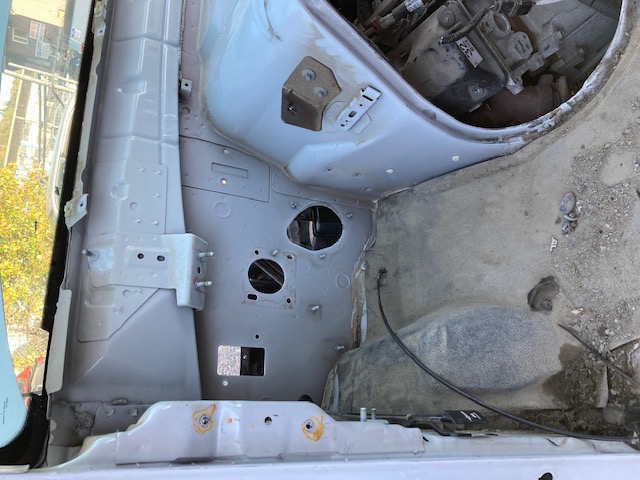

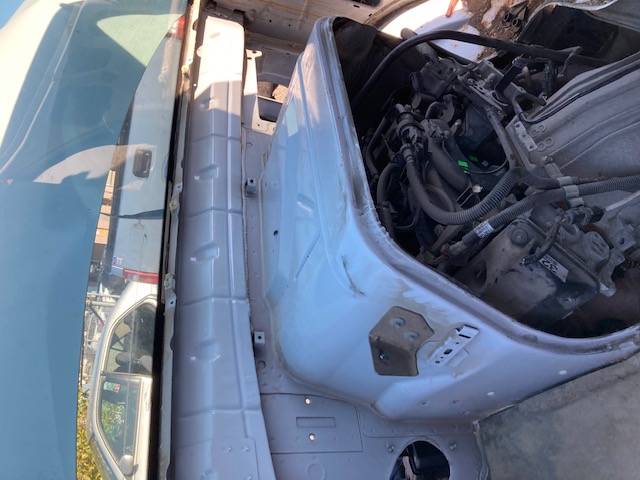

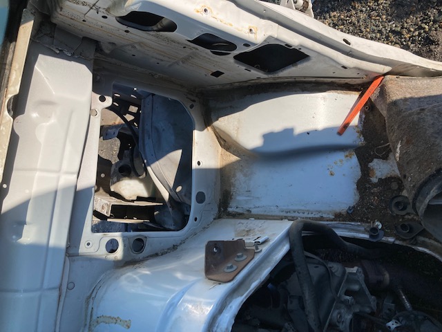

Post by noluck »
cab after floor section and firewall cut out
Noluck, this is huge overhaul, what caused the issues with cab?
noluck
Posts: 246
Location: Abbotsford BC
Post by noluck »
those pics are the donor cab, i just wanted to make sure i removed anything i might need to put the 2010 dash into the 1995 chinook

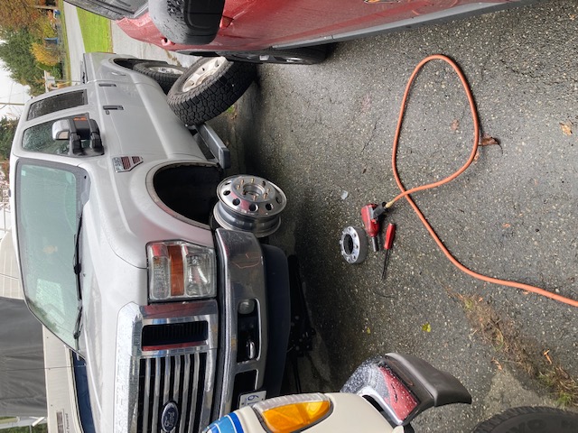

Post by noluck »

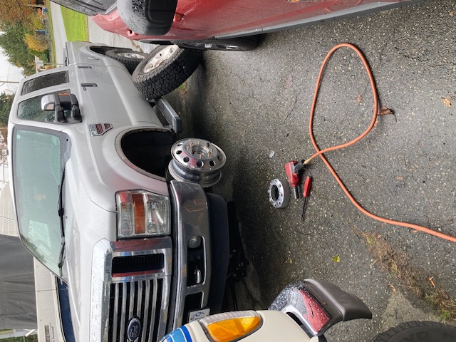

luckily i have a 2010 f350 so i could check the my wheels would clear my brakes with the 4" adaptor before ordering them. the van have the same track width as my truck

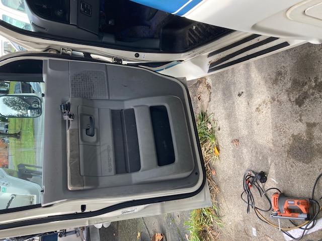

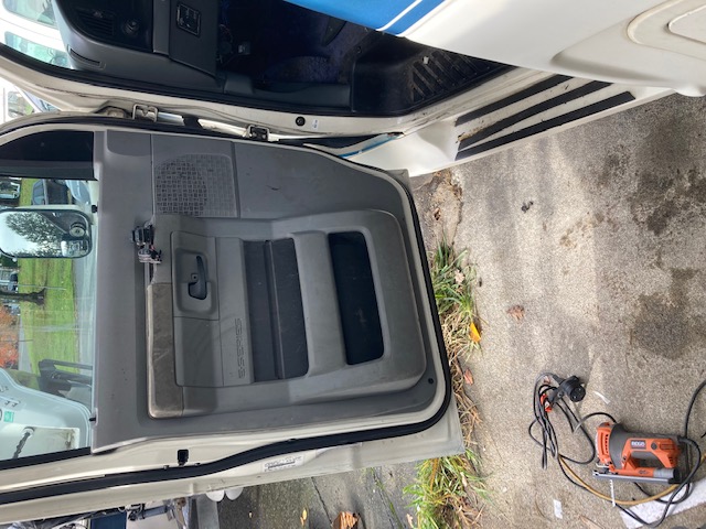

Post by noluck »
got ambitious and tried the door panel on my door, add one hole and fits right on
