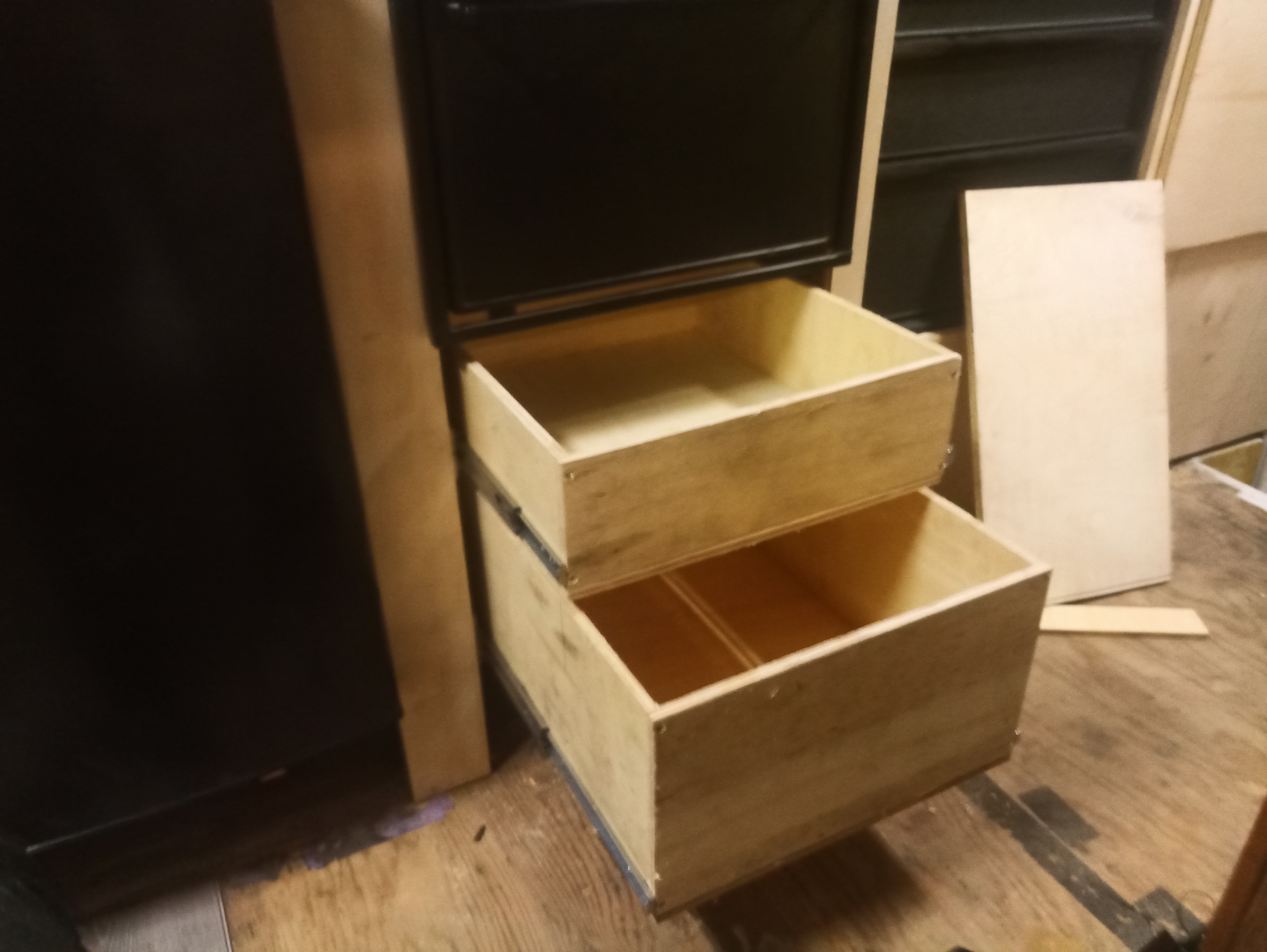

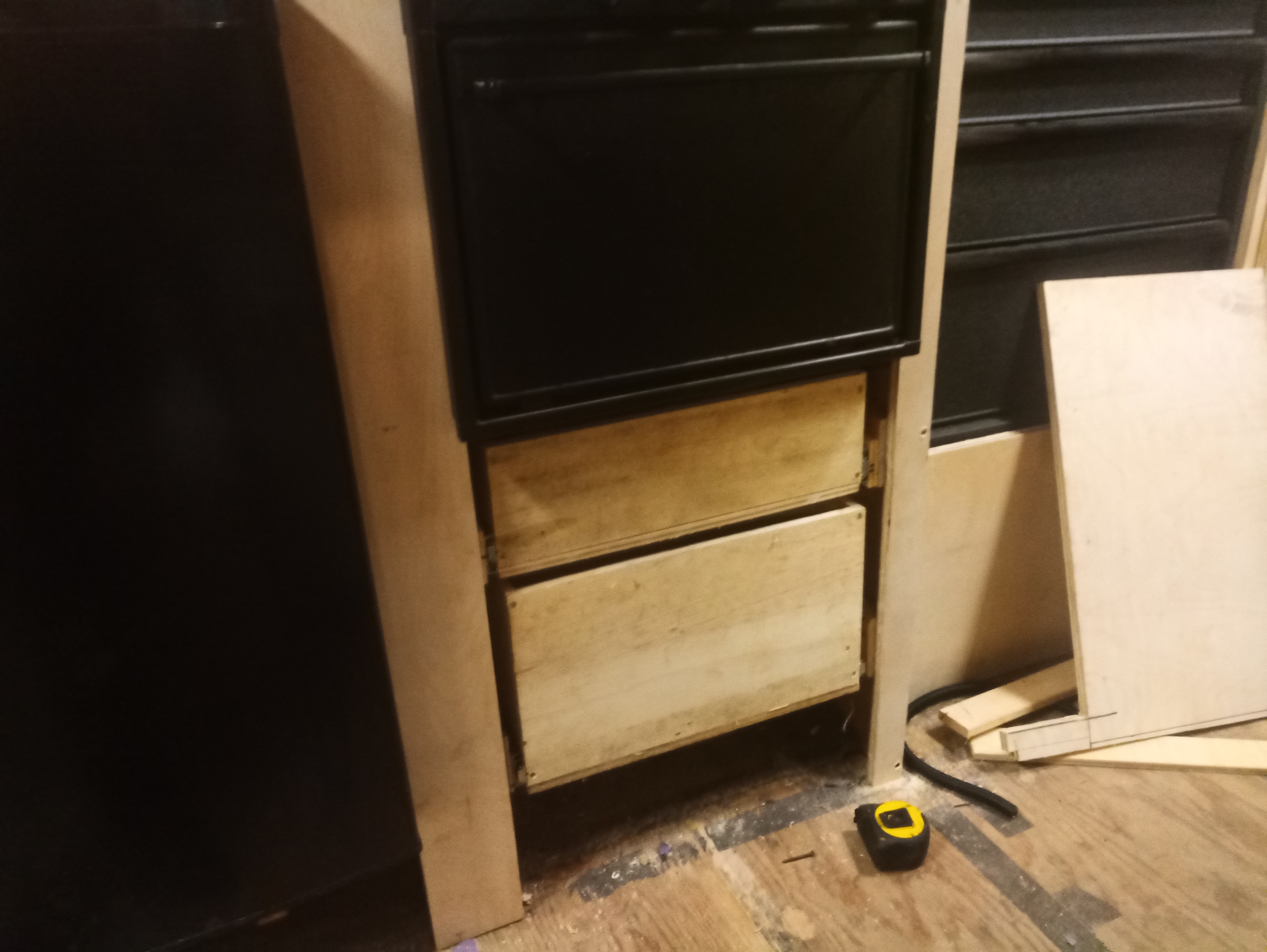

I did get a few things done on the chinook. I built two drawers under the stove. The bottom drawer is 12 inches and the top drawer is 6 inches. Now all I need to do to finish the kitchen is build some drawer fronts and face frames.
I've never build drawers before, but it wasn't bad. It's just one box installed into a bigger box. Getting the slides installed into the base cabinet was probably the trickiest part. My base cabinets are slightly out of square so it took some doing.

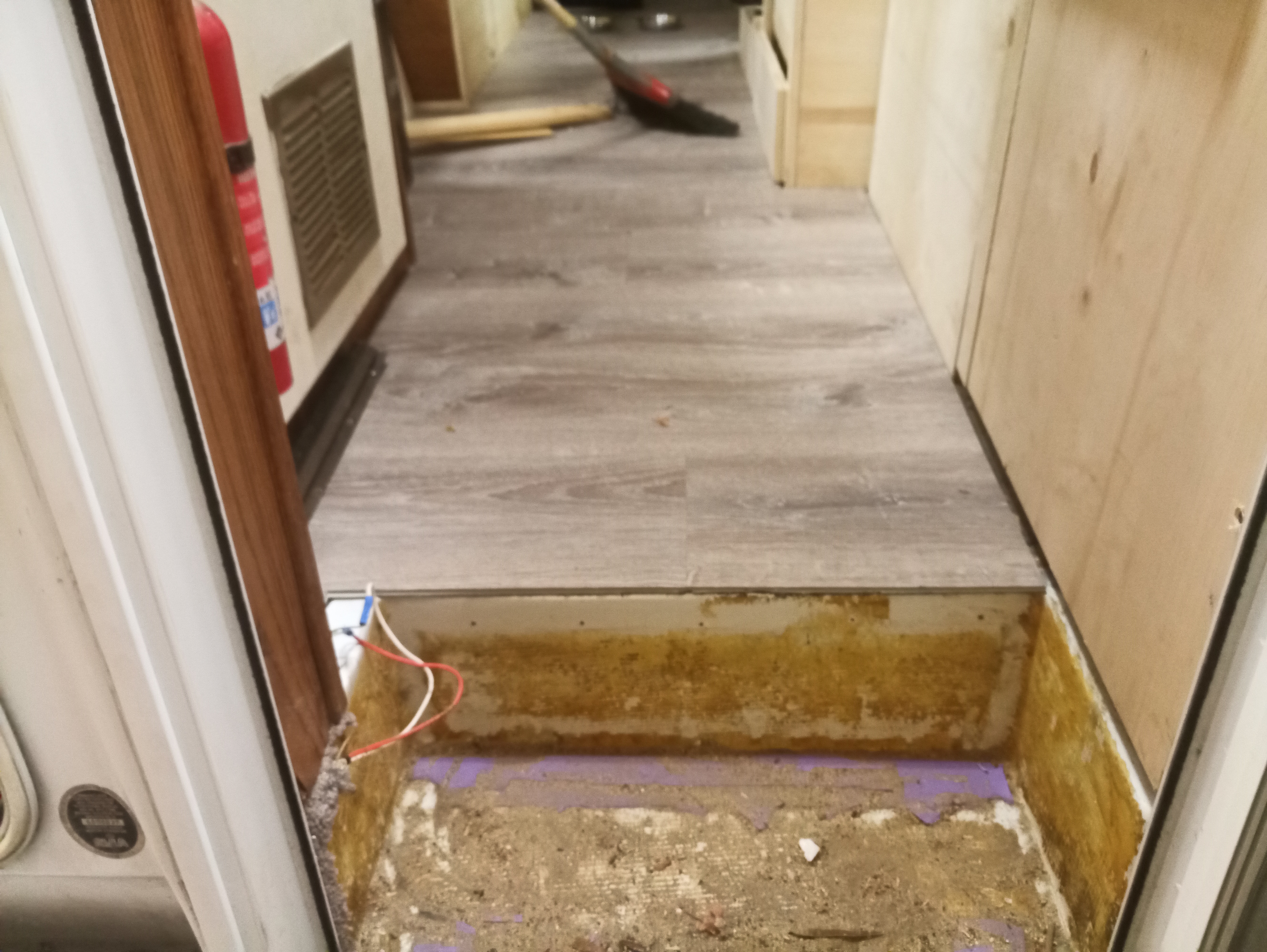

Nothing much to add today. I spent most of the day throwing the rest of my stuff in the dumpster. I did however get the rest of my LifeProof flooring laid. I still need to add threshold pieces and figure out what to do with the step area. I was going to glue down some more of the vinyl flooring but I had exactly enough to finish up to it. Took 2 boxes.
