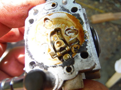

Pretty funny that we were having this exact conversation two years ago! "Varnish" is a term too gentle. I couldn't get this carb clean to save my life. Honda rototiller. I still miss it.
