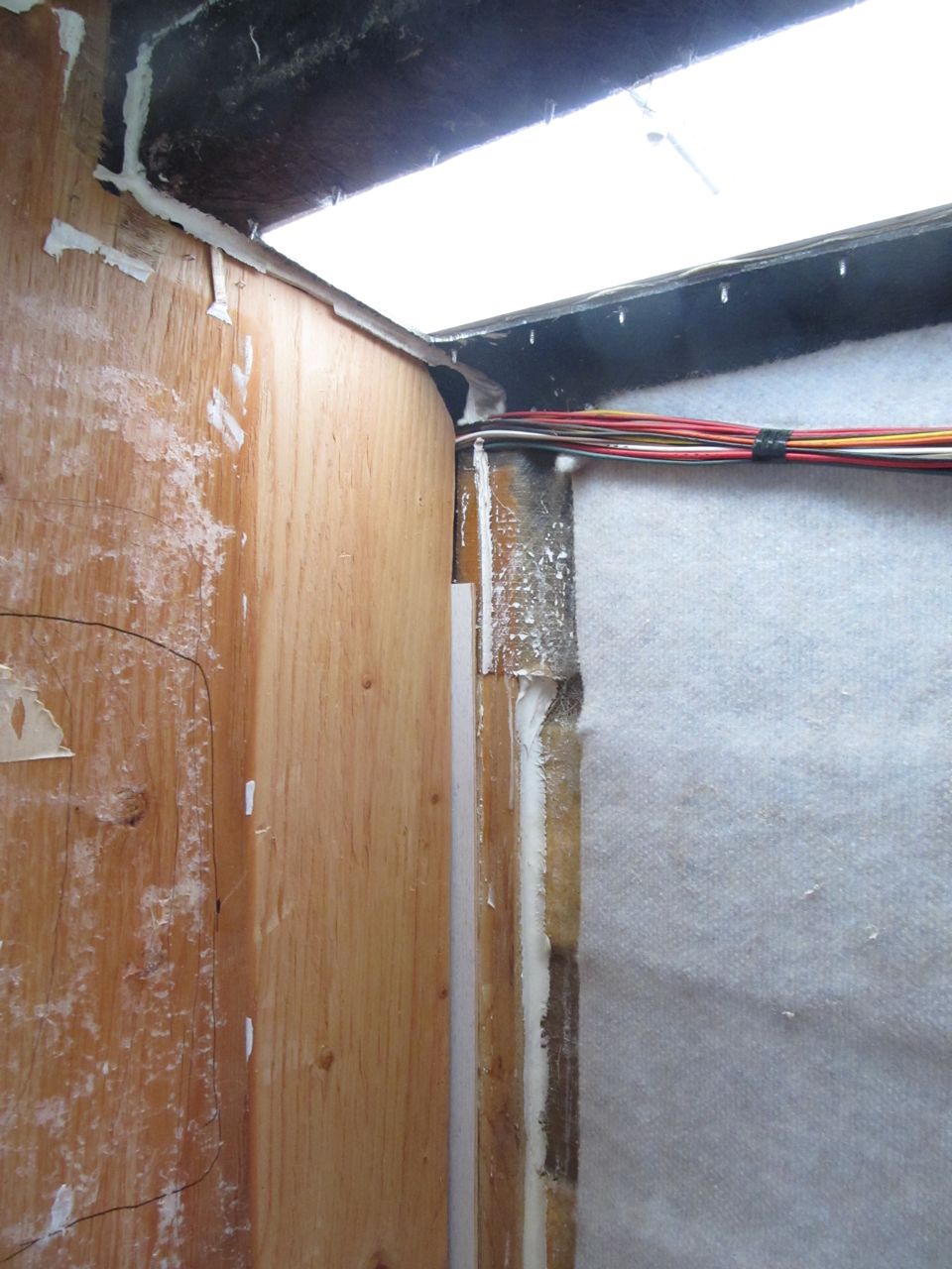

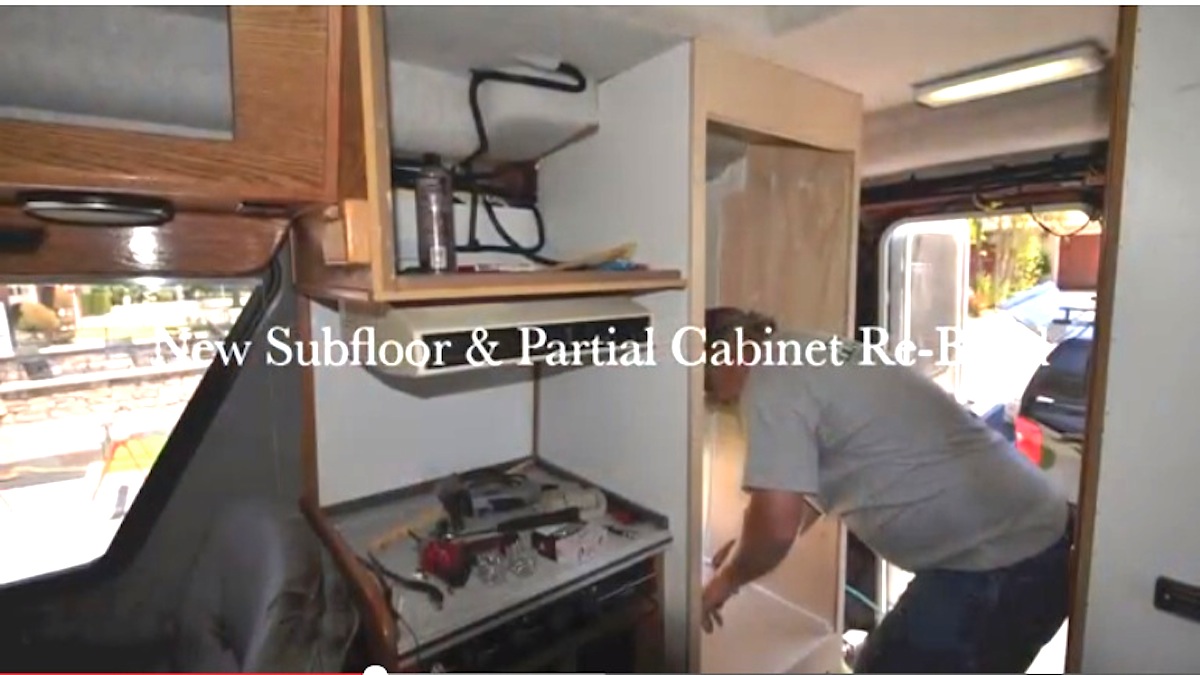

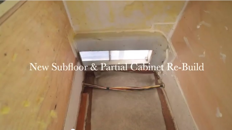

For now, here are a couple I had saved from someone else's job on a 2002. They're a bit difficult to make out, but for now...

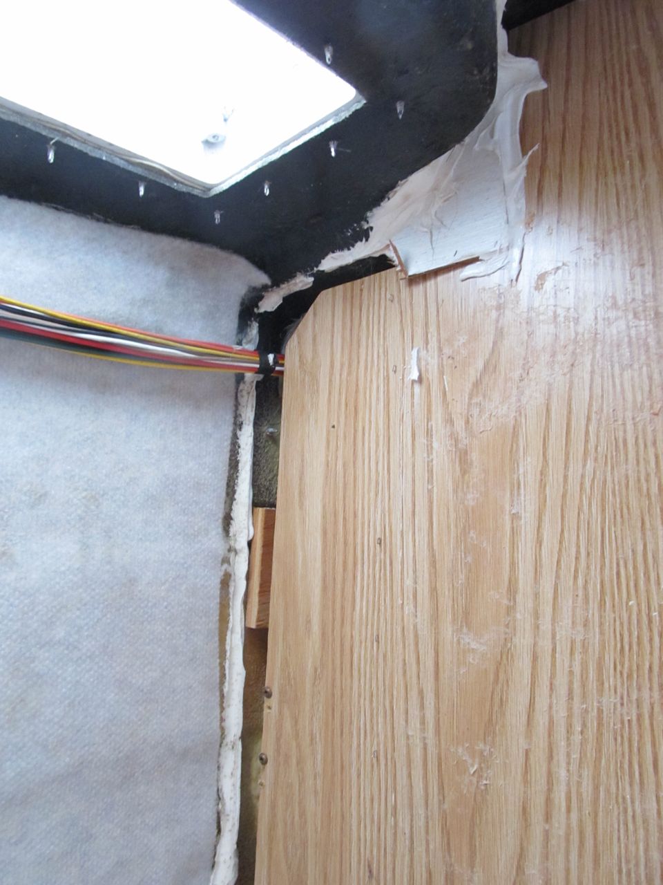

Looking up. The white sections you see toward the rear are thin material that is like the face of the vinyl walls around the stove. It looks like it was cut and placed in toward the wall to provide a place for them to lay in silicone to seal off the refrigerator compartment (required with a propane refrigerator). I have removed these (they are just stapled on) and after that you just have the 1/2" plywood wall that separates the fridge from the stove (5/8" with vinyl/wood stove side facing included), and the 1/2" MDF wall that separates the refrigerator compartment from the closet.
The wires you see are the same on mine, and it looks like they had begun to chafe on the refrigerator. Just marks in the insulation at this point, but I'll be glad to get them in some loom and better secured.
Overview: Again, the above photos are not mine - I'll get some though.

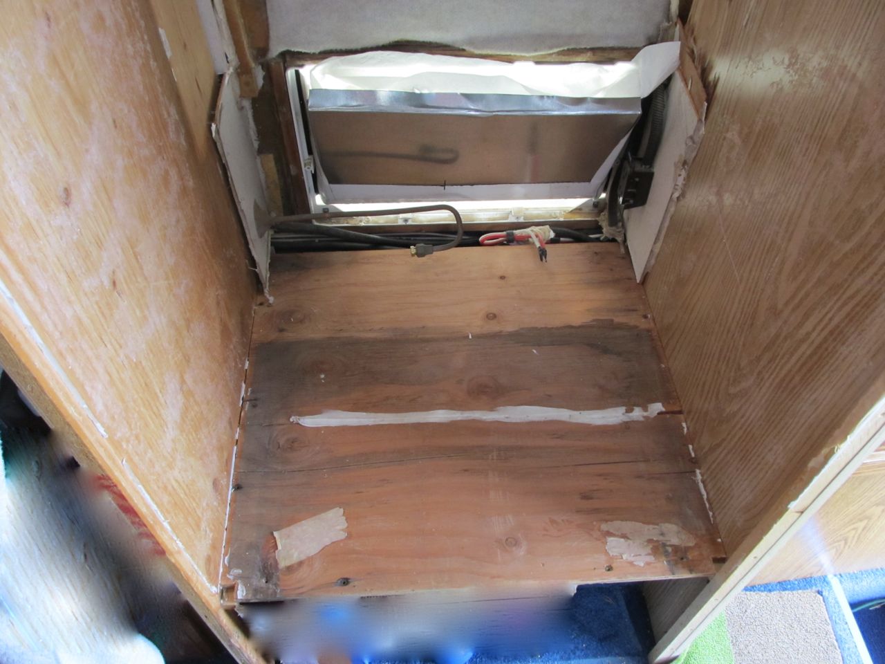

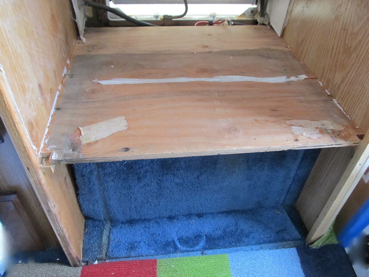

Here are some photos taken during demo/mockup phase (I can only post three per post, so will make multiple "replies").HoosierB wrote:I would be very interested in pics of the closet/fridge wall with the fridge removed. Especially the frame work and attachment to the inner outside wall and ceiling. The PO of my rig hacked that whole panel up. Not much left of the original construction.
Thanks

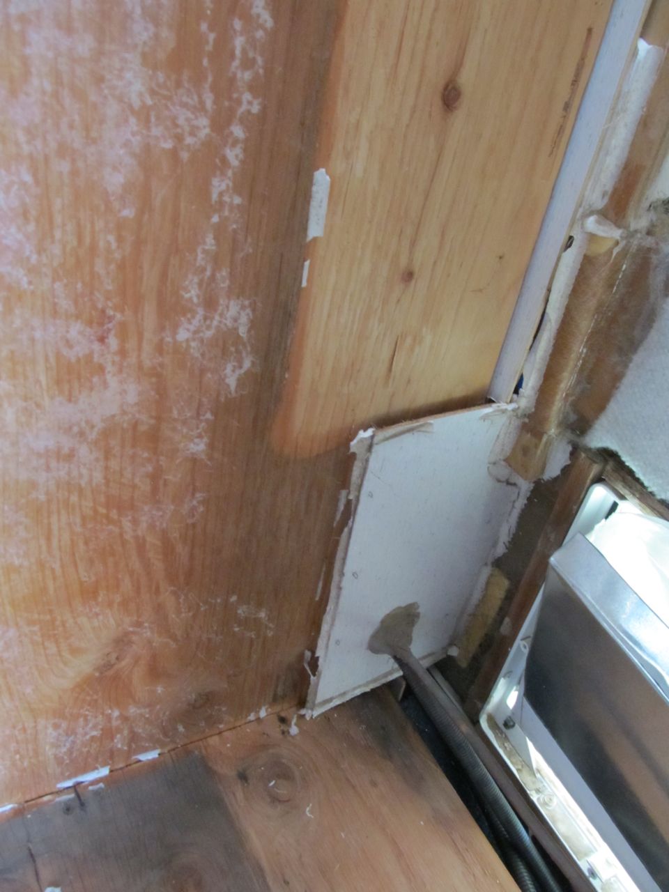

First, looking down toward the base of the refrigerator compartment, sans refrigerator: A closer view of the bottom area, minus the face frame and tip-out door that cover the generator box. Side note, on mine, all sides but one of the gen box are covered in carpet/padding - but the forward side is just the sheet metal box. I'm going to remove it all and use some Second Skin products that are designed for this sort of thing.
Next is looking lower left (actually forward in vehicle terms) of the box. You can see some of the thin vinyl-covered wallboard around the gas line. Most of it was out before I took these photos, but basically all around the refrigerator compartment where the side walls joined the outer wall they had used sections of this to close up any gaps and there was white caulk all around the edges. As I'm sure you know, the combustion part of an absorption refrigerator is supposed to be sealed from the living space. Also, of course there is free air/dust flow in the area between the upper and lower vents, so that needed to be sealed off as well. These panels were around 12" wide - you can sort of see the difference in plywood color where I have removed them. They were stapled/caulked in place.

One note is that the wall dividing the stove and refrigerator (as well as the opposing wall dividing the sink and shower) are 1/2" plywood, as opposed to the other walls which are MDF/Melamine. These two walls are somewhat "structural" in that they help hold the sidewalls in shape (otherwise they are a bit floppy, as fiberglass is). They are not tabbed in or in any way as structural as say, a bulkhead on a boat, but they do contribute. In my case the stove/refrigerator plywood wall was not actually screwed to the outer wall, but it was fastened to the ceiling, and then the stove was fastened to the wall, and then things were caulked and then that whole conglomeration worked together to stiffen things up. If you look at the Chinook wall drawings I matched up the wood strips in my walls (which were easy to see with everything out) and they do match up almost exactly to the drawings. From that you can tell which fasteners are really doing things and how to ensure any new construction is as good or better.
Another note is that while it didn't seem to negatively affect anything, the area where the forward side wall of the closet (between fridge and closet) and the outside of the rig meet... well, that "joinery" was a bit shakey. Again, nothing that actually caused anything negative, but definitely could be improved. They relied on those vinyl/wood caulked in sections to do some closet sealing there.

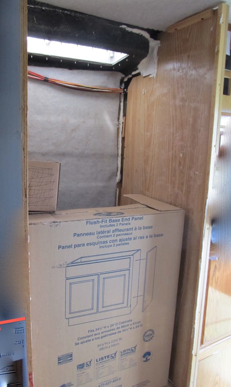

Now, on to mockups.
Basically, I have four options. The refrigerator that is my first choice is 4.7 cu. ft. with a separate compressor. The separate compressor is nice for a couple of reasons. For one thing, the bottom shelf of the refrigerator is a real, full-depth shelf instead of a wee fragile half-depth drawer (or on some other models the freezer gets smaller, depending on where they put a built-in compressor), and for another you can insulate the snot out of the refrigerator box as it needs zero ventilation. Then too, you can provide lots of air for the compressor (separately). That's the route I'm going regardless of fridge model.
So, four options:
1) The bigger refrigerator (of the two I'm considering) is 31" tall. If put on top of the generator box (old refrigerator position), that's like a bar height counter (around 43" tall). Then the stove stays in its usual place at a regular counter height (which will likely be around 34" as opposed to the Chinook stock 31-7/8" on the Concourse, which is pretty low - standard kitchen height is 36").
2) Put the bigger refrigerator in the "stove place" which would sit on top of the wheelwell. (Wheel well is about 6" tall, generator box is around 13" tall.) Then move the stove to where the refrigerator goes. This almost yields one long "normal" counter height, but not quite because it all ends up being around 38" tall.
3) Go with the smaller refrigerator (Hoosier I think it going with this one) and put it in the refrigerator spot. This ends up being similar to #2.
4) Go with the smaller refrigerator and do the switcheroo, as in #2. This ends up with a long/low counter as in #2, but can achieve a more normal counter height (34" or so).
I really don't want the smaller refrigerator (it's quite a bit smaller, around 2.6 cu. ft as opposed to the larger one at 4.7 cu. ft), and I also didn't really like the switcheroo of stove/fridge spots. Which way to have the fridge open was one reason, and the other was that I was looking forward to having a "staging counter" that was optionally part of the kitchen but not "really" part of the kitchen. I go out hiking or other places and like a spot (besides the floor or couch) to set things I want to take with me, or am bringing in. I can also use it as a kitchen set down space, but it doesn't "always have to be" kitchen. This fits with option #1 and the bigger fridge with the higher "bar height" counter. So I'm pretty sure I'm going with option #1, although I can see the other options being good too, just depending on personal taste/usage patterns.
Here is a mockup of the "bigger" fridge in the refrigerator position, where it would have a bar height countertop (option #1). The red line on the left is the stove counter top line, more or less:
Note the un-loomed wires up near the top of the compartment. These had some "marks" in the insulation that I think were caused by the back of the refrigerator. No actual rub-throughs to bare wire, but I'm glad that I can now protect them better.
