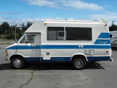

Hey Blue, I ran across a modified '79 Chinook stove side picture I thought you might like:
Obviously no generator blocking the fridge in this case.

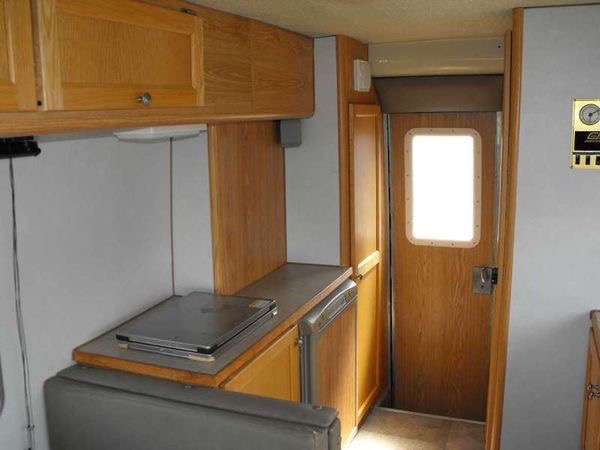

That's slick. Really nice craftsmanship, indeed.
If there's one Chinook owner in this world who needs a compressor refrigerator, it's this guy.

That is a nice re-do. I had saved photos of it a while back (it's a 1979 Chinook on a Dodge chassis). But fun to see it again and get the group's comments.
Scott: I see you noticed the big "chimney" behind the refrigerator
You'd almost think it was a spice/coffee cabinet if you didn't know.

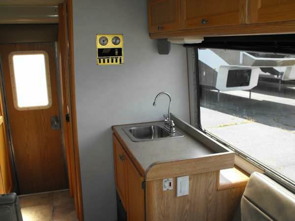

The sink side is also interesting, with a big indent to accomodate both the window and a higher sink counter. Actually, I'm doing something similar in my Chinook, but it'll be much less noticeable. By running the counter top just under the bottom edge of the window trim ring (so it can go right out to the window wall unlike this one). (Now the counter is lower and the backsplash goes up to the trim ring level), I can get a 34" high counter. That's quite a bit better than the stock which is something like 31-1/2 only! (In the Concourse, due to the big window.) I'll make the backsplash, which will be in front of the trim ring, removable in that section in case I/someone need to remove the window/trim ring.

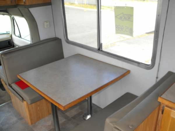

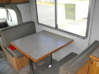

Has a sort of 3/4 size dinette: Lineage is apparent, although most I've seen in that era have slightly raked windows (not straight, but not as raked as my era). I really like the ones that open from both ends. I guess they might have stopped doing that because, if I remember correctly, you aren't supposed have opening windows right above water heater/furnace exhausts.
