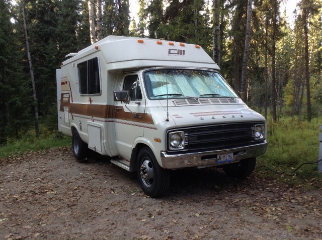

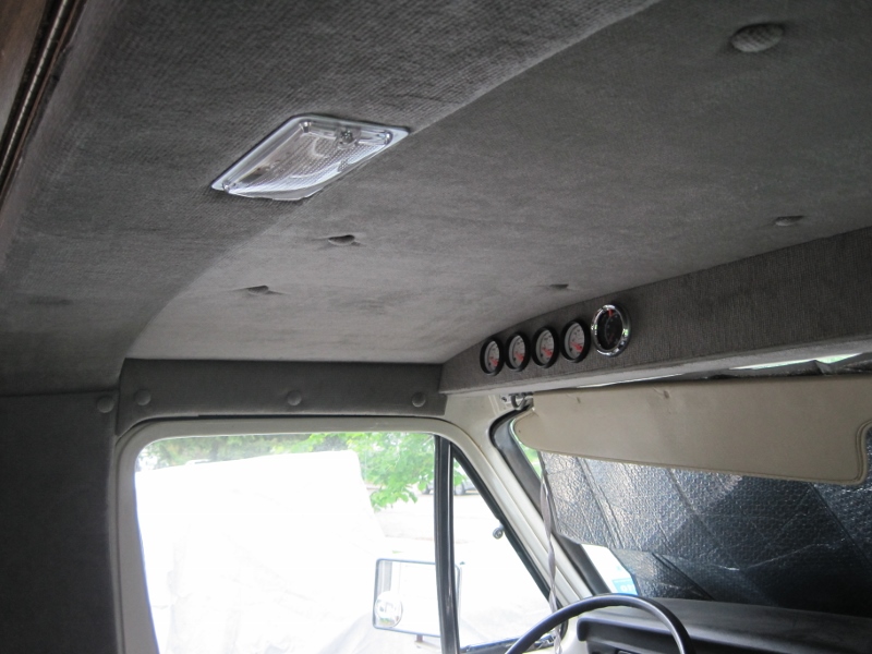

Just found this forum and registered, thought I'd try to add a couple of pics of my 77 "work in progress".
I'm hoping I'm almost done with the mechanical and can start on cosmetics. 1977 with a 360 4 bbl, A518 overdrive automatic and 4.10 gears. I've done the brakes, brake hoses, wheel bearings, front suspension, shocks, all rubber hoses (fuel and coolant), and upgraded to 16" tires and wheels. I've also replaced the water pump, fuel pump, radiator, u-joints and what seems like several hundred other small parts.
Inside I've replaced the stove/oven, toilet, most water lines, upgraded much of the wiring and replaced most of the green shag carpet with laminate flooring.
The front cab has been updated with an overhead console with gauges, new upholstery and PT Cruiser leather seats (which bolted directly to the original seat bases!).
Outside I've replaced the rear door and upgraded all the lights to LED.
Future plans include updating the interior and making the exterior look a little better.

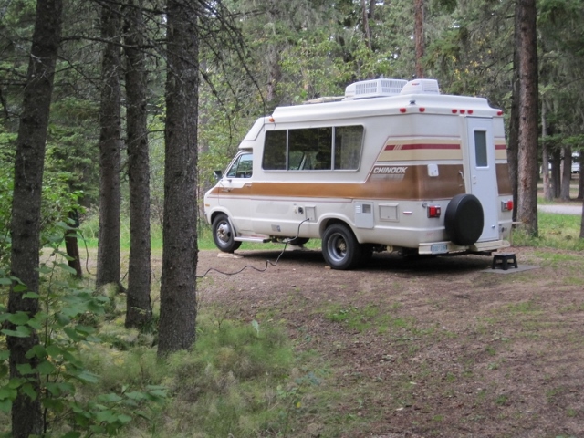

Hi Dave , nice to see another old dodge on here.
I,m curious what,s that compartment on the lower front passenger side of the coach body ? I never seen that before .
I,m also curious where you got your new rear door ? and what kind of gas mileage you get with the 518?

Re: Early generation Chinooks on Dodge chassis'
The original owners manual says the compartment on the passenger side is where the factory installed a generator. It's where I store my BBQ, wood leveling blocks & other odds and ends now although I do have a Honda EI2000 portable generator that will just fit in if needed.
The rear door was ordered from a local RV dealer and was a simple "bolt in". Not sure of the manufacturer's name but its a 24x72 with part number 60197. Looked at fixing the old door but it was rotted so bad there wasn't much to work with. The new door is foam filled so lighter and no wood to rot out again.
