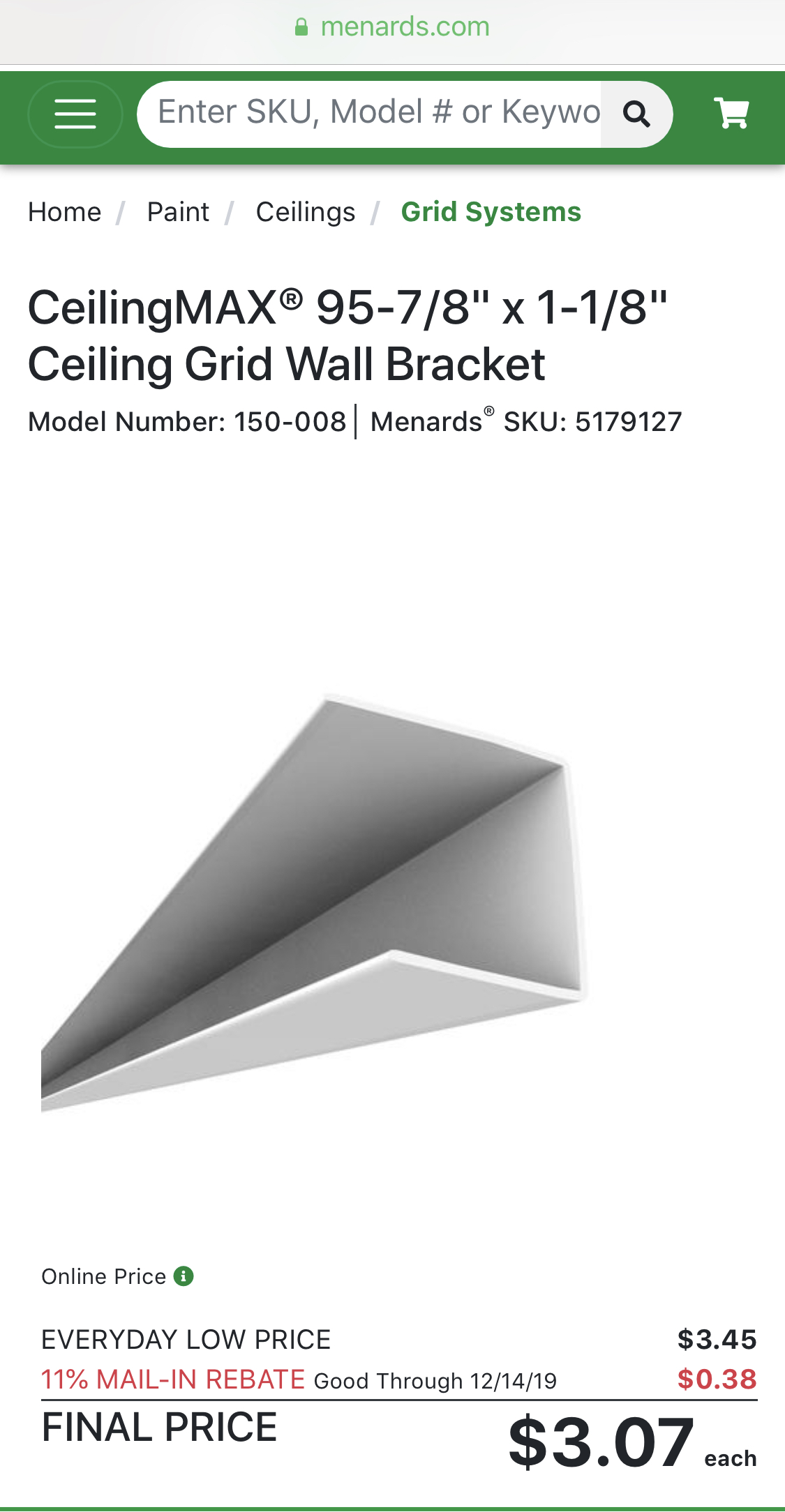

Incase anyone is looking for new white plastic C molding for the wall to the bathroom here is a link to the stuff I’m going to use.
Took me forever to find the right molding again as the old link I had didn’t work anymore.
https://www.menards.com/main/paint/ceil ... 101969.htm

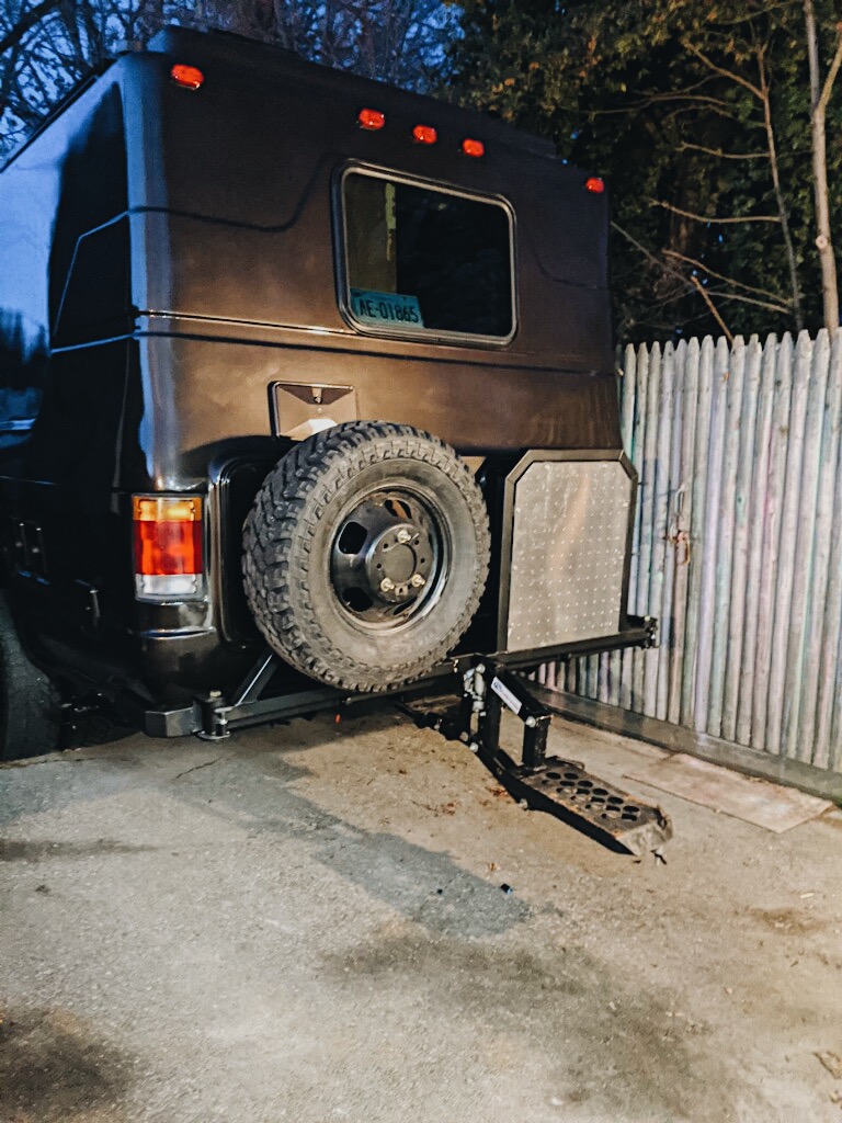

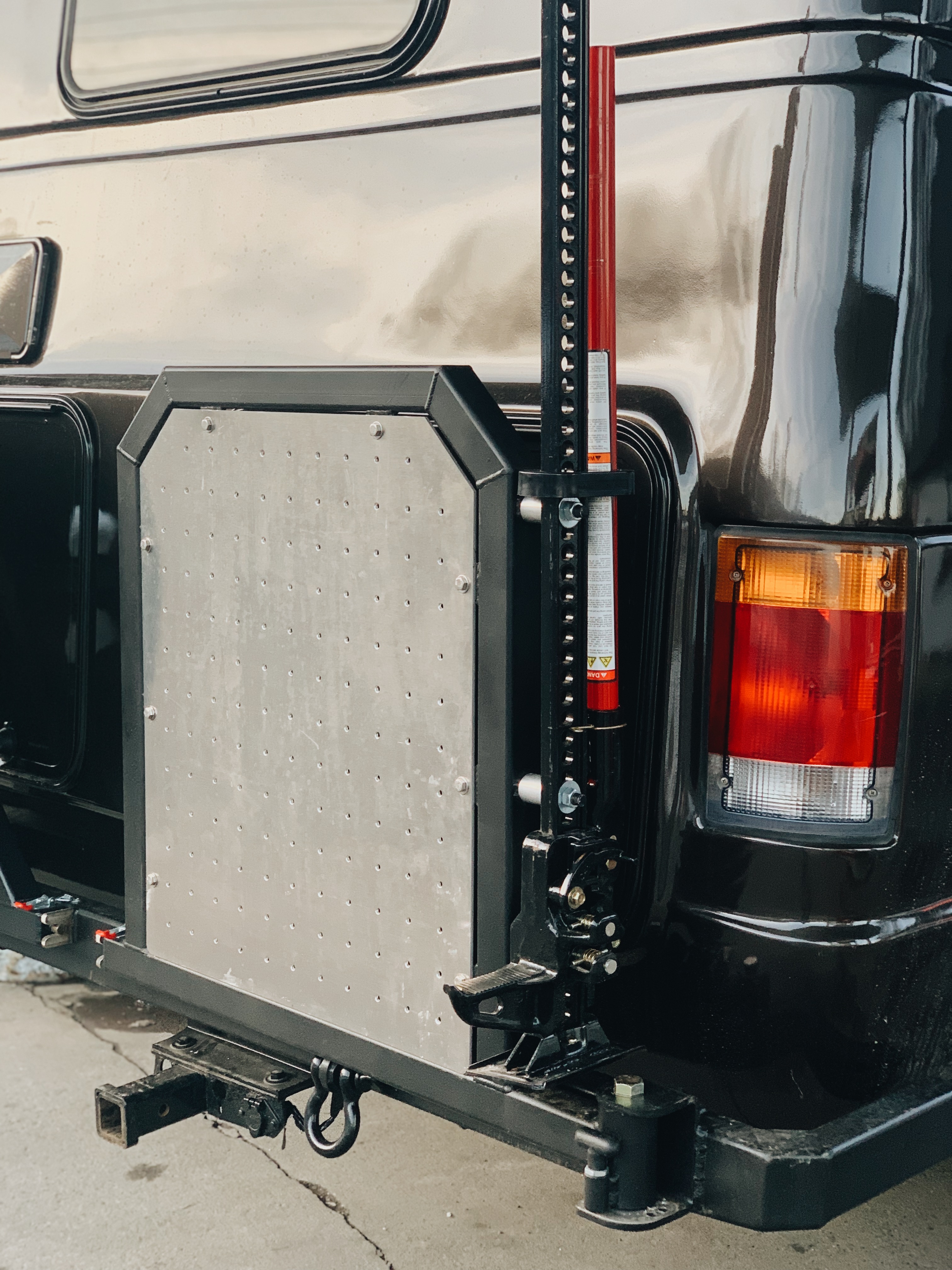

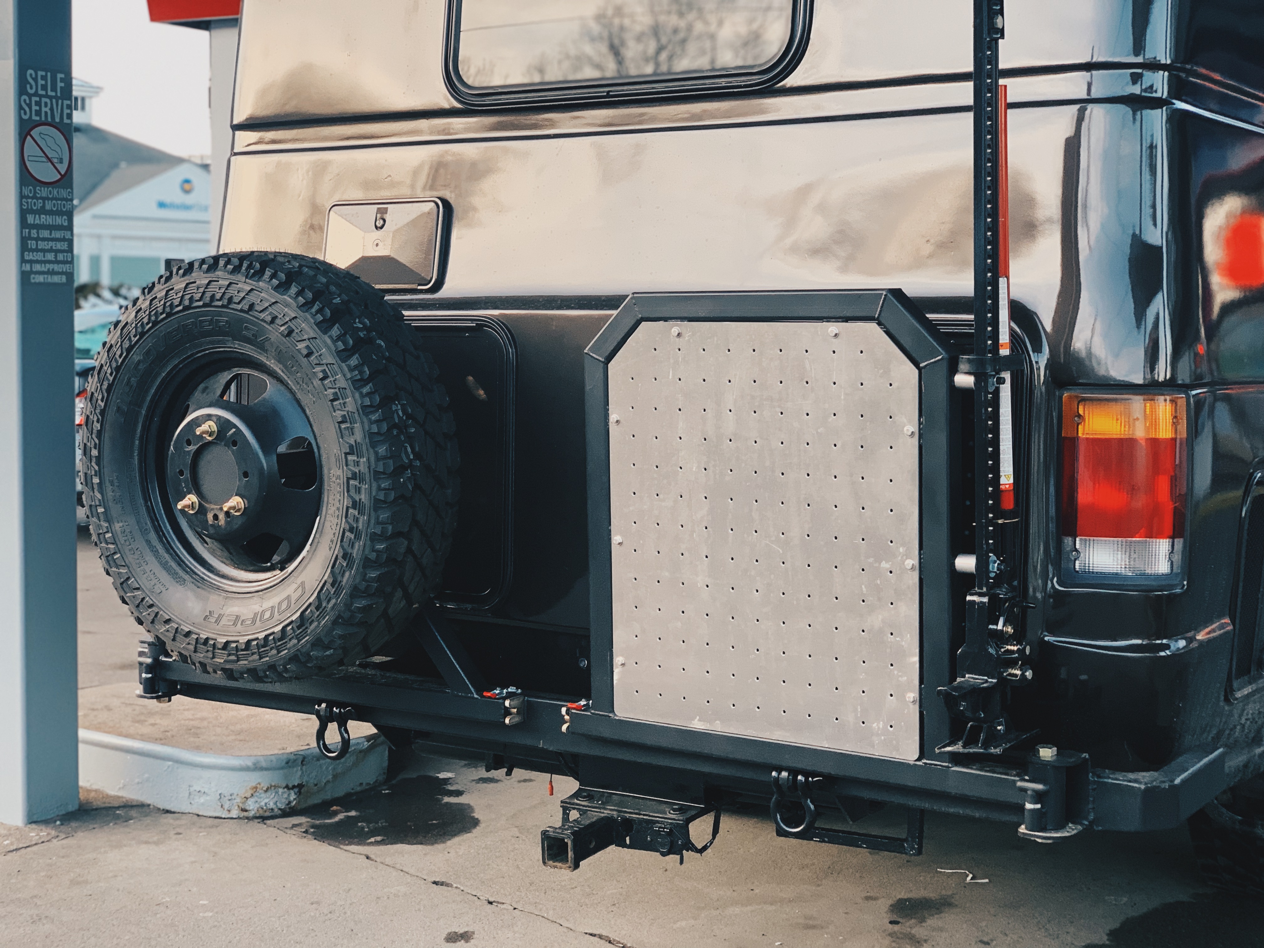

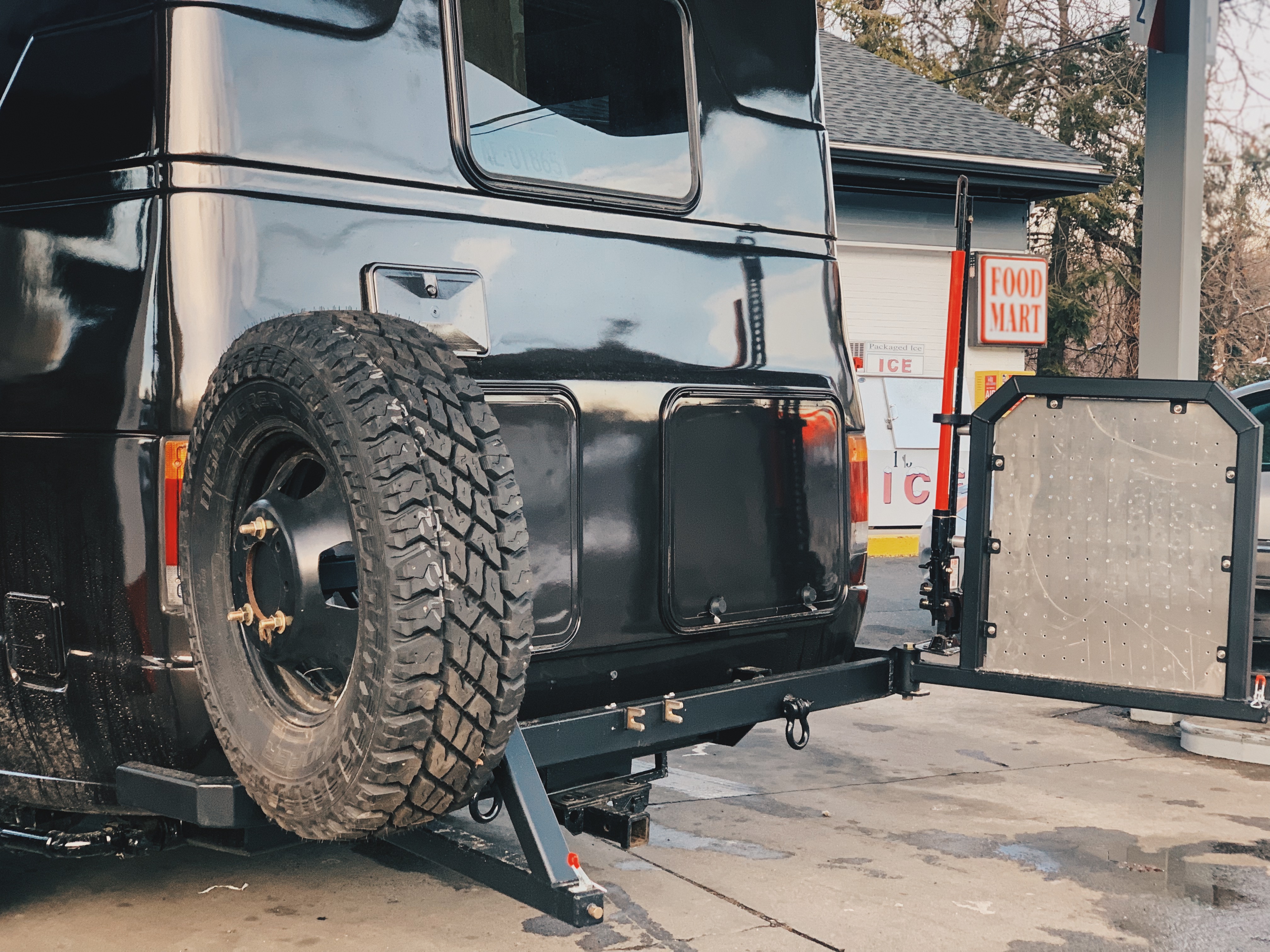

What's the diamond plate on the right side of your bumper?
Also, do you bring spare gas? If so, what's your strategy?

I bought this to repair my shower door molding and found it to be a little too large to make a snug fit. It was OK for my threshold because the MDF had swelled, not good on the sides, so I didn't replace the original trim.Willywalderbeast wrote: December 11th, 2019, 8:14 am Incase anyone is looking for new white plastic C molding for the wall to the bathroom here is a link to the stuff I’m going to use.
Here is a part that I think has the same dimensions as the original trim and might fit better. It's a little pricey but comes in 72" and shorter lengths in 2-packs:
https://www.amazon.com/gp/product/B07MJ ... PN78&psc=1
If you want to find similar options do a Google search on "plastic 1 inch U channel, and the world will open up.
Update: You can order this directly from the factory for less. Comes in 12 foot sections, so 24 feet (2 pieces) needed comes to about $30 including shipping:
https://www.outwater.com/products/100-wh/

I’m planing on gluing it, no screws.Scott wrote: December 11th, 2019, 10:47 am That's helpful. Thank you for the link.
You gonna screw it or glue it?
The original trim in my rig is screwed on (not stainless steel screws), and in a shower that always seemed a bit odd to me.Hey, at least they used plywood in that area instead of MDF ...

It’s actually a piece of 6061 aluminum with a ton of holes drilled in it to acct for mounting pretty much anything I want. Going to mount my maxtrax recovery boards, rotopax gas containers, and possibly a storage box for tools.

Ah bummer. We’ll see how it fits. If not I’ll have to try out your suggestions. Thanks!caconcourse wrote: December 11th, 2019, 11:50 amI bought this to repair my shower door molding and found it to be a little too large to make a snug fit. It was OK for my threshold because the MDF had swelled, not good on the sides, so I didn't replace the original trim.Willywalderbeast wrote: December 11th, 2019, 8:14 am Incase anyone is looking for new white plastic C molding for the wall to the bathroom here is a link to the stuff I’m going to use.
