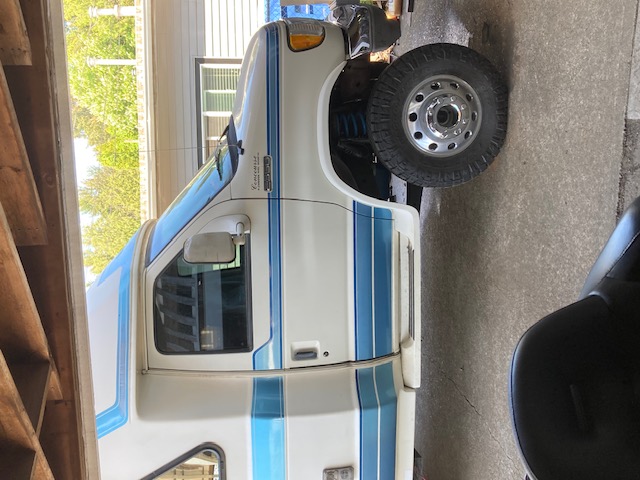

she came to life yesterday, i need to bleed some brakes and can move under her own power, dash is all working for the most part, need to track down getting rid of some lights. i need to wire the chinook portion now. that is not very much

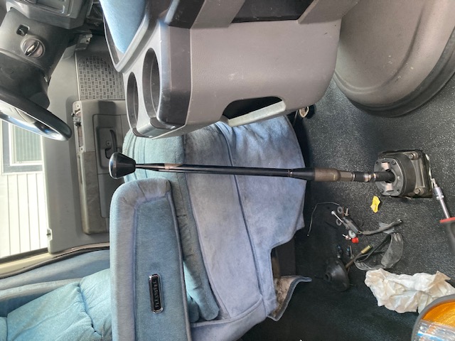

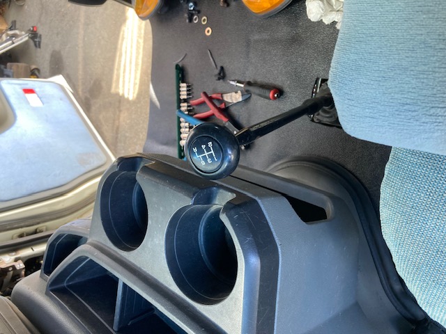

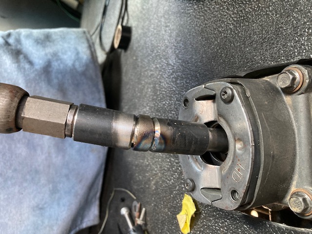

i have the shift modified so it is in the correct location, shifter is in first gear in the first picture

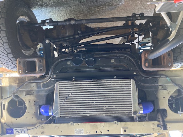

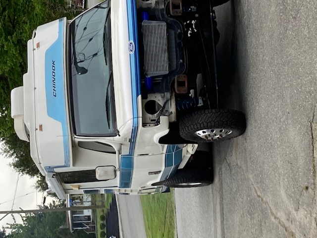

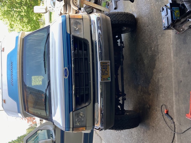

got the front end on and just need to hook up the tail lights, i will have the rear springs re-arched to match the front height monday. one picture of the intercooler mount, it was a task to get the hood release to work with the intercooler and grill but finally got it to work

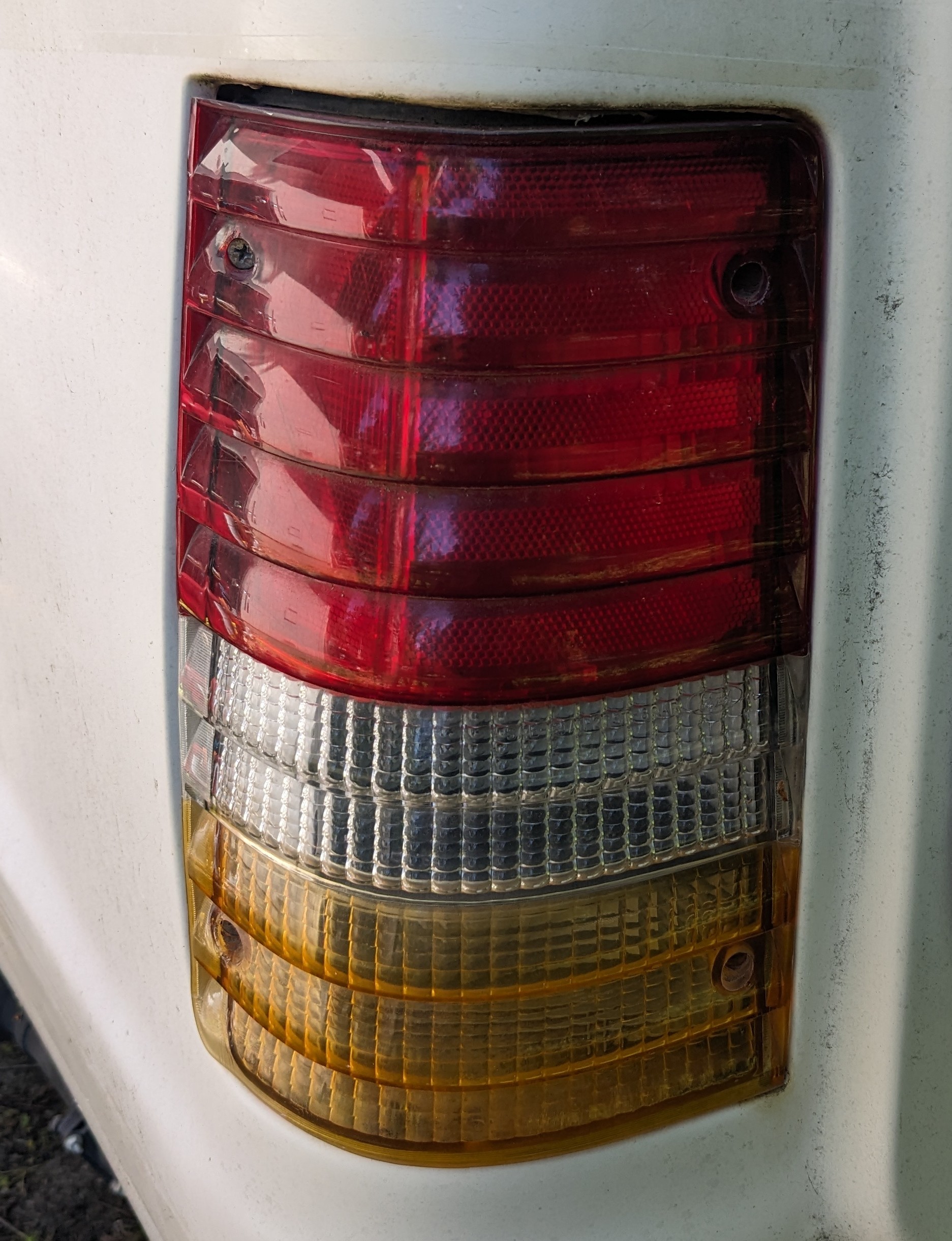

hey Scott can you tell me the taillight configuration is the top signal in the amber, middle clearance and brake in the red, bottom reverse?
Amber AND red flash when turn signal or hazards are on. Red is running light, and goes bright for brake. White is reverse. Is that what you mean? They're wired like trailer lights. So if the brake pedal is pushed and the turn signal is on, the whole thing flashes. A bit dumb. Here is my lens. It's from an Aerostar.
