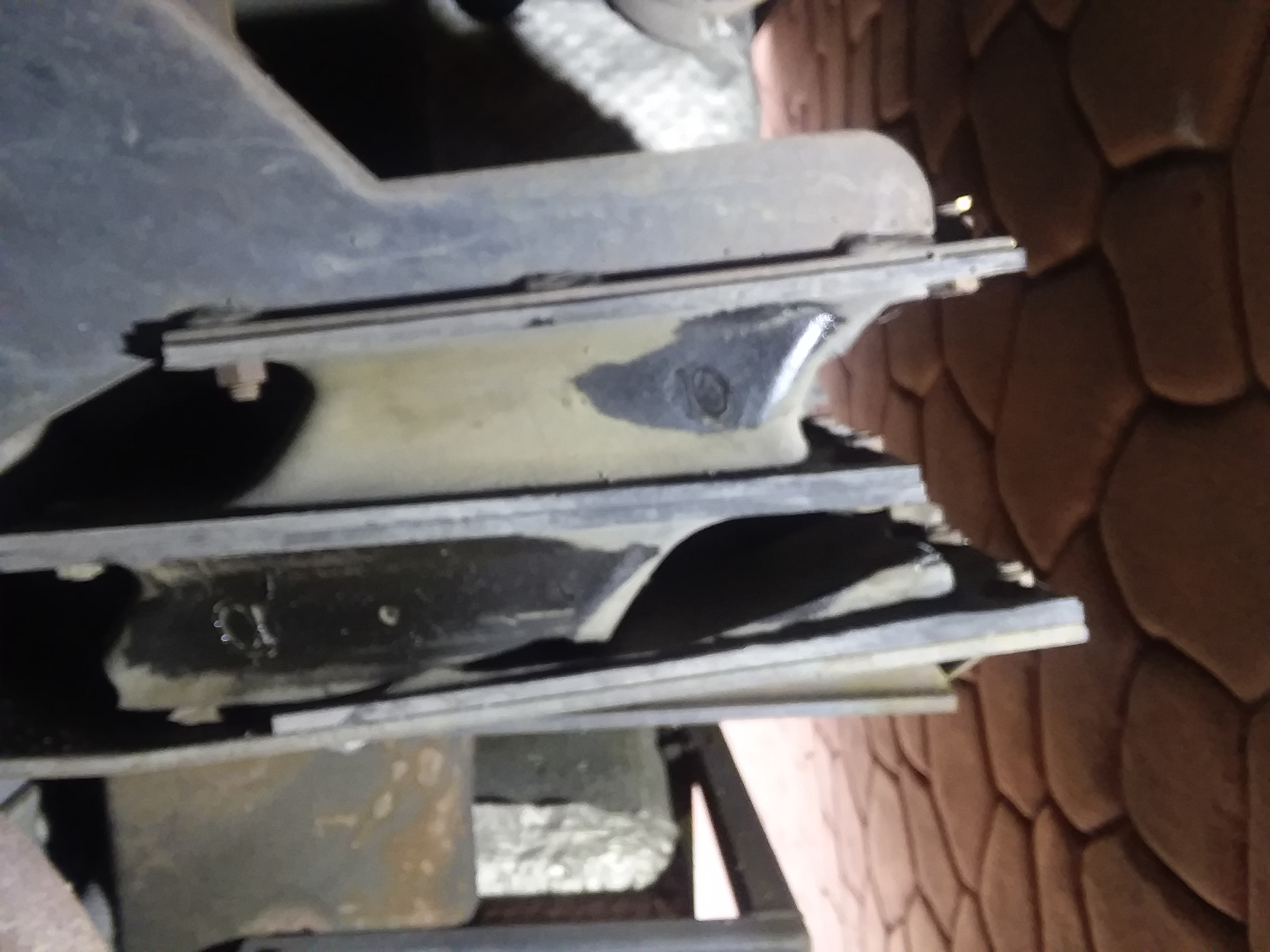

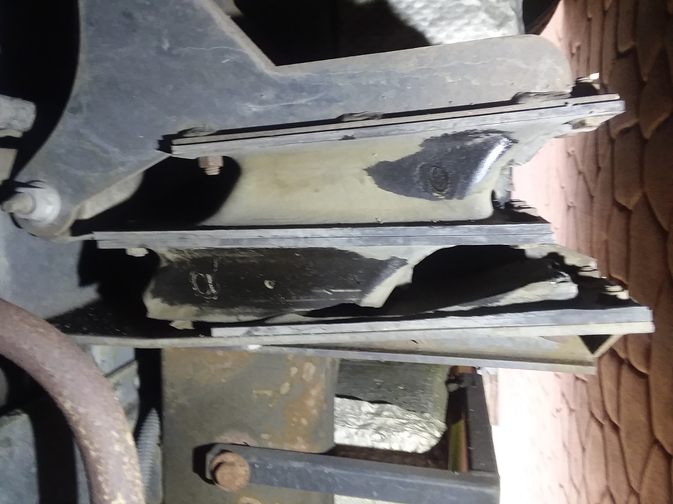

I took a closer look tonight. The existing spring is MO-25-10 with "10" molded on the side, like I said. It is not DSR-108-100 with a missing zero. I think I confused the MorRyde rep by not telling her that it is actually two pieces bolted together.
So the spring rate is 1000#/inch for the MO-25-10. The corresponding one with the same spring rate is DSR-108-100. If I want to get the MO version that corresponds to the DSR-108-75, then it should be MO-25-008. The GAWRR is 7500# if I read the label on the door correctly. I am going to call them again tomorrow and see if they have consistent recommendation to go with the MO like what I have on it right now.
Re: Mor Ryde need repair
This is the MO-25-10. You can see it is completely tore.
