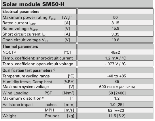

Yes, it's 33 cells. One reason it's narrow: Only 3 wide (by 11 long). Here are the specs for the SM50-H, which is ~13" x 48":

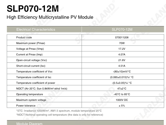

Just for comparison, here are the specs for a sort-of-modern 70 watt skinny panel, the Solarland SLP-070 (formerly -065). This is ~13.5" x 58".

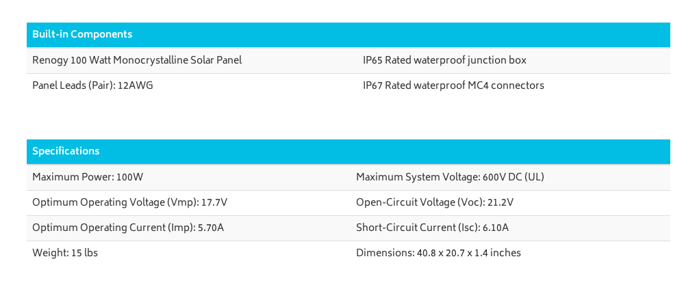

And for a 100 watt Renogy Eclipse panel (they can be a 32-cell panel vs. a typical 36-cell 100-watter because the cells are more efficient). This is ~20-3/4" x 40-3/4" - very efficient for its size.
You can see the Vmp is quite a bit higher on the Eclipse, and nearly as high on the Solarland. This is not as critical if you have a pair in series; but for a single panel or a bunch in parallel, 15.9 volts is kinda low. (But again, 1998 was a loooong time ago, and I'm sure the Siemens panel cost a pretty penny!)
