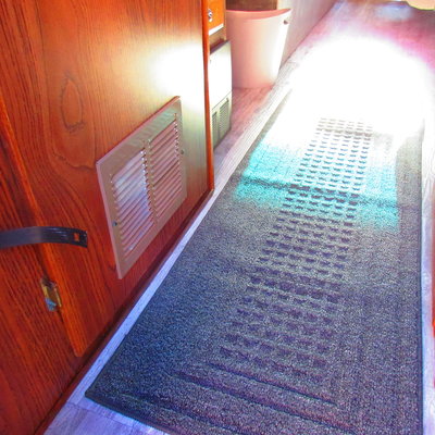

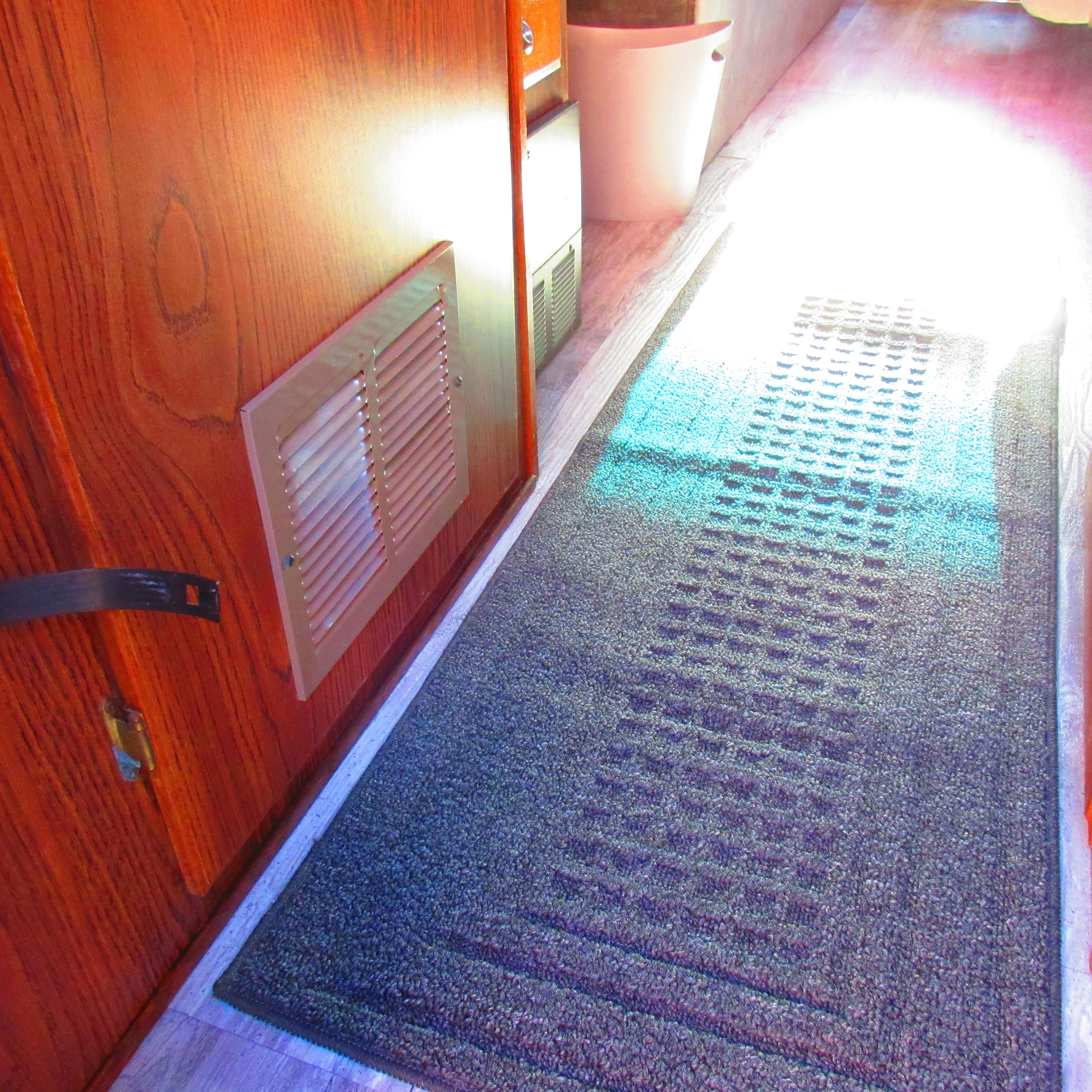

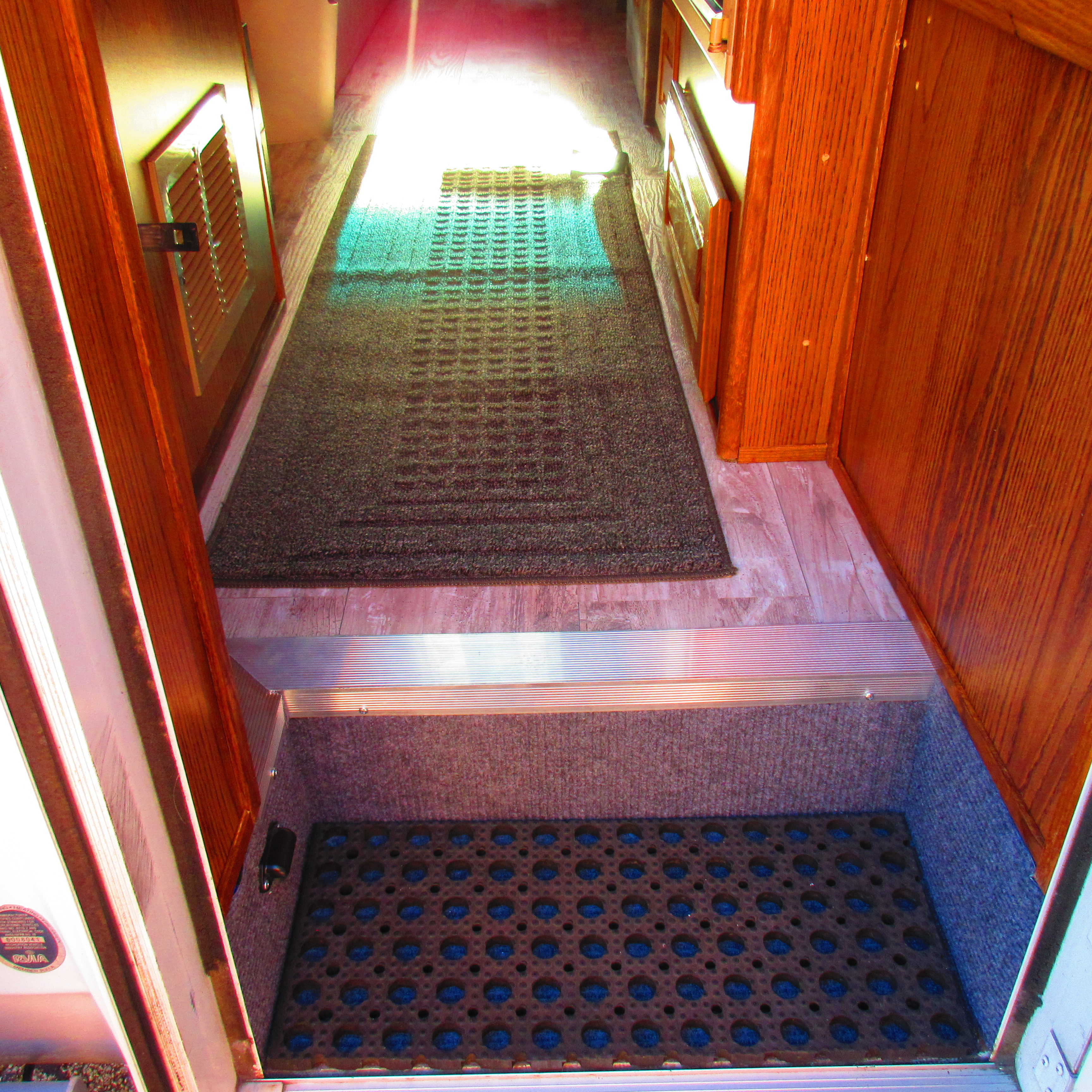

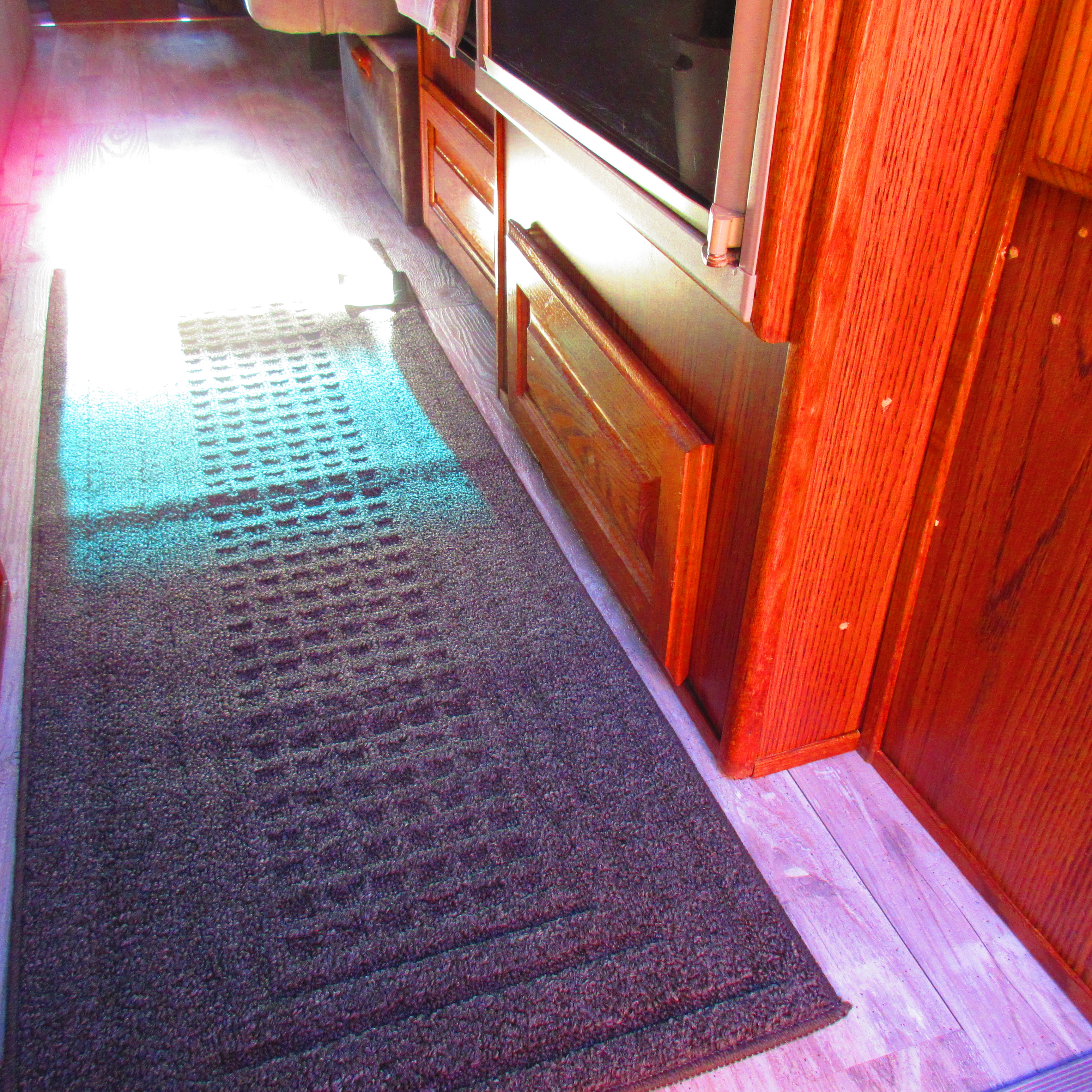

When we decided to pull the carpet out, we did not realize that it was under everything! The manufacturer obviously laid the carpet throughout (except in the bathroom) before mounting any of the furniture and woodwork. Thankfully, it was not glued down, so we began by cutting along the edges of the couch, etc. and ripping out small sections at a time. The process took about 4-5 hours. The pad was stapled to the plywood subfloor, but the staples were easy to remove with a flat head screwdriver. Be sure to have a shopvac handy, and I'd suggest wearing a mask because the pad is full of sand. Obviously the most thorough and professional way to remove the carpet is to remove the furniture, etc. first but for a DIY, I didn't want to take on the scope of that project! We ordered vinyl flooring with a matching quarter round to hide any unsightly edges.
We posted some pics of the floor after we pulled the carpet, and we will post our progress hopefully next week.

I'm definitely going to put the wood floor carpet replacement in my project queue. And like this thread references, I've been curious about the removal of the furniture. I guess it doesn't seem necessary, although I think I would rather have it clean going under the furniture than molding. Maybe just have it go under a bit, so that you don't have to pull it from under the tank, heater, etc? Would that work? For those who have just cut it out, how do you ensure proper fitment of the access door under the couch? It seems that the wood would be thicker than the carpet, and not align with the fasteners any more. And I guess there's no molding there, either, correct?
Does anyone have a photo of the transition from wood to carpet as you enter the driver area?
