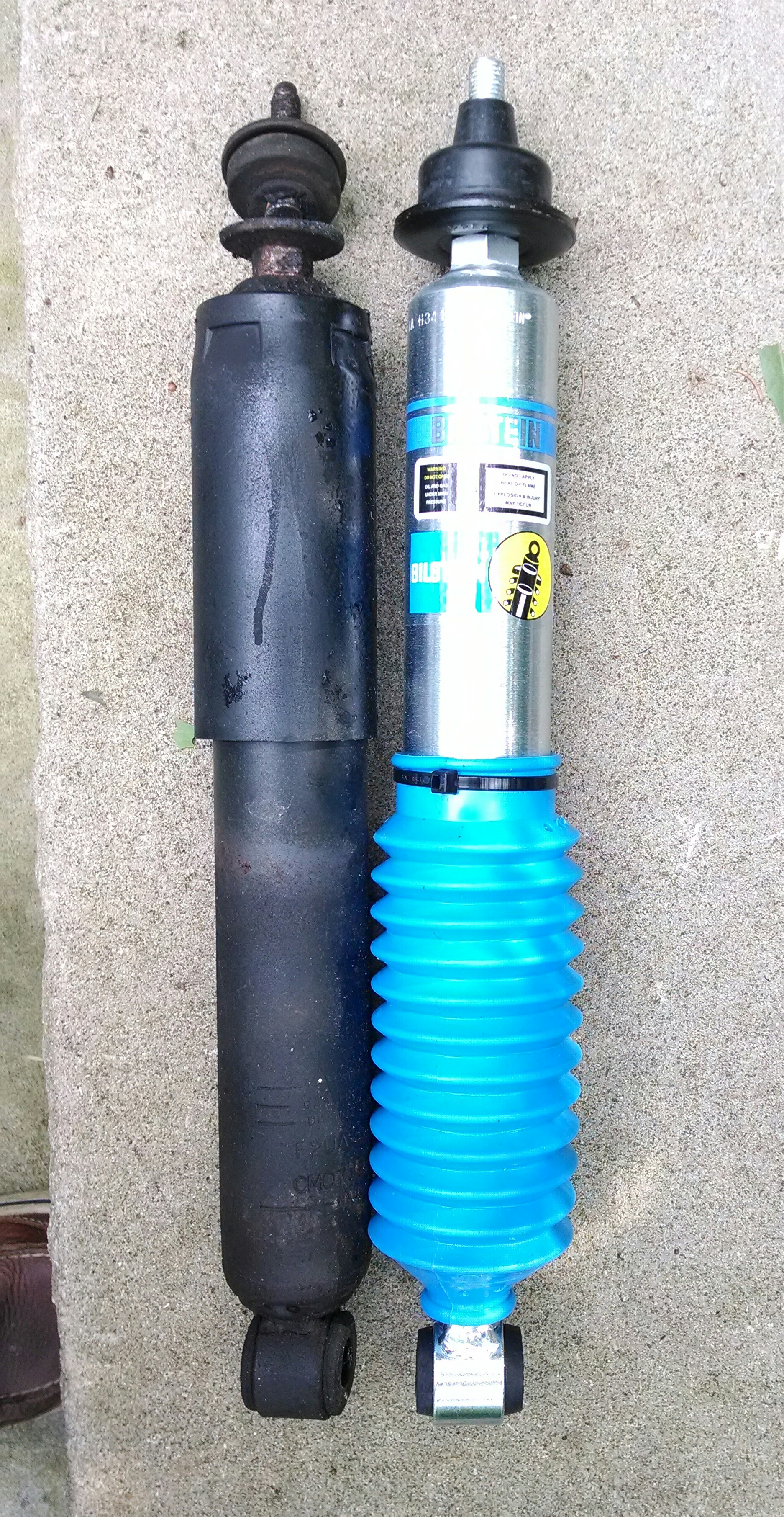

Below: On left, an old front shock with its top cut off. New Bilstein on right.
I tried compressing the old shocks and man did they sound "crunchy" instead of smooth. Not even full travel, either.
They probably haven't really worked in years, same as with the stock Ford steering damper shock before I replaced it.
