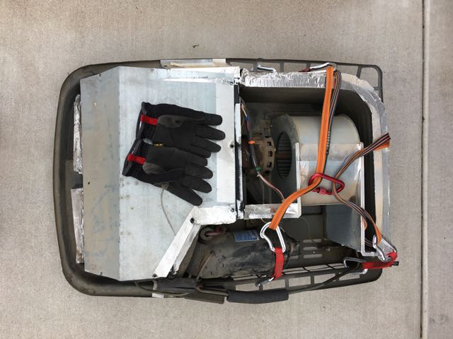

Once the interior shroud is off, you can unfasten the unit from the roof. There are no holes for fasteners, but rather it's a clamp type system. I think there were three long bolts. Two forward and one aft. Then you unscrew the little "air box" square.
I can't recall if there was any DC power to the air-con unit, but don't be fooled by a bunch of DC wires that (may) run through the opening on the driver's side. On my rig this was a set of wires that came in through the roof cavity from the wall over the couch, then split off forward and aft (for the original fan and the two ceiling lights in the vicinity. I did have to add some wire to those because as-built they ran through the hole and I of course didn't want wires going through my skylight/vent. I crimped on extensions so I could run them around the perimeter instead.

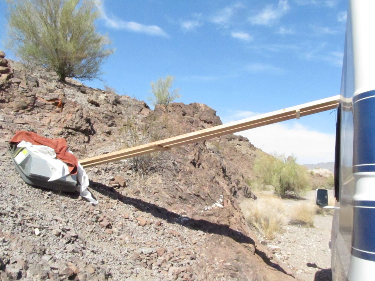

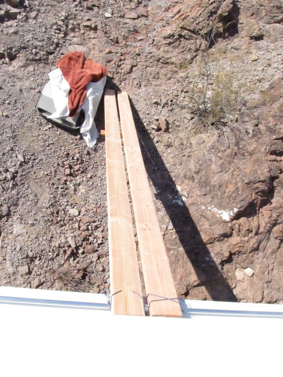

Then it's just heave-ho. I was by myself so I got a couple of 12' 2 x 6 boards and made two holes in each one near one end. Then I lashed them to the roof perimeter rail side by side. I also parked near a hill so the slope of the boards to the ground was more gradual. I pulled the unit out onto a towel, then slid it over to the boards, and then down them (I had it tethered just in case). Buh-bye! It went down in a slow and controlled fashion though, thanks to friction/tethers.

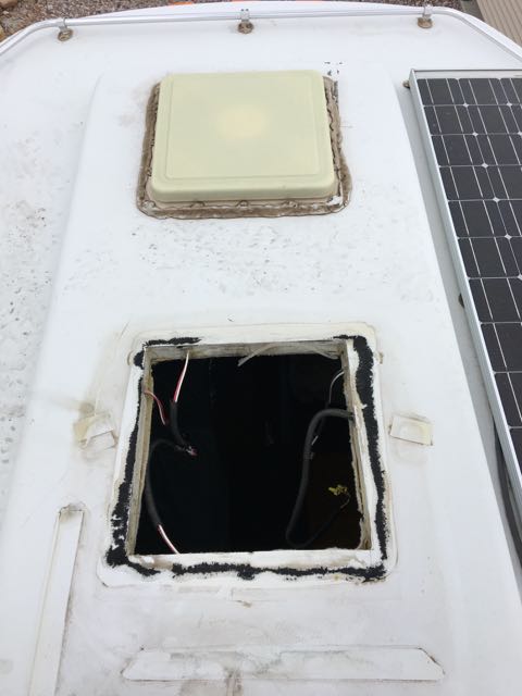

Once the air-con is gone, you will be able to see exactly how thick the roof is, and how it's made. Mine has a fiberglass top skin, a nidacore core (looks like vertical plastic tubes), then an inner fiberglass skin.
The original vent screws basically grab by just going through the top skin. And that's basically workable. I don't like the idea of water potentially getting into the core (can be bad news even when the core is not wood), so when I re-do something like this (or do it anew), I overdrill the holes (larger diameter), fill with thickened epoxy, and then re-drill into that new "column." But if you don't do that it will probably be fine. One thing is that boats commonly last 50-100 years, so there is incentive not to "kill" them prematurely with deck rot. A Class C is never going to last that long, so it's more of an optional step, IMO. Also, the bedding compound usually provides some grip. That said, there is a fair amount of stress on the thing, especially if you add vent hoods.
