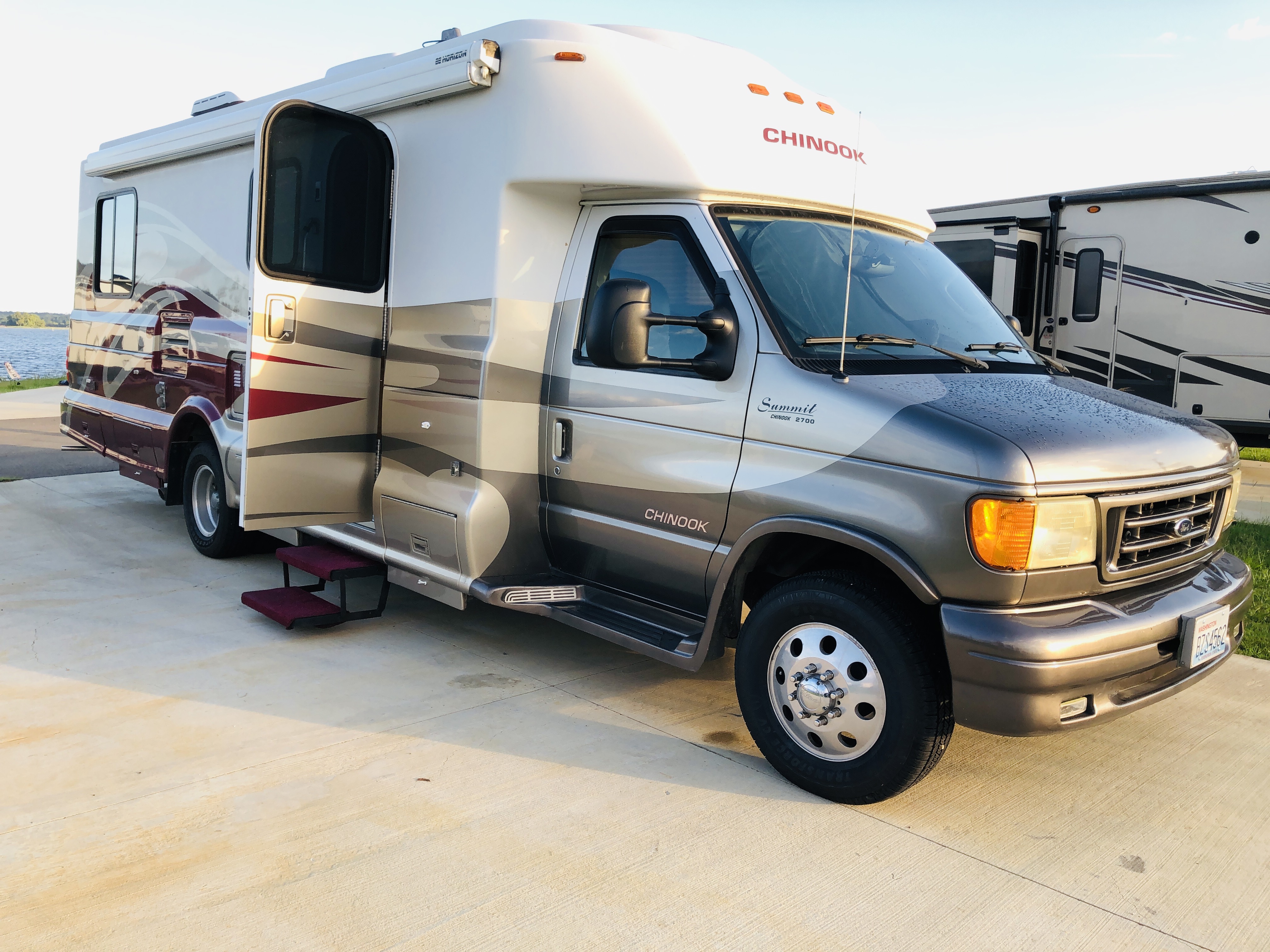

I know this is an older thread but I just wanted to share my experience so far with my new-to-me 2004 Chinook Summit 2700 with 30K miles.
I flew to MS to pick it up and drove it up to HWH in Iowa for an inspection. They fixed the slide's control box that apparently had a 'burnt relay'. Keep in mind the slides worked fine for me the two nights I camped while driving it up to Iowa!
Anyway, I'm staying in Denver now for another week and couldn't be happier.
I absolutely love my new-to-me Chinook Summit!
