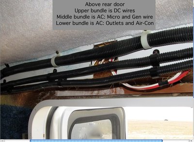

There are a few options for running an outlet to under the stove. I'll lay out how the wiring runs so you can decide how you want to do it. Reason I say it that way is because you may make a different choice than I did. I used the microwave wire; the way Chinook wires, the microwave outlet is dedicated to ONLY the microwave so is fairly under-utilized (especially in my case). Hence I have a super robust circuit for a floor heater. If I (well, someone else) reinstalls a microwave then it will still work fine, but one wouldn't want to run both at once.

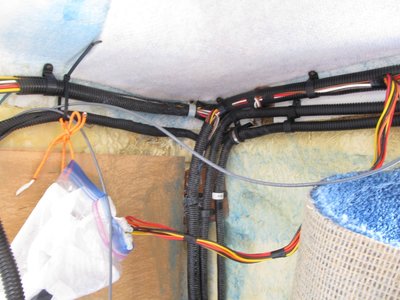

This may be more than you want to know :lol: , but I always enjoy the "guts" photos posted by others. So in that spirit, here are some photos that show the basic layout (at least on my '99; but my guess is this didn't radically change on any Chinook with the same basic wiring layout (i.e. at least '97 and newer - but I've seen some photos of older 18+ models with some very similar wiring).
Okay, so here we start with the wiring that goes "across the great divide' - from the driver's side to the passenger side. Here are the three main looms as they pass over the rear door. The large upper one is the DC wiring (would be nice if it were not in such a single large bundle as that de-rates the wire quite a bit but oh well it seems to still work fine); the middle one is AC wire for the generator and microwave; and the lower one is AC wire for the outlets and Air-conditioner. This is accessible by removing the carpet "hump" over the rear door.
Next it continues on at the ceiling/wall junction until it gets to the rearmost/outboard corner in the closet. At that point the DC bundle splits, with some heading straight on across (where it can chafe on the refrigerator fins - something to check), and some splitting downward along the corner. The AC wires all go down in the corner (I think that one AC wire going across to the left is one I was in the process of adding for an outlet by my new hall counter). The thing in the baggie is the inside generator control that's in the closet front wall. So in other words everything on the right half of the photo is rear wall, and the left half is outside passenger wall. This is only accessible by removing the carpet "wall" of the outside of the closet (in my case, having navy carpeting, I was tired of the "black hole" and so will be putting back marine hull liner carpet that is more similar to the overhead carpeting in our rigs - it's such an irregular wall that carpet is more practical than something like wood).
