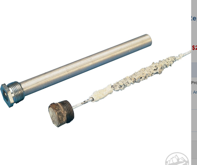

After getting into the hot water heart I saw that it is a Suburban Model 5032 SW6D 6 gallon tank. It's a 1997 Chinook.

Re: Need a little help
Hey, no worries. That's the typical stock Chinook water heater (still easily available, as are parts).
Here is a link to the manual (says installation but is also for operation):
http://manuals.adventurerv.net/SW6D-SW6 ... lation.pdf
This is what the anode rod looks like (you can see why I think yours has been replaced with something else)... On top a fresh one and on the bottom one that should have been changed sooner! Just the hex head sticks out to where you can see it - the rest is inside.
