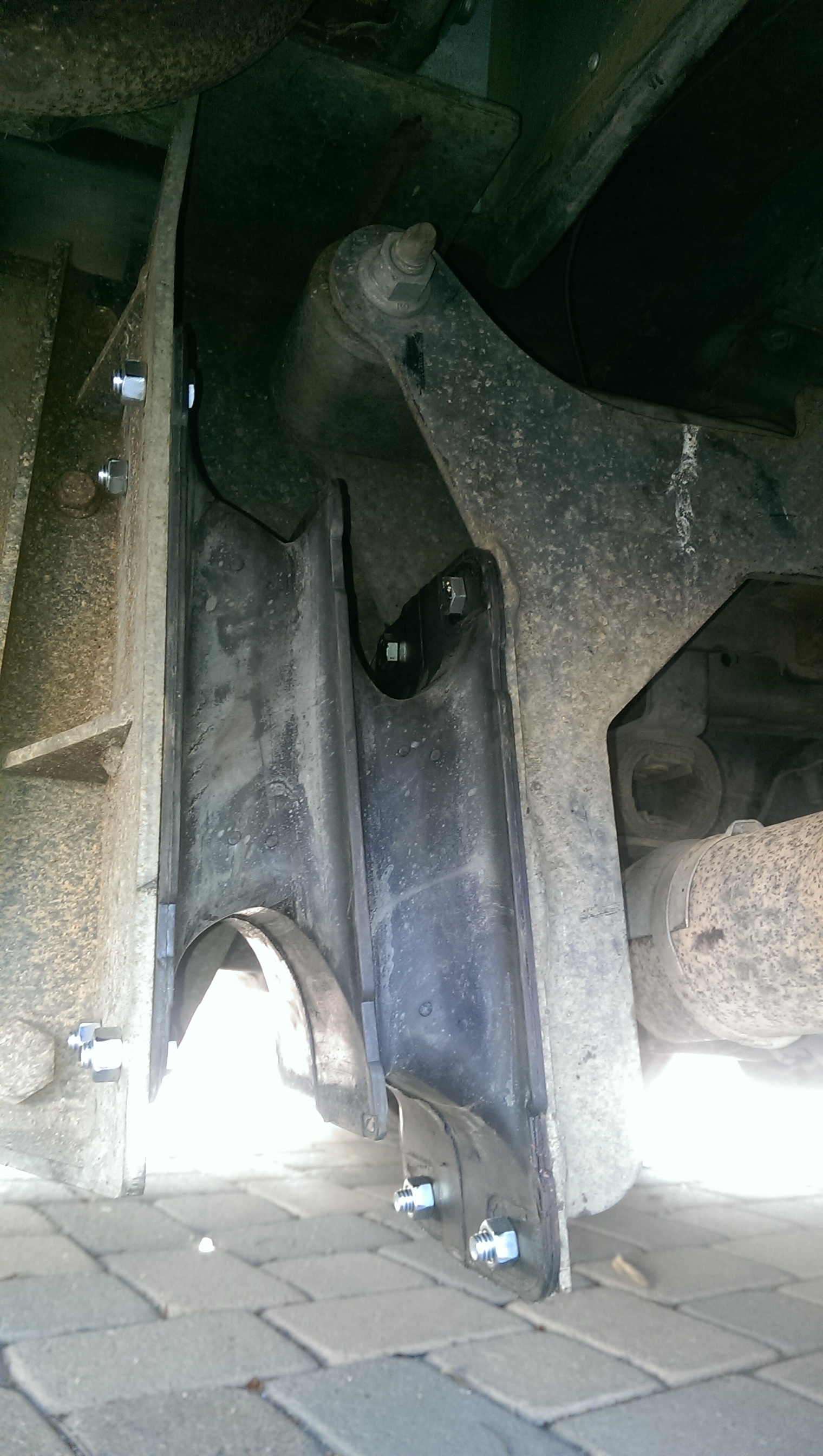

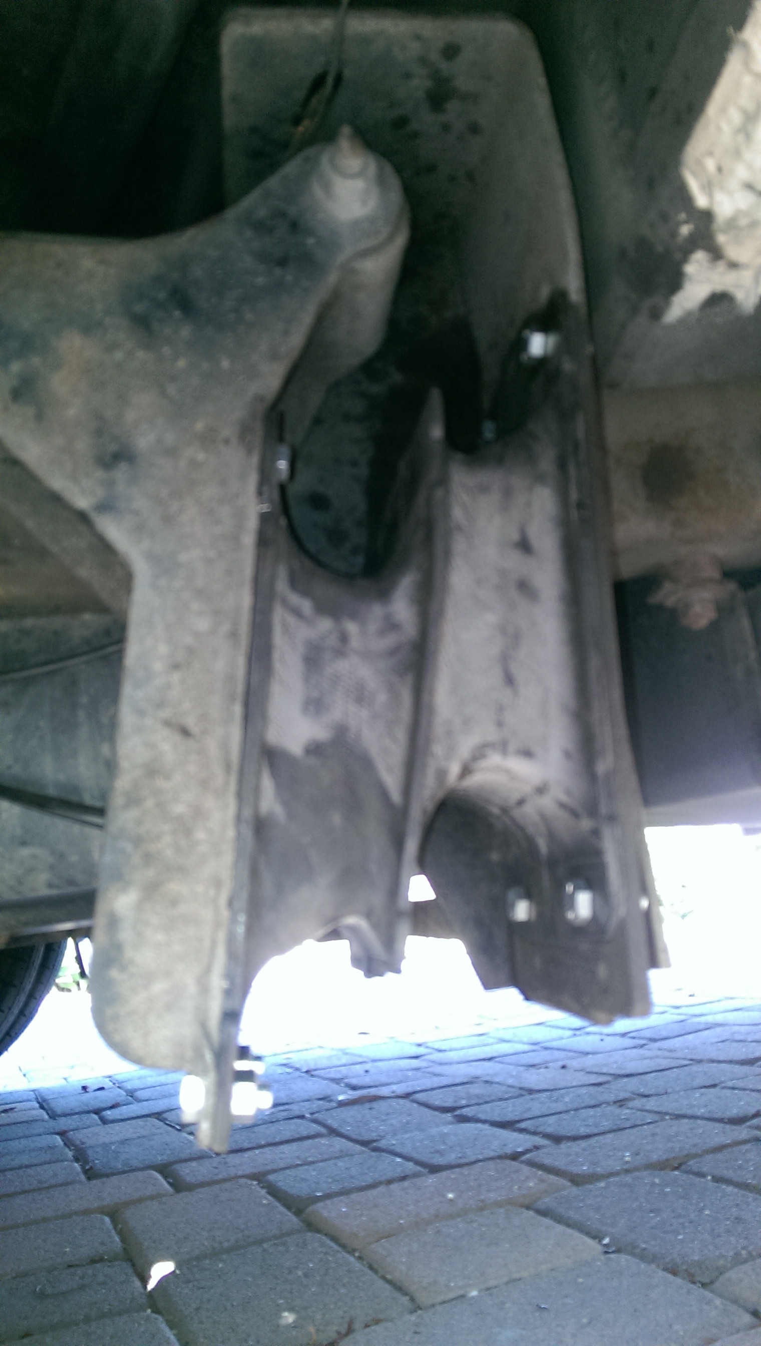

Xatlatc wrote:Would someone please post a photo of where the MORryde Shocks are located? I've been underneath the Chinook looking but I don't really know where and what to look for. Thanks.
Here are pictures of my new ones recently installed:
Mor-Ryde Rubber Spring
PS. Skillet got a great deal on his installation. Mine cost $500 because they didn't know how to do it, and it took them all day.
After new tires (Hankook), shocks (Monroe), and Mor-Ryde spring replacements, the ride and handling is fantastic.

Thanks for the photos Clay. I'm going to take a look tomorrow.
