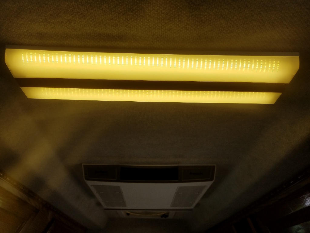

kdarling: you may try "light diffuser film". It could reduce the harshness by up to 30% depending on the matte finish you use. It's used in photo studios all the time. BTW: I believe the light leakage you mentioned is due to the tiny extra space built in the mounting flange allowing for the heat sink to vent heat away. A totally flush fit could result in heat build up between the fixture and the surface it's mounted to.

HoosierB wrote:kdarling: you may try "light diffuser film". It could reduce the harshness by up to 30% depending on the matte finish you use. It's used in photo studios all the time.
Good idea. I even thought about spraying some of my etched window glass film on it.

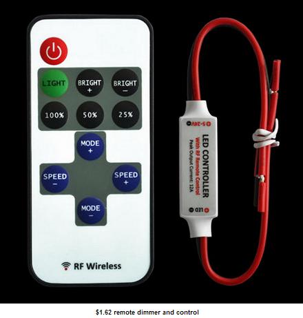

For now, I punted and simply added one of the $1.62 (with free shipping!! okay, it did need a $4 CR2025 battery) wireless remote dimmers I got from China off eBay.
The weird thing about this dimmer / light combo, is that if I drop the brightness to zero, it will not come back on until I click the light switch again. I think the light itself operates that way: if it loses power, it does not come back on automatically.
For my use it's fine, since I use the light switch to turn it on/off, and it comes back at whatever level the remote dimmer was last set at. I have set it to 50% brightness, which is bearable and still provides sufficient light.
So in this case, the remote is only being used for setting the brightness level, not for normal on/off operation. I'm keeping the remote control inside the overhead cabinet, so if I want to, I can dim it down for more mood lighting effect, or up to 100% if I really need the interior lit up :)
Totally makes sense. Thanks!
