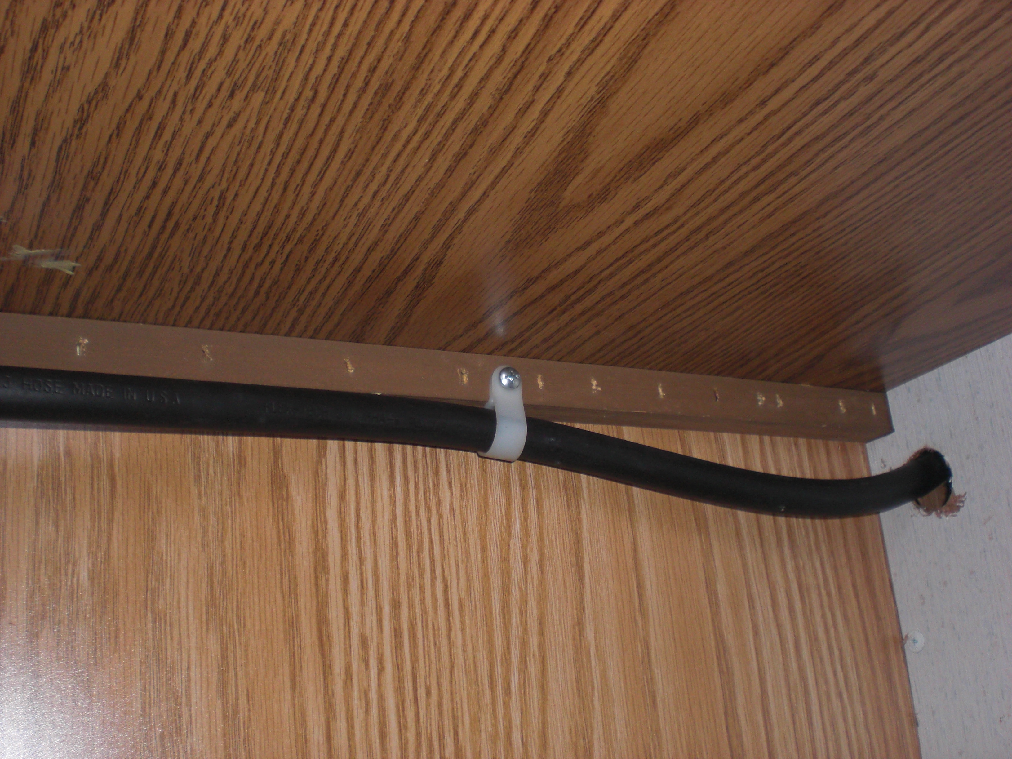

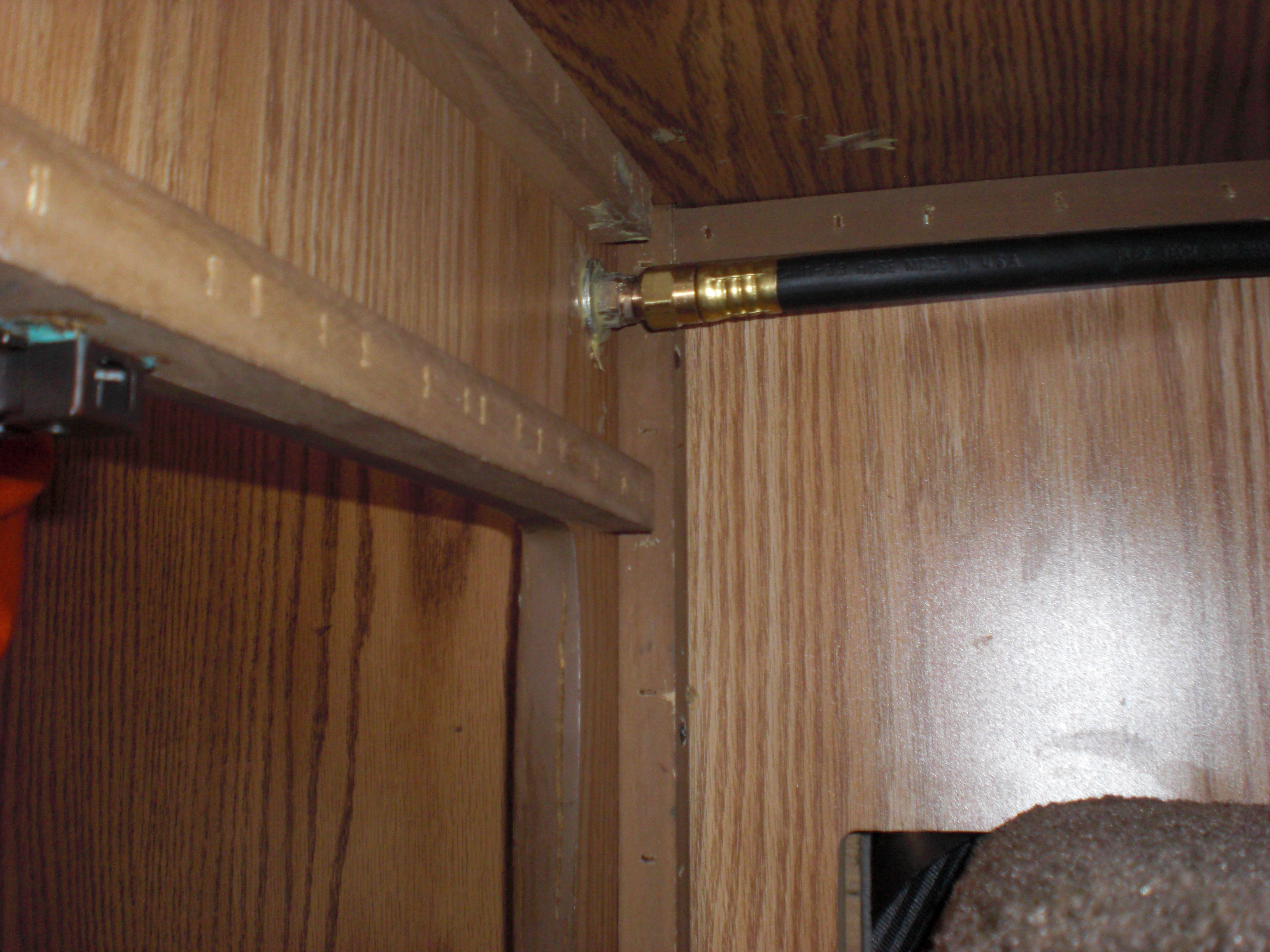

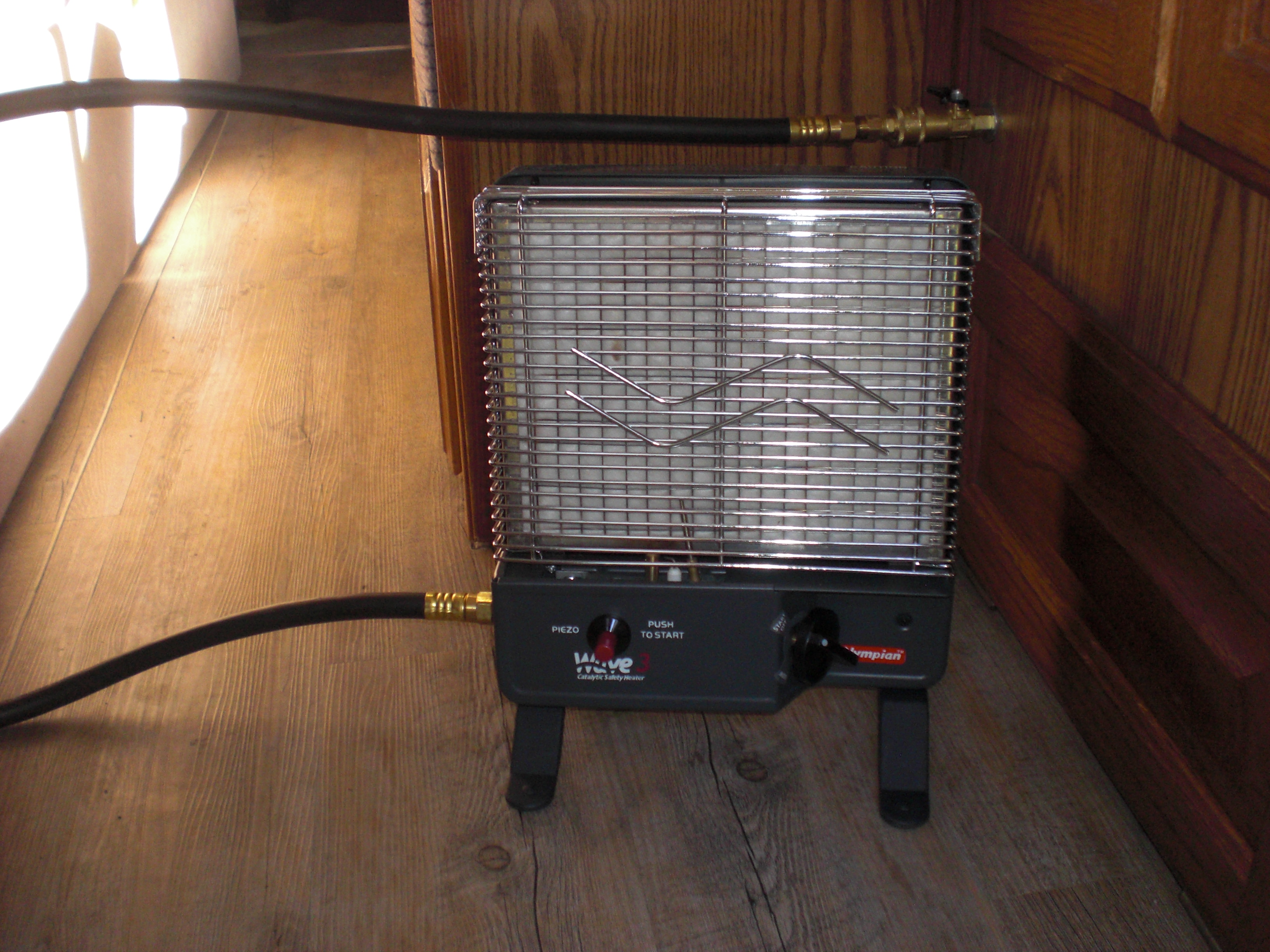

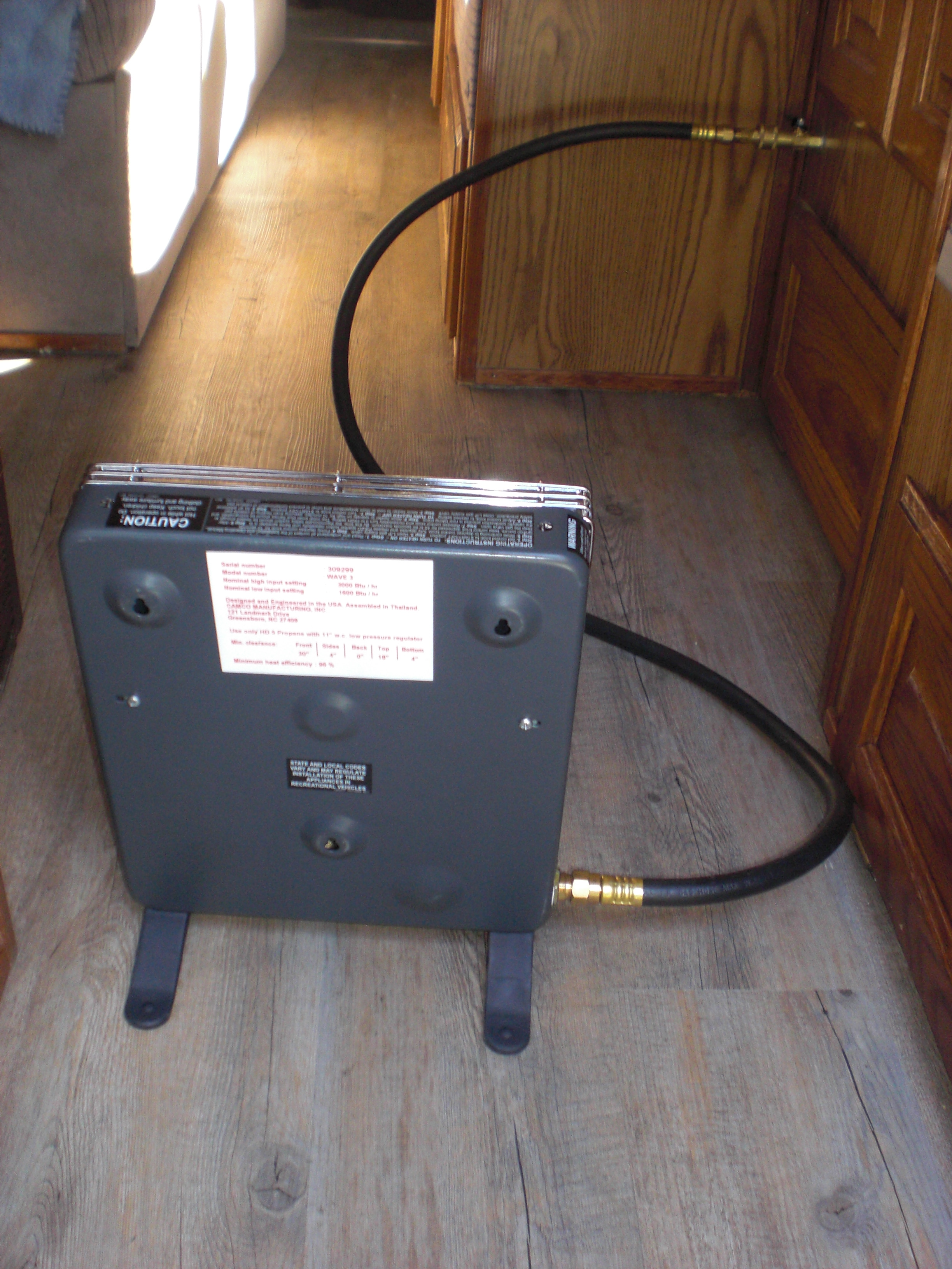

Wave 3 Heater install completed, by an RV service shop. The Concourse dinette floor plan does not have a large enough area with adequate clearances for a permanent mount, so he installed a quick-connect under the cooktop cabinet. The hose is long enough to place it near the rear pointing forward, so should aim the heat right into the living space. Just got it back so have not tried it out yet.

Nice job. I'd be interested in your thoughts on how it works. Whenever you have time, could you post a pic of inside the cabinet?

If you end up getting tired of the stock legs (they hold the heater pretty far from any wall, plus don't fold for storage), it's possible to make a plywood (or whatever material) back that extends out like an easel when in use, then folds flat for storage. Or other creative idea.
I have a few more options of where to mount one (non-dinette plan), but have been using mine on the legs just to get an idea of whether I would like it long term, and/or where I might like to mount it. If I were to keep it (or a Wave 6) in portable configuration, I'd make an easel type "leg" setup for the above reasons.
Nice clean installation you have.

The inside cabinet installation looks pretty clean. The work order says they removed the stovetop and wall cabinet, cut the LP line and flared both ends, installed T and run LP line. Cut hole in cabinet wall and installed quick connect fitting. Ran LP leak test and gas pressure drop test, put everything back together.
My original thought was to store the heater against the dinette back, secured with a bungee when not in use. As Blue notes, the legs are too long in back so I had my neighbor/boatworks/metal fabricator cut them down, he took about 5" out of the middle. He was concerned it might not be stable enough, but seems to be fine. You can see in the photo of the rear of the heater, they are about the same length front & back now. The heater fits under the rear dinette over the wheel for storage, not sure if it would with the long legs.

Thanks for the pics and detailed description!
