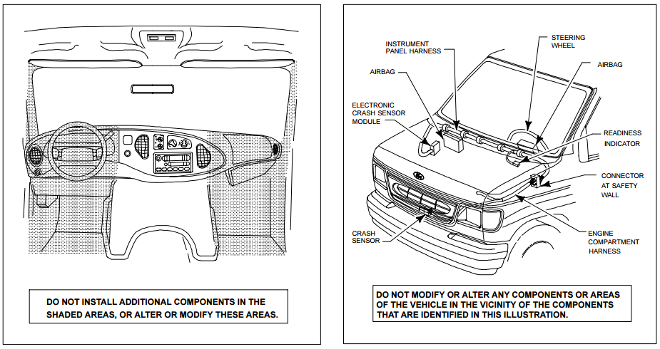

What has me concerned is Warning where it says do not install on front bumper for those vehicles with air bags. The unit NV-515W came with a dash switch and wiring information, etc. I plan to use the overhead running lights switch. The 2004 Chinook Concourse is on 2002 Econoline van chassis, V10, E350.

As for the airbag warning, that's common and would apply to something a bit more substantial, like a light bar. The worry is that something structural could change what goes to the collision deceleration sensor, and cause it to fail to fire the airbag (or fire it at the wrong time).

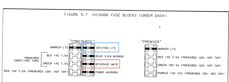

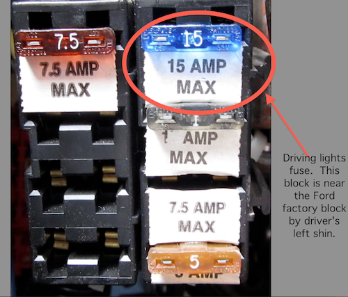

Nick,
I don't know if you are still interested in this info, but here is a photo of the Chinook auxilliary fuse bock (powered by the Ford system, not the house system) that is in my '99 Concourse and a diagram of it from the 2000 manual. I looked in the 2005 manual and although they no longer show the diagram, they do still describe the fuse block and say that the driving lights run through it.
As shown, on mine it is the upper right-hand fuse, specced at 15 amps.

Thanks for sending me the fuse location. I copied them to my chinook photo file. You have been a big help. Both my fog lights had water leaks. Thus I am installing new ones. I just want to know were the fuses might be incase it does not light up. I am aware of the switch on the over head. This forum has been a big help in educating me on Chinooks.
