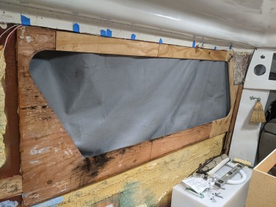

It's difficult for me to get to an edge of that wall right now (everything in the way), but I think it might be 3/16" plywood plus the fabric. Unfortunately, I can't get under it, so I can't see how thick the wood support around the window is. I'd say you're thinking correctly, with the caveat that I haven't done anything around the window, myself, yet, so I have no actual experience here

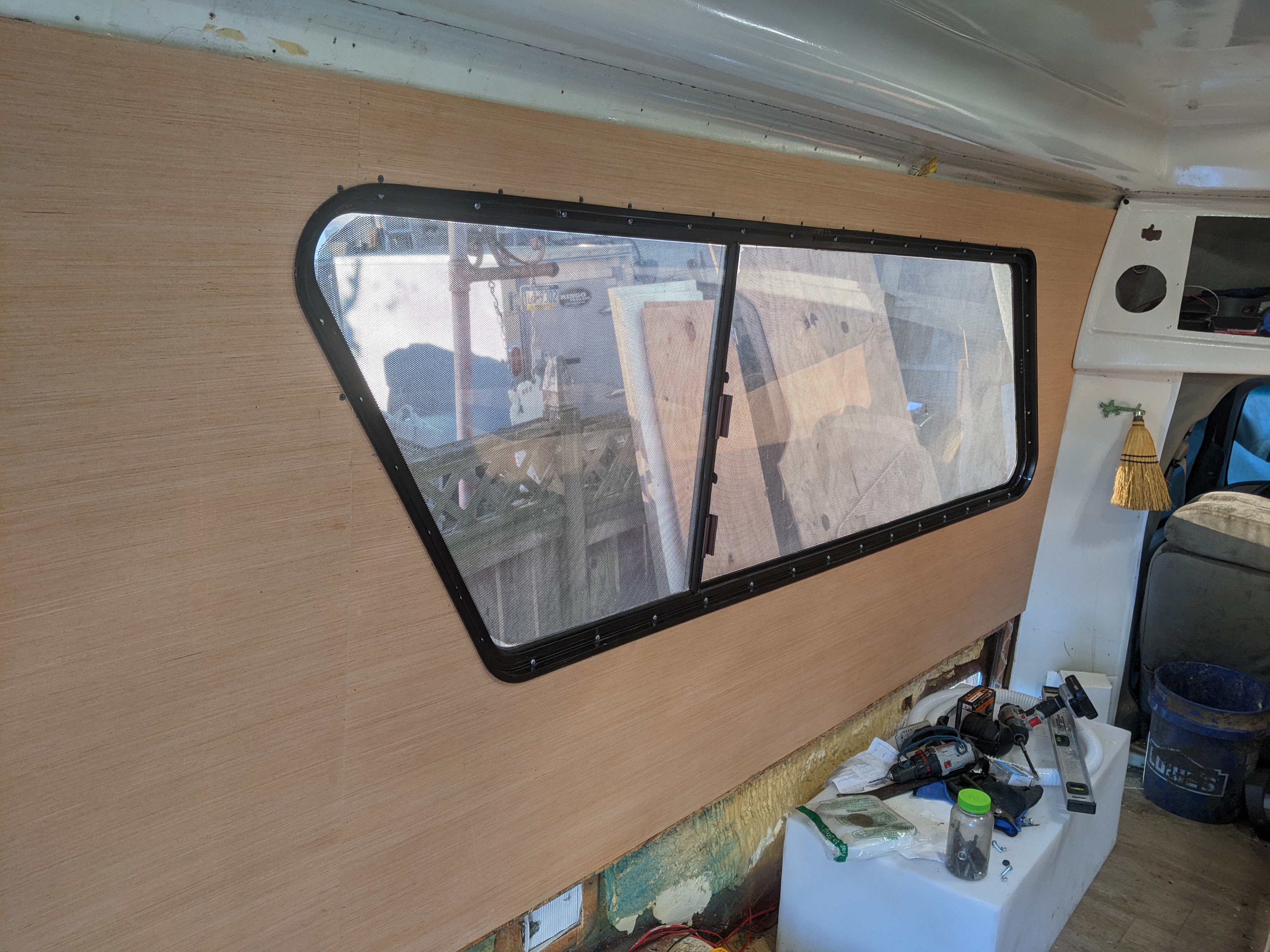

The interior fabric-covered wall goes up under the window's clamp ring, making it look nice.

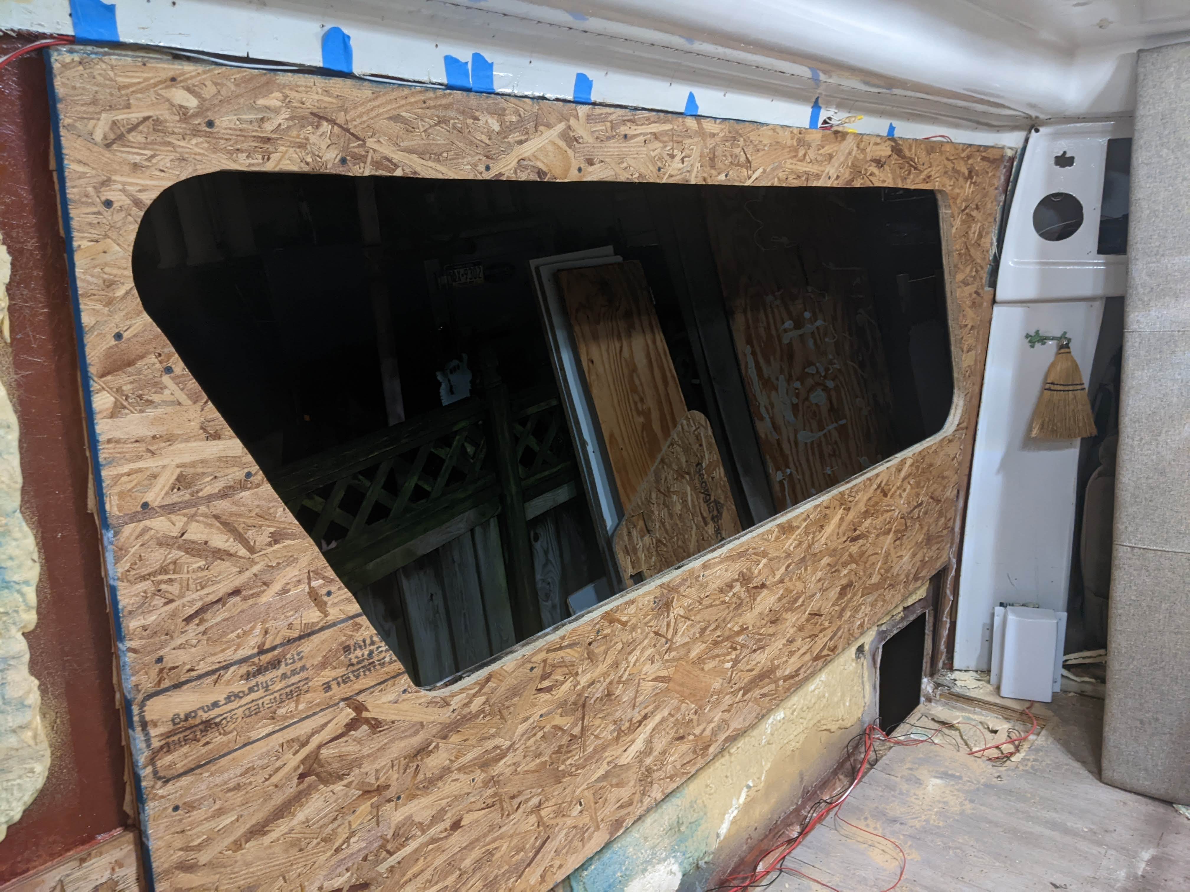

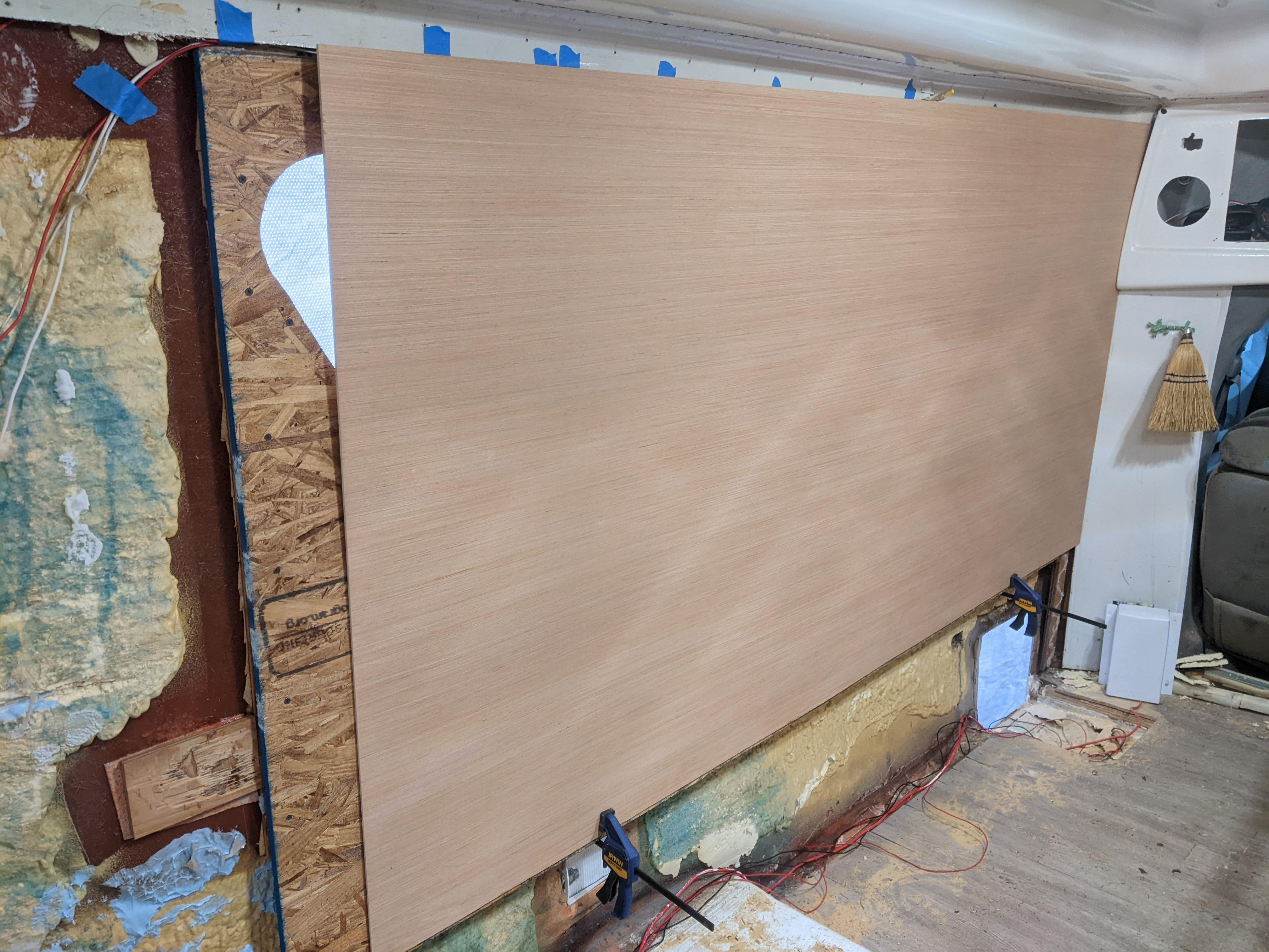

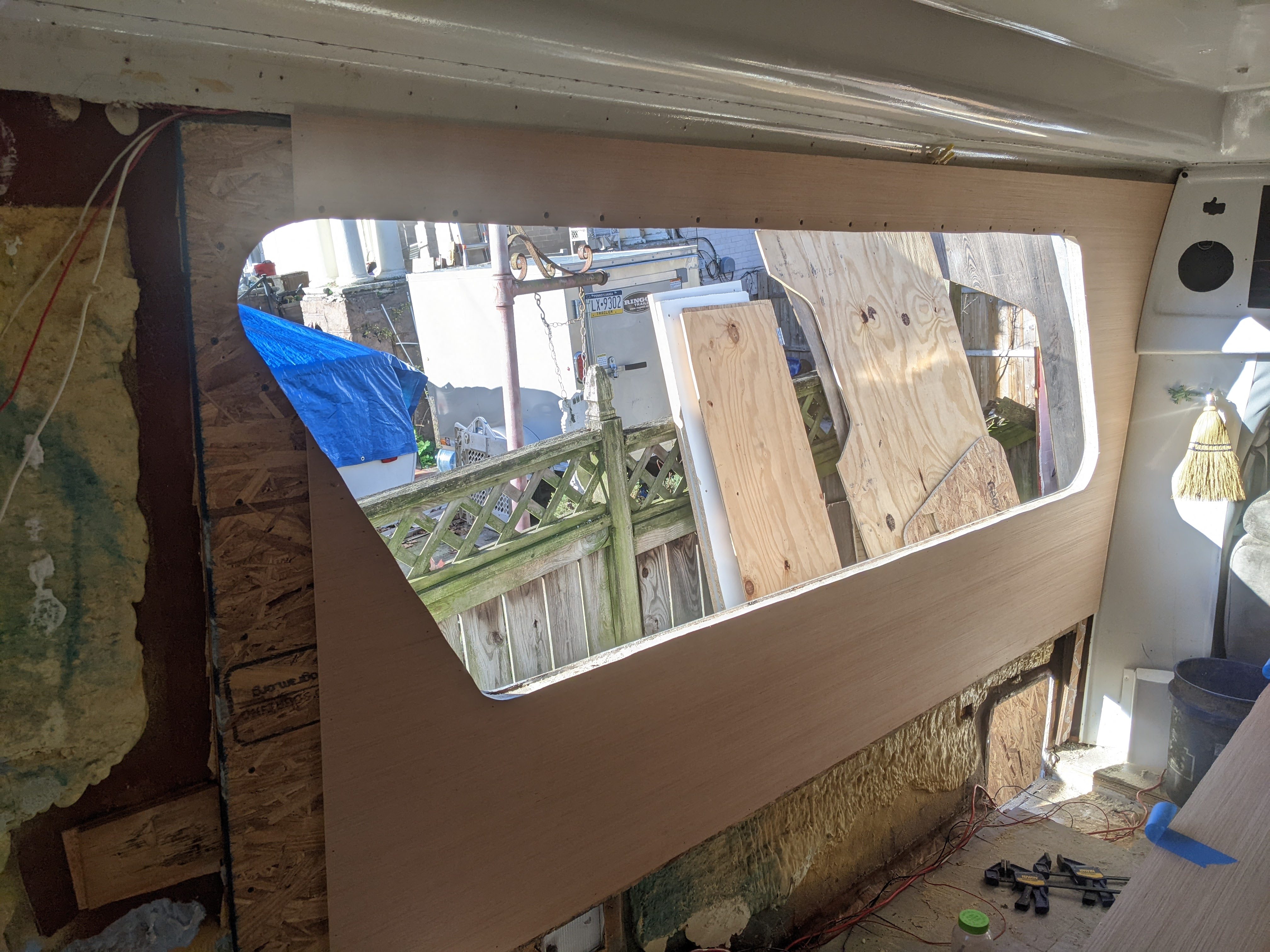

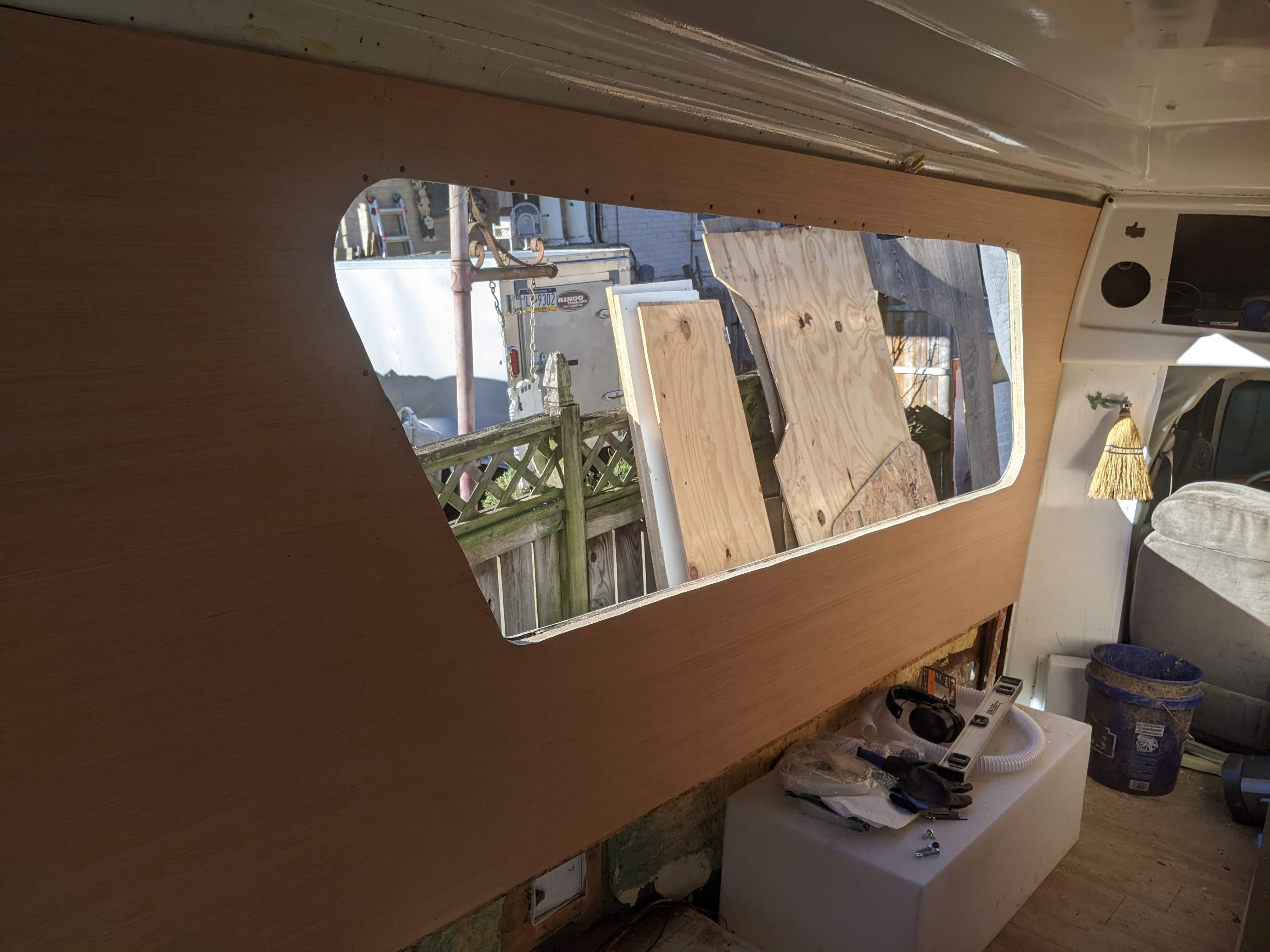

After replacing the damaged pieces with new 1/2" pieces, I placed a 19/32" sheet of 4'x8' sheathing and secured it to the wall using 1 1/8" screws. I then used a jig saw to cut the hole out from the outside. I then placed a 5mm thick sheet of wood over the sheathing with wood glue, finish nails, and a few wood screws near the top where the fiberglass curves slightly. Stacking these pieces together gave my wall a total of 1.5" thickness.
Lastly, I placed some butyl tape on the flange of the window and secured it into place with the ring clamp and new metal screws.
