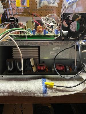

caconcourse wrote:
"I have a PD4645 you can have if you send me your shipping address via DM. I replaced it with the lithium version (LIV) so i don't need it anymore. It originally came with the shell, which probably made it a little easier to install, but my LIV replacement only came with the circuit boards, so I reused the shell from the last one. This is probably the difference you were referring to. You should be able to replace the Magnatek board with the PD4645 in the original shell. You may or may not have to drill new mounting holes but should be easy."
I took the old Magnatek out and am trying to figure out how to remove the circuit boards from the shell. Access to the internal area is non existent.
I've attached a pic of the new one sitting atop the old one.
I can see that I will indeed have to drill new mounting holes for the PD4645 board, but I'm wondering how you were able to get the old Magnatek board out?
I may have to grind off some top rivets to allow access.

Re: 2000 Chinook engine battery died on trip.
"I may have to grind off some top rivets to allow access."
You have answered yourself there.
Ideally, you should call Progressive Dynamics and see if they have the enclosure that they can sell for you. Putting a 110V AC device into a different enclosure may not be the right thing to do since it may invalid the UL listing, etc., but I have done plenty of aweful things in my RV, so I will keep quiet.
Chin, I thought of that too, as this new to me PD4645 has two fans, versus only one on the old Mag. The old enclosure only has one major airhole, where the old fan used to be. It may not be enough airflow if this one gets hotter than the original.
I have already put in a request for one at PD, but they are busy and haven't got back to me yet. I may just cut a couple more air holes in the shell and entice mice to visit.
I found a skeleton in the old Mag. It had once been a frog (only about two inches).
Either way, I'm so glad to be doing this project, because I'm learning a lot by duress.
And the price was right too ha ha. Well, at least I'm not charging myself labor (and neither is anyone else). I just have to be patient and figure things out.
By the way, I've already installed the new guts into the old shell, but I will wait for PD to return my email, or I will call them.
