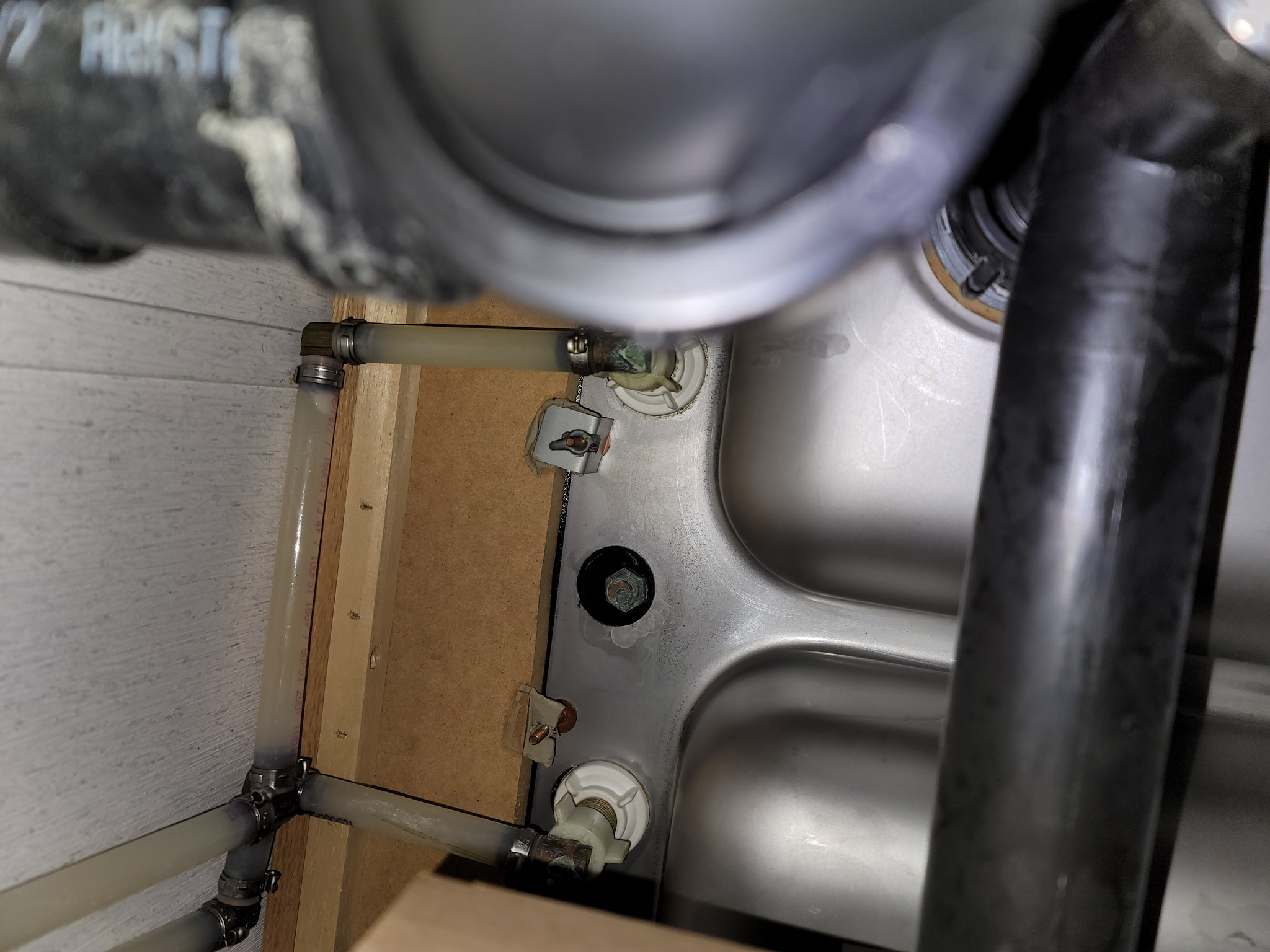

I just replaced my old, leaky faucet with a new one. I spent time on the Lowes web site reading install manuals to find one I thought I could reasonably install without making myself insane (I can only get one arm in that cabinet at a time).
Incidentally, if you haven't had a look yourself and are wondering what you're up against if you have this generation Premier, this is what the underside of my stock faucet looked like:
I ended up with a Pfister Allegan (https://www.lowes.com/pd/Pfister-Allega ... 1000205621), which installs just like the old one I took out, right down to the 1/2" threaded connectors on the underside of the sink. I thought I could just re-use the existing PEX connections, but I couldn't get them lined up quite right - the angles were just a bit wrong when the faucet is positioned so that the deck plate sits far enough back that I can use the sink cover, and the PEX is just not flexible enough... I finally gave up.

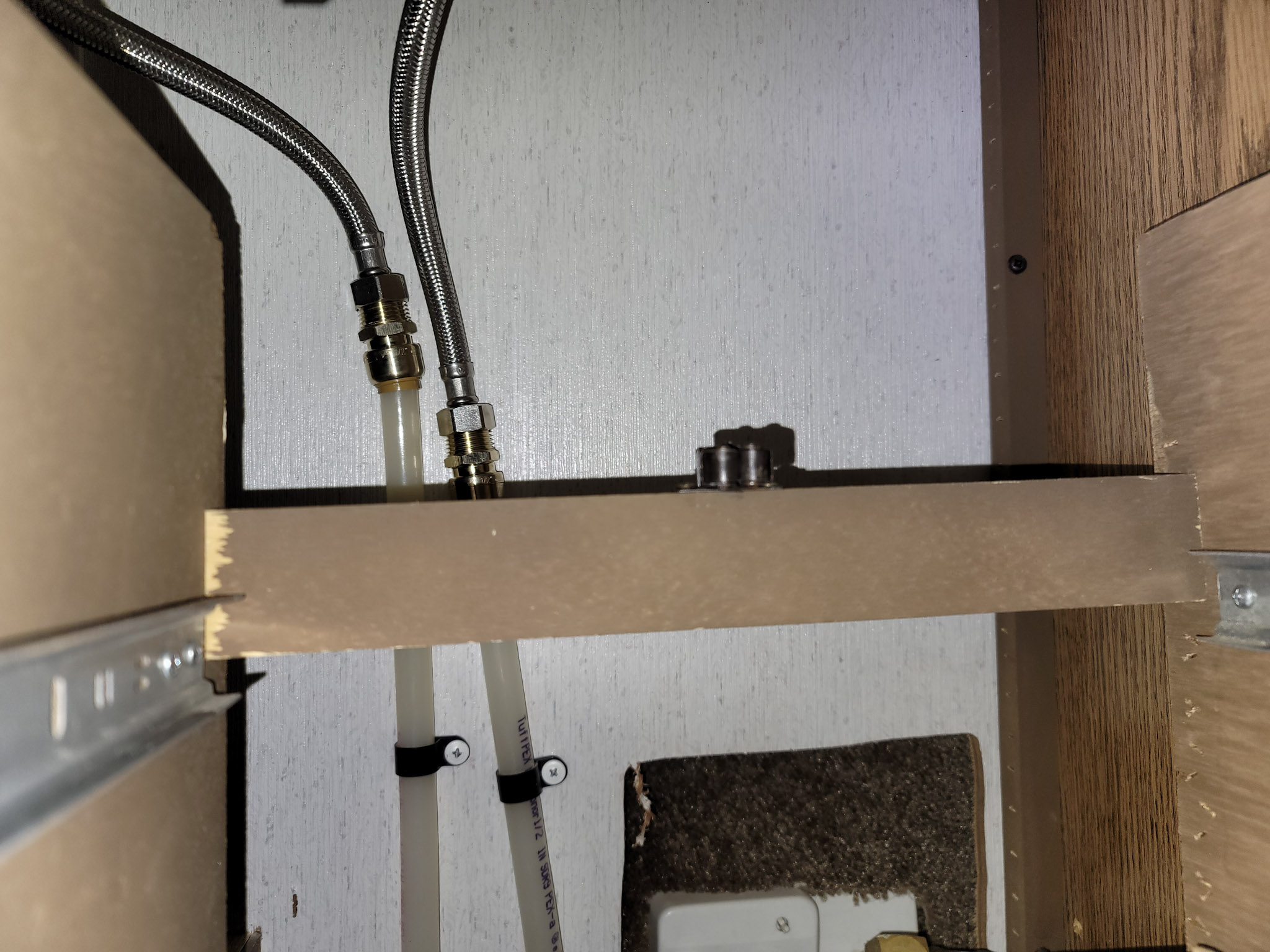

Since no project can be completed without at least one extra trip to the hardware store, I went back and got 12" x 1/2" faucet supply hoses - the braided metal kind, and a couple of push-to-connect 1/2" MNPT adapters, along with a PEX pipe cutter. It really was a very simple job, just awkward. Attach the adapter to one end of the supply line, screw the other end to the faucet stem, cut the PEX line, and shove the push fitting onto the end of the PEX. I'm not sure I had enough leverage to make a really solid seal that would hold up to city water pressure, but I didn't have any drips when I turned on my water pump, with or without the tap running, so I'm cautiously optimistic that I won't have to go back for crimps and such.
Fingers crossed it all stays tight when I go jouncing over the next set of railroad tracks!

You really need to make sure the Sharkbites are all the way in, otherwise, it will leak. I will test it at city pressure with someone inside who can yell out to stop when you turn on the pressure. The pump is maybe 15 psi? City water can be 60-80psi.
The good think is that you got a PEX cutter, and it cut the edge nice and square. I would mark the pipe with a Sharpie so that I can tell how much is in the Sharkbite. Once it is in there, it should be fine. Personally, I don't use Sharkbite unless it is readily accessible, FWIW.

The one on the top does not look like you push it all the way in.... I will remove it, mark the pipe, and re-insert it so that you know it is good.

It does look a little crooked, but that supply line is putting a fair amount of downward pressure on it. My hardware store did not have the depth/deburring tool, so I'm not sure how to tell when it's far enough in (other than the "it doesn't leak" test) - how far down would you mark it?
I have watched the videos for using the crimp and clamp connections, and I don't think I could manage that in this space - one handed, working by touch only.

Never mind, found the chart for how deep they need to go: https://www.sharkbite.com/resources/pip ... epth-chart
Now how am I going to measure and mark that when I cannot see and touch at the same time? hmmmm... pondering... masking tape cut to the right length, so I can feel the edge, mark it, and remove the tape?

Do not use deburring tool on PEX with Sharkbite. I think you know what you need to do. Just mark it with a Sharpie pen, so you know when you did not go all the way into the SharkBite. If you only have one hand, just mark a line, and measure it to see if you need to add another mark so that you know it is far into the SharkBite enough for it to be seal by the O-ring. I prefer not not to remove the PEX from the SharkBite ever, but in your case, you should do it once and make sure it is good. They are not meant to be re-insert again, again and again. So insert it once (or twice for your case), and make sure it is good once and for all.
Again, you just need to mark it so that you know sufficient length of the PEX is inside. You can mark multiple lines and all you need to know which line is the minimum for it to meet the recommended inserted length.

Oh, another thing I want to point out is that you want to clamp the pipe/hose to the wall. You do you want the heavy adapter to bang against the wall or swing back and forth. Definitely will get it to come off the O ring over time.
