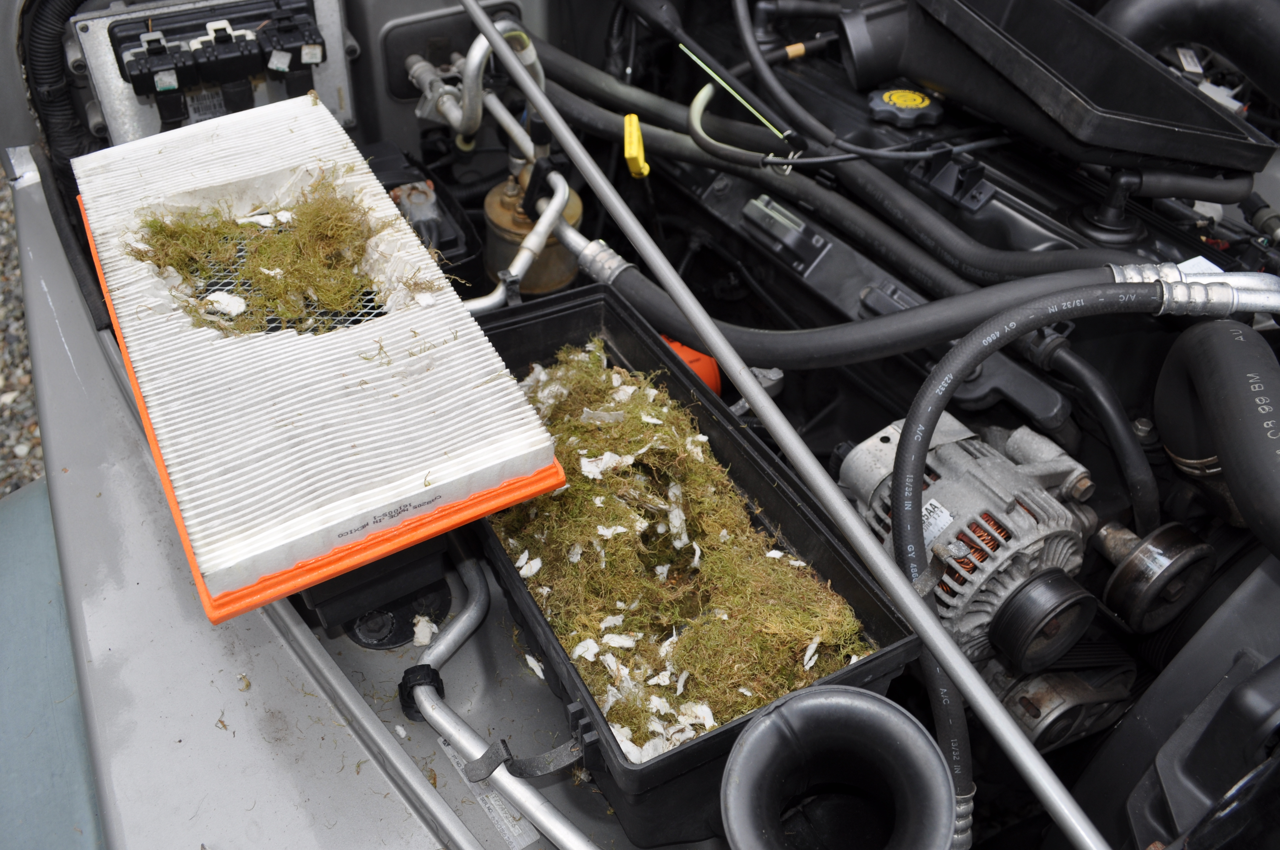

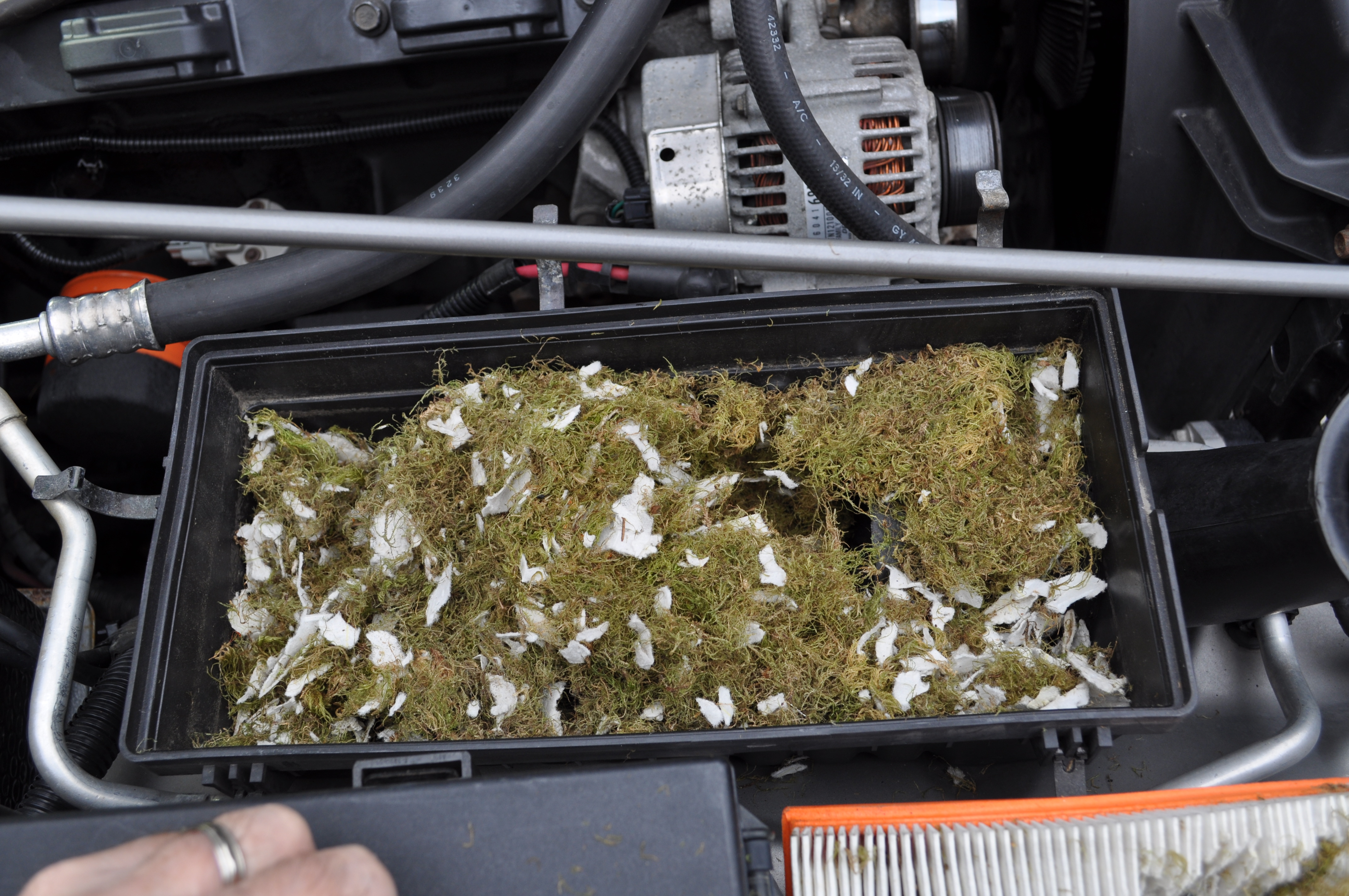

Here is what a rodent built in my Jeep Wrangler last year.
