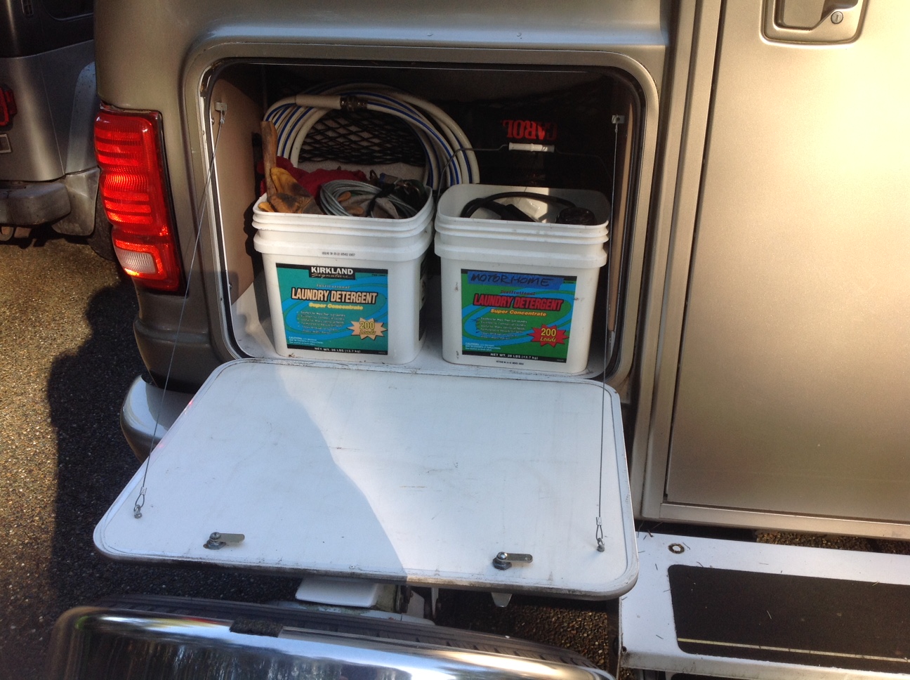

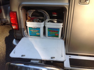

Re: Adding an outdoor shower to a Premier
My rear storage has all kinds of tools and maintenance stuff. I use buckets as water does seem to creep in a bit. Glad there is a drain! ;)

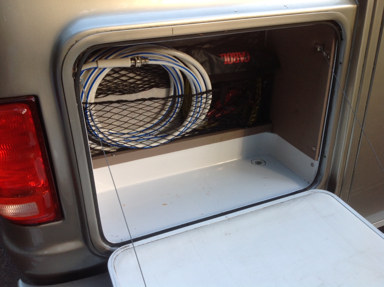

Post by BobW9 »
Hey, Steve, did you make that yourself? How did you find/make that flooring for the compartment? What are the walls made out of? It all looks amazing.
Bob
BobW9 wrote: May 28th, 2020, 3:23 pm Hey, Steve, did you make that yourself? How did you find/make that flooring for the compartment? What are the walls made out of? It all looks amazing.
Bob
Hey Bob,
That was the factory compartment for the Premier in 2004. The sides are padded vinyl, the back is carpeted like the interior walls and the tray w/drain seems to be plastic. It was well thought out and is very functional IMO. When installing my rear view camera I was able to easily remove everything above the tray. As I stated previously it gives good access to the bathroom plumbing.

Bob,
By the newest years they had "slickened" that rear storage area (and also thrown in the towel on keeping it dry). I think that is likely a molded fiberglass "tub" they added. When I see newer years, I can always see reasons I would like the new feature, and then reasons I like the ones from our era. So I like the tub, but OTOH, I have more space in mine. I do like the newer hatch frames with clamp ring vs. fasteners and trim strip (you can buy those I found out when I was hatch shopping for the water-heater door area).
