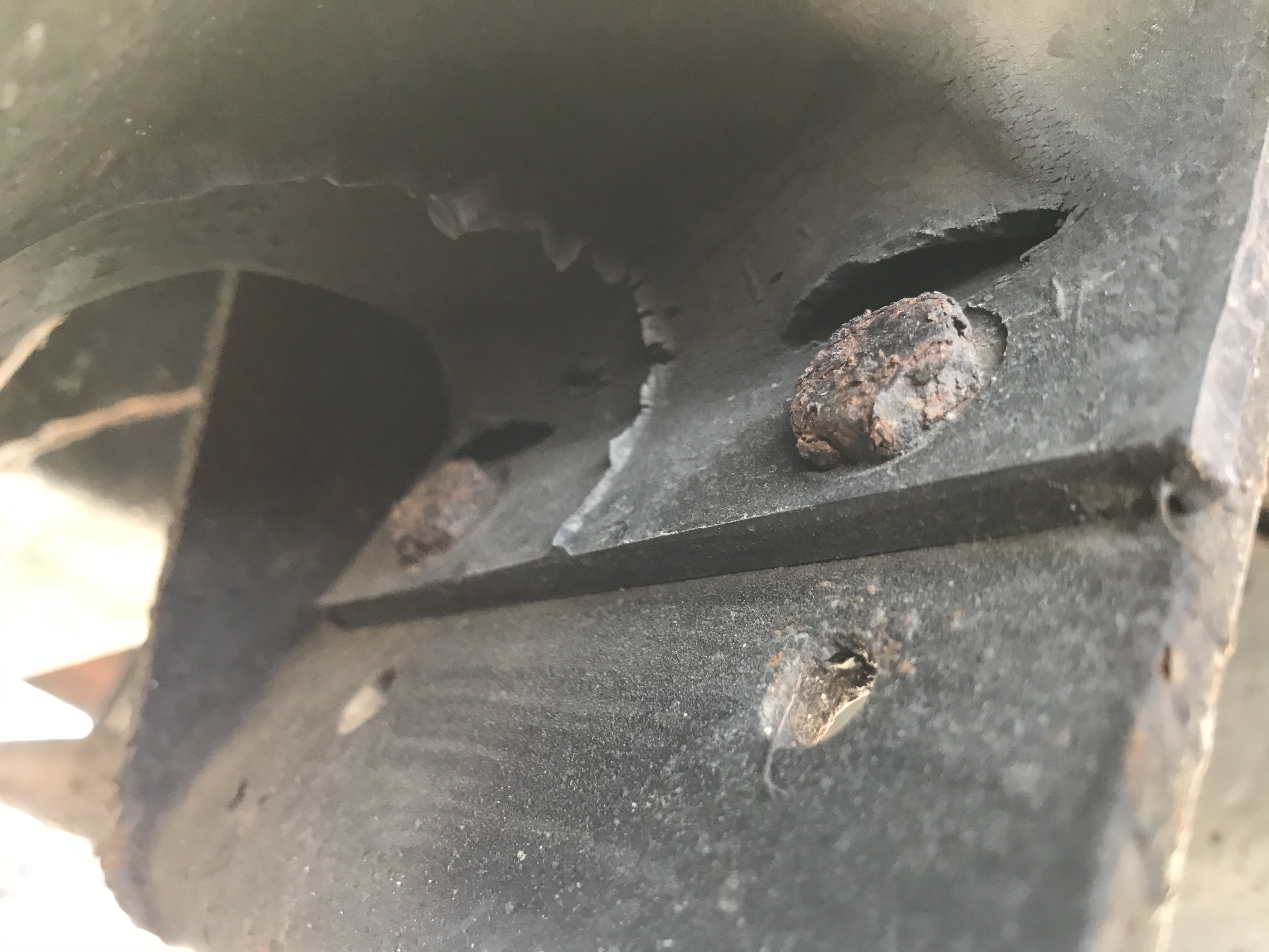

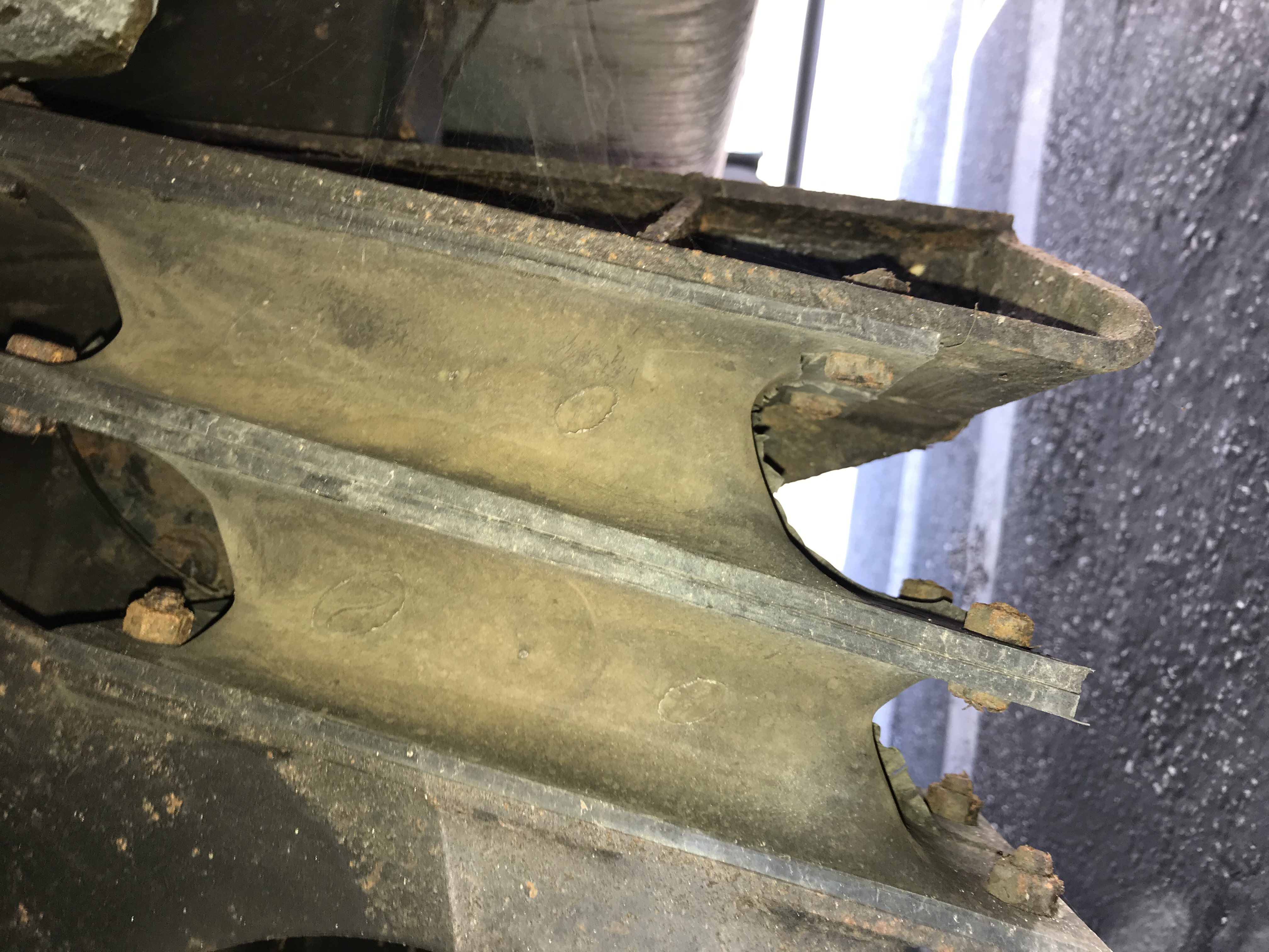

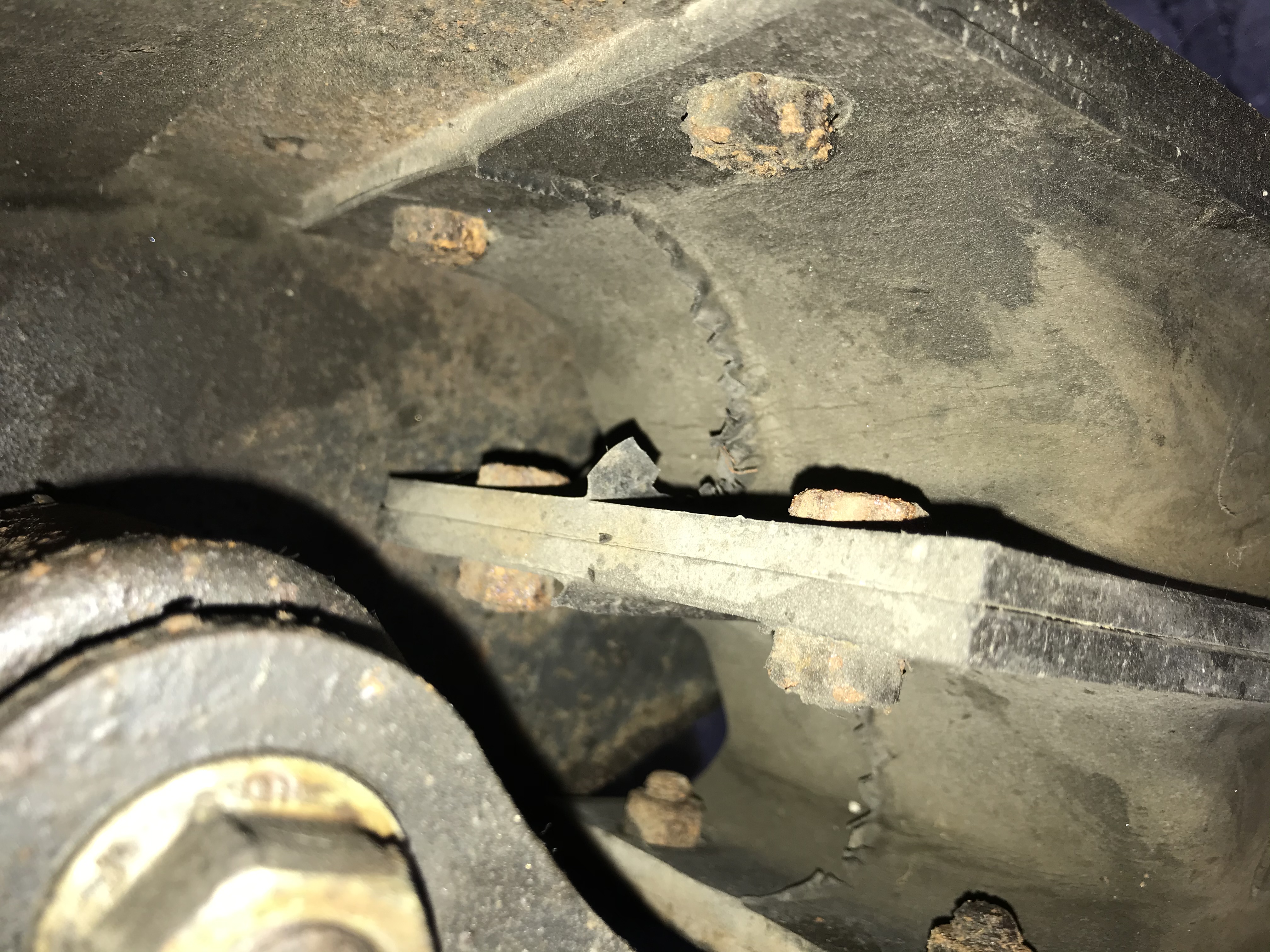

I think I would like to look at the MorRyde to make sure it is not ripped. If you have a chance, you may want to take a picture of both side, and post it here.

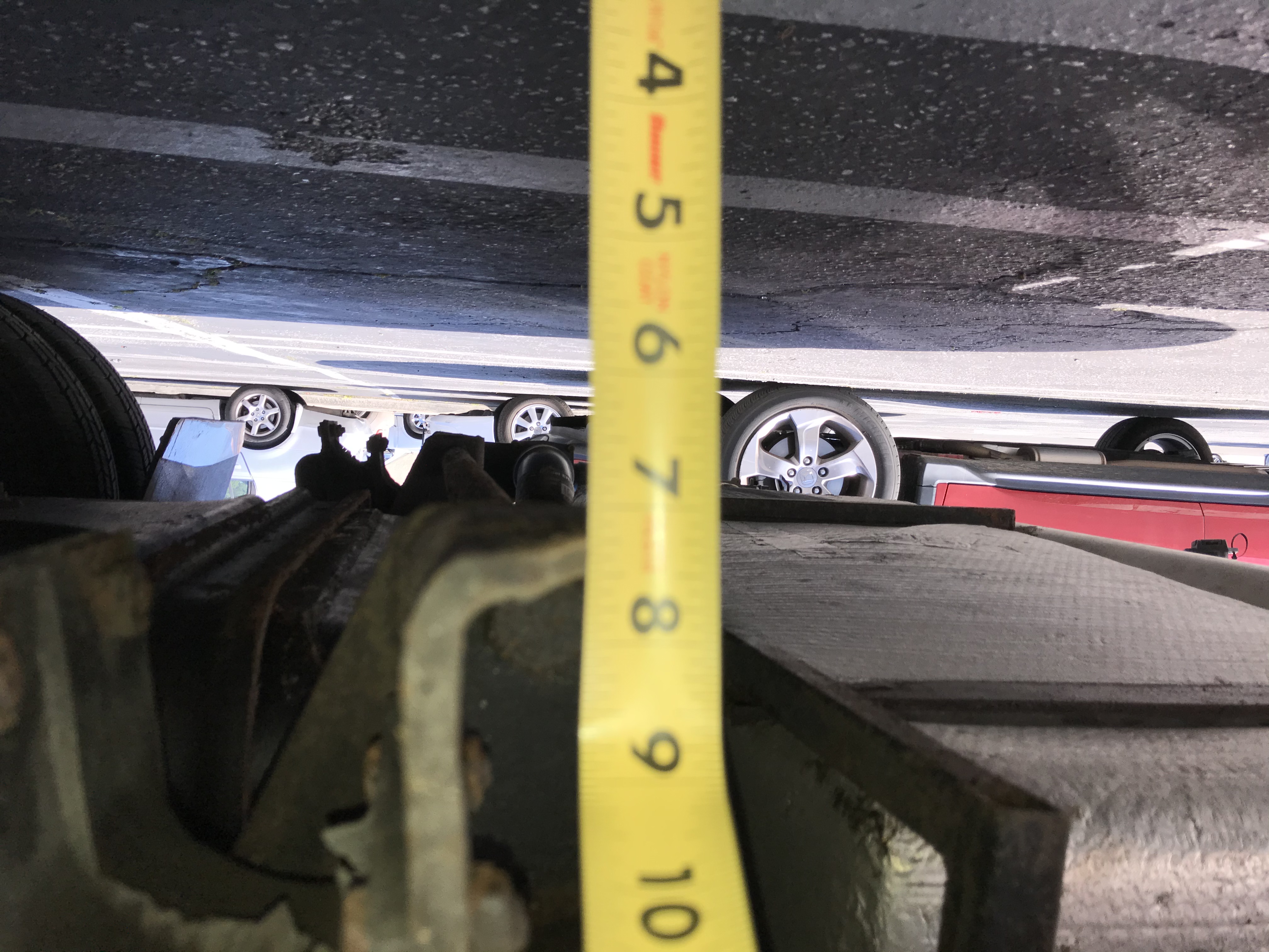

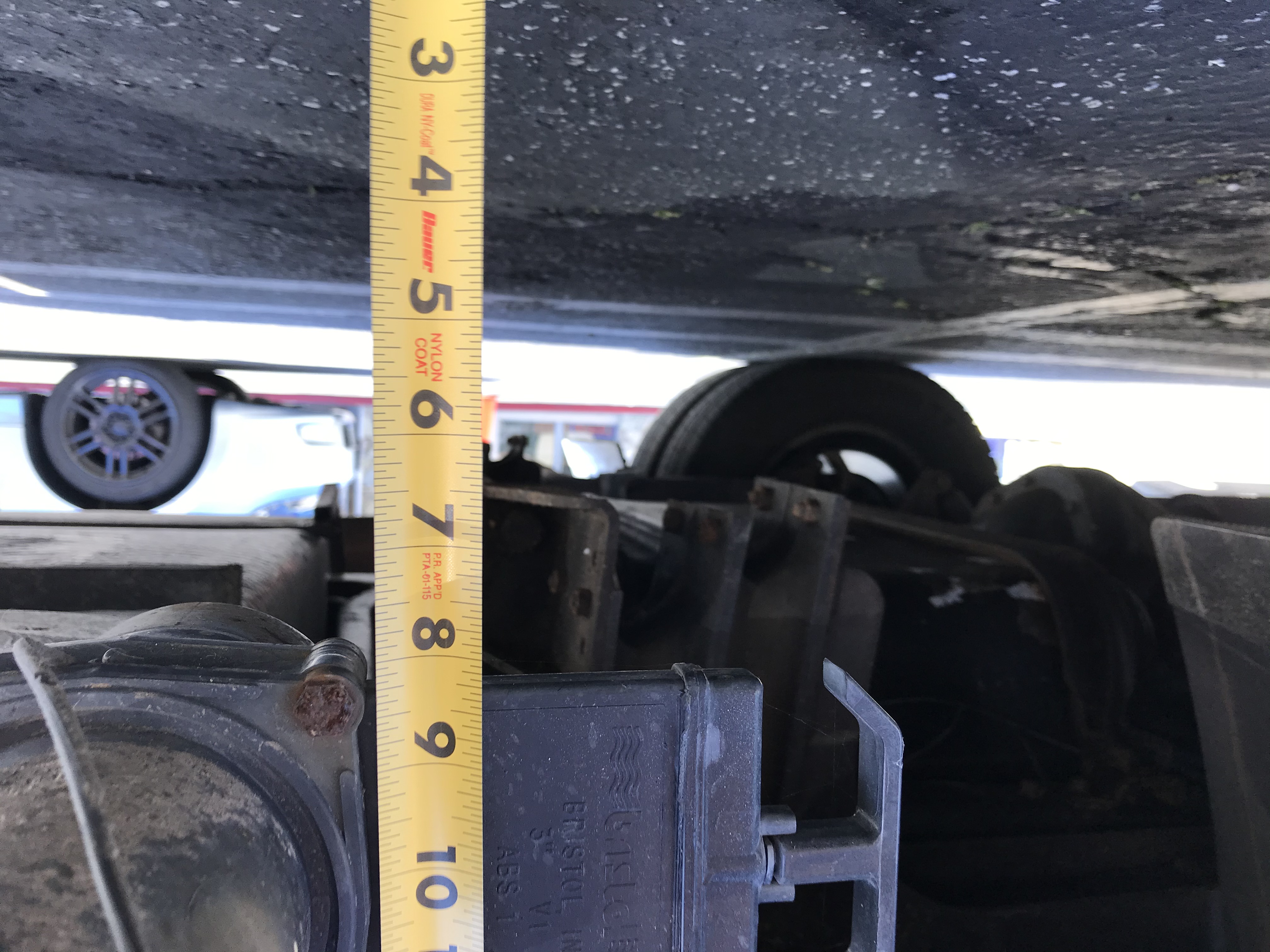

Just took these photos.. the MORrydes are the early stages of tears that are visible in the photos. But it doesn’t appear to have reached the critical point. But I am NO expert . The photo showing the tear near the bolt head is the bottom side. The other view with the large bolt showing in the side of the picture ... Is the top side view.
Thought I would throw in a ground clearance measurement from the lower end of MORryde support bracket.
To be fair my tires are a bit low at 59 psi cold at the time of measurements.. .
Full fuel
Empty water and waste tanks
Cabin empty.

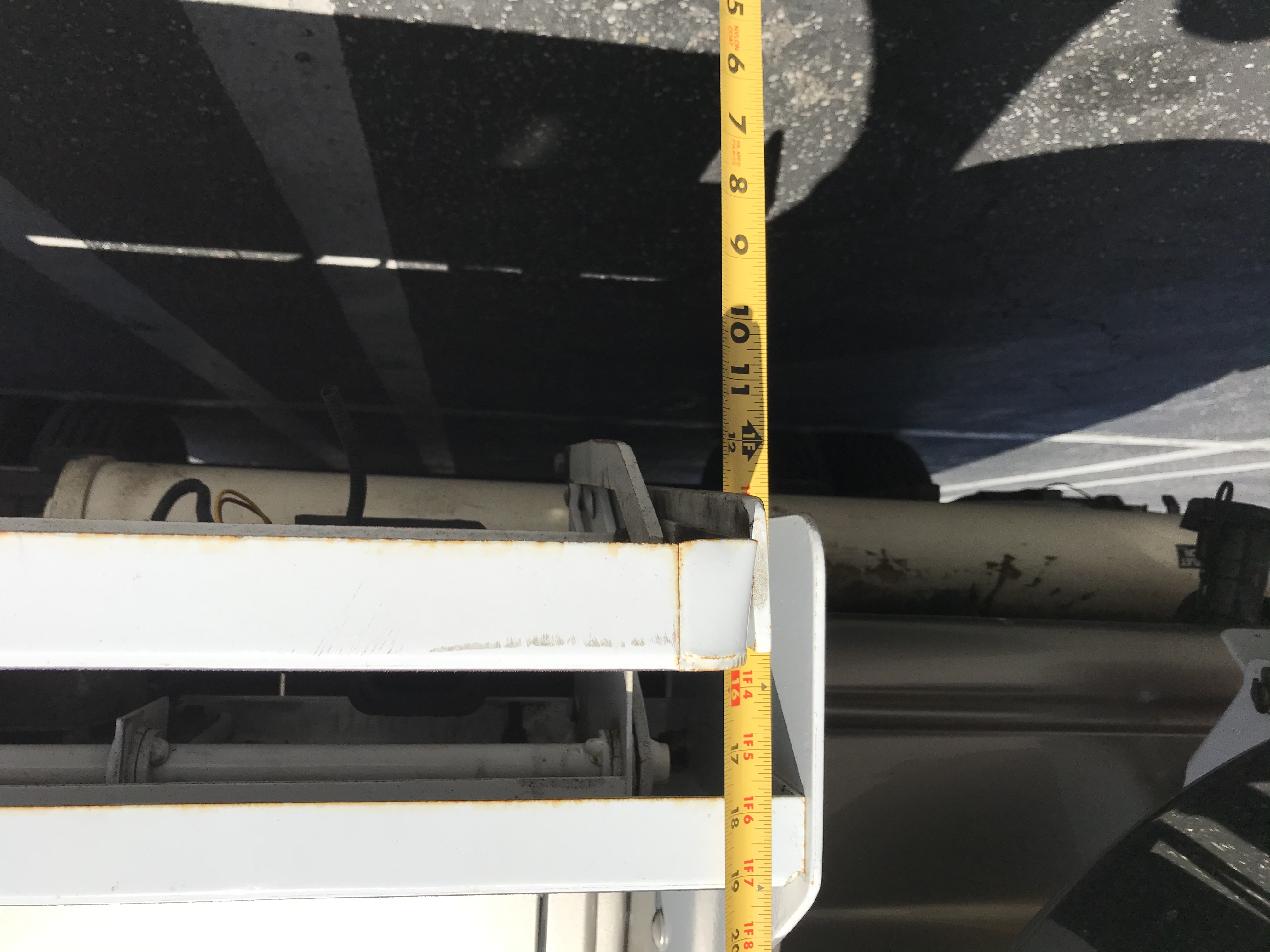

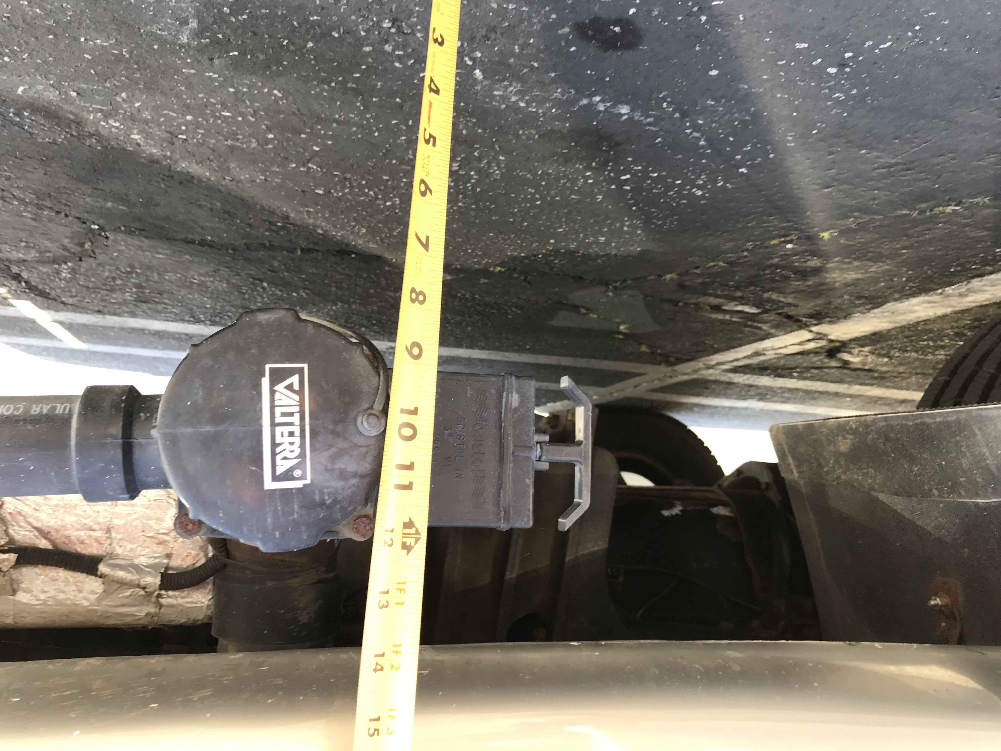

I will follow this reply with a measurement of the dump valve height.
Sorry about the way the photos loaded
Thanks !

Re: How can a LIFT this Chinook rear end
Post by Doug777 »
Again sorry about the photos.
