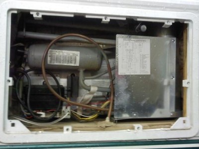

You can tell if the recall was done by looking in the fridge compartment. The new square sheet metal on the right w/decal is the shield installed with the kit. If the flue doesn't have that shield you more than likely need the recall done.

I got the recall done and just for information, the original recall number is #063-76 and the time extension is #08E-032.
Mine is the Model RM-3663, product number 9211440-12, which needed the 3 way kit.
