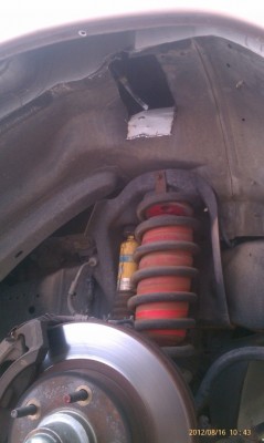

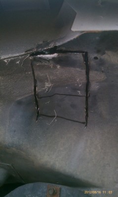

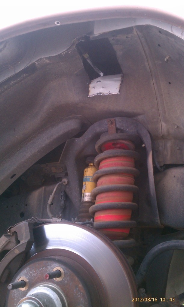

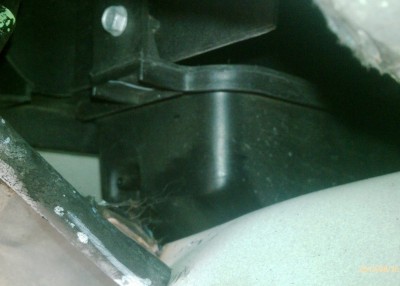

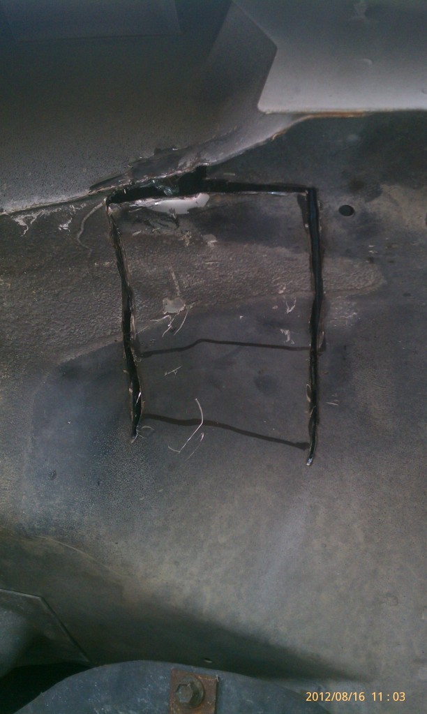

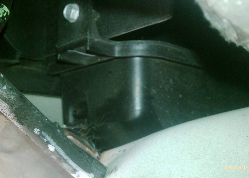

There is another fix which I have done before. You can cut a small access window in the inner fender behind front passenger wheel, which will allow you to access the vacuum valve. You will probably find the vacuum lines have deteriorated from the ethanol in the gasoline. When you are finished you can make a small sheet metal plate to screw over the opening allowing you to gain access anytime you want. I will try to attach a file outlining the procedure.You can probably find the entire repair procedure on the internet.
markatherton
- Posts: 266

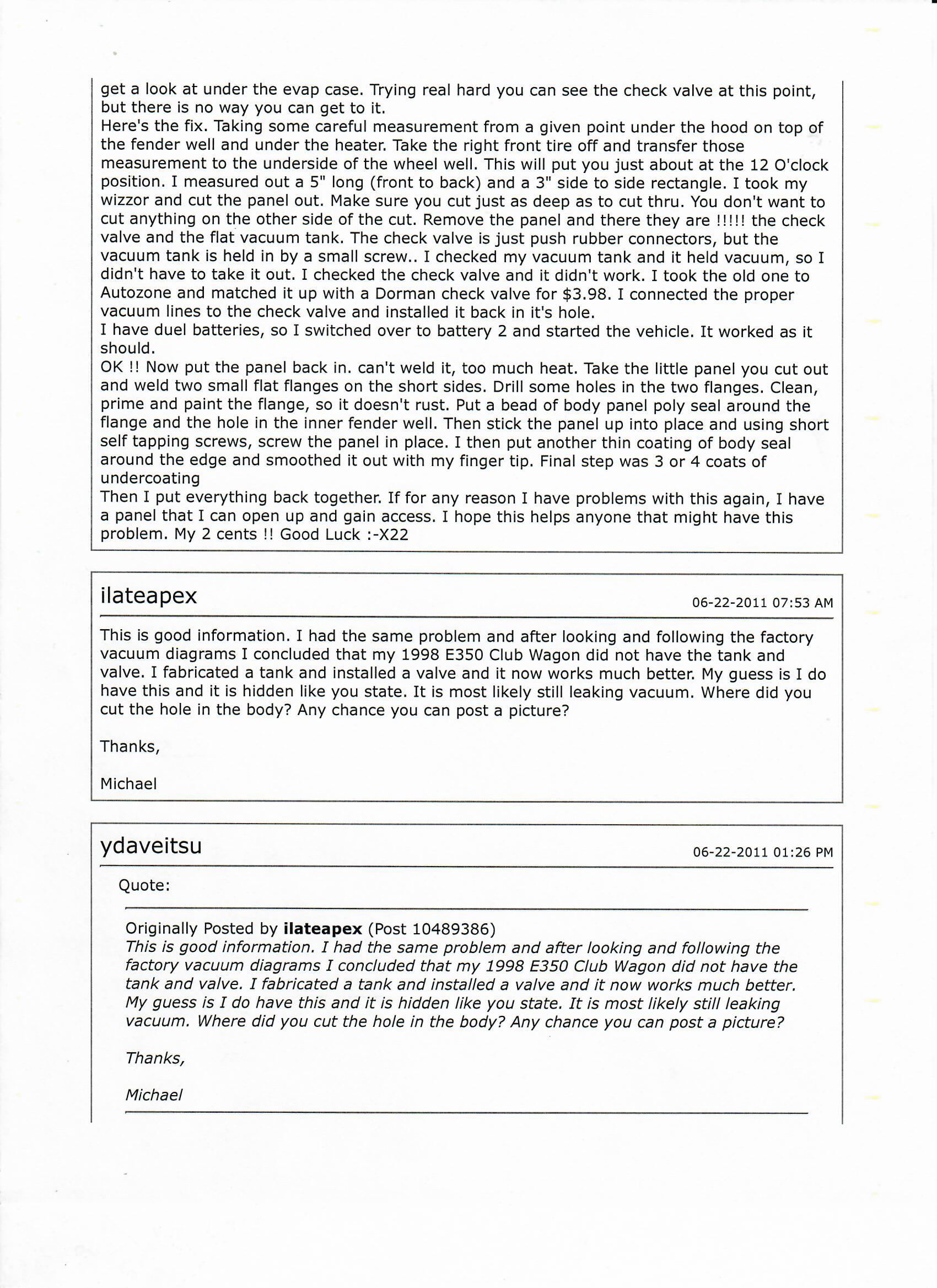

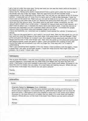

Re: ac quits blowing when going up a hill

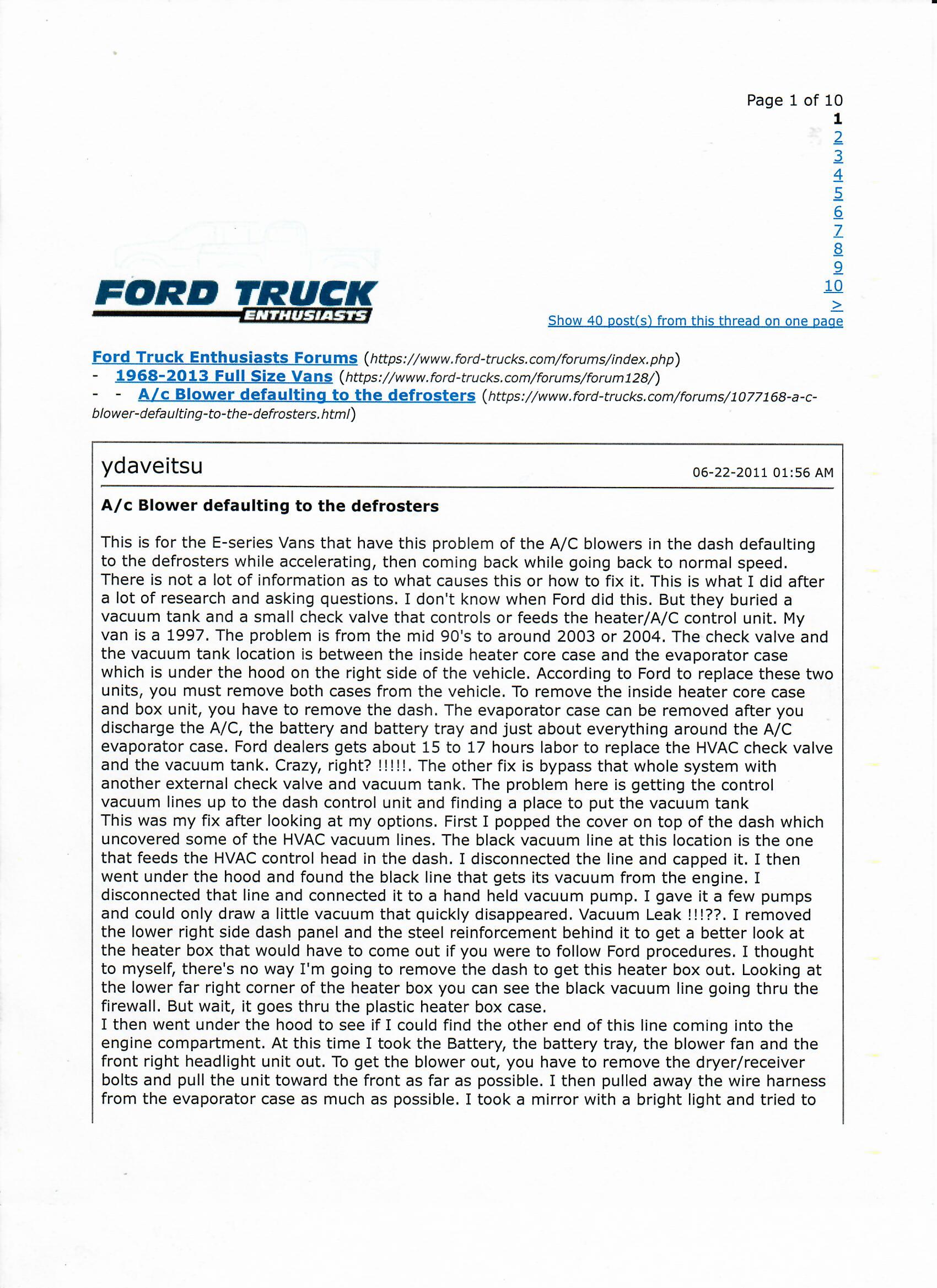

This is the write up that goes along with these pictures
