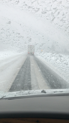

I need new wipers!
This is the rig that almost wiped me out when he ran out of lane and came into mine. I had to brake hard and happy to say my ABS works very well!

That last pic brings back Midwestern memories. Gah. Glad you made it.
