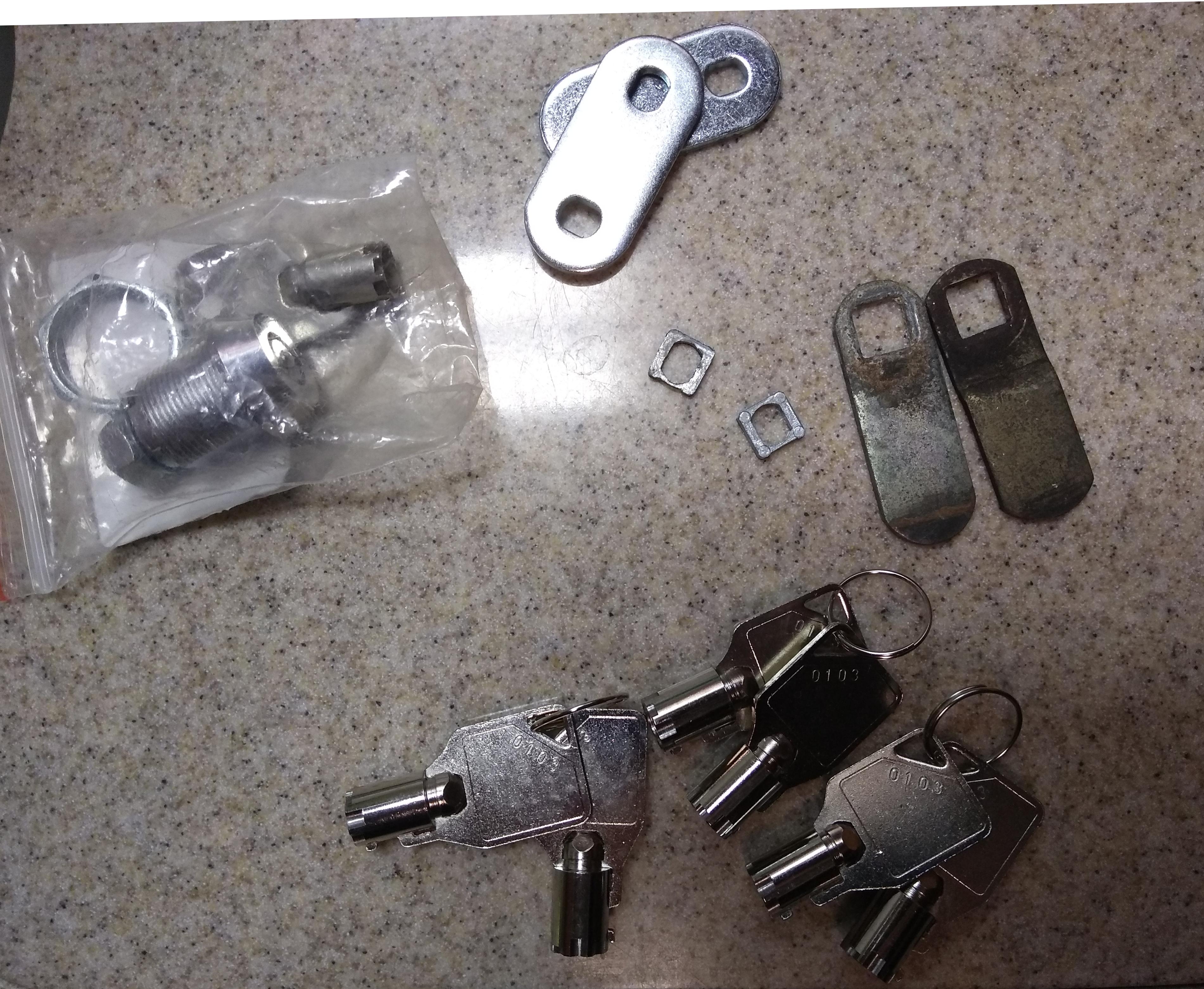

I have 14 of the same key. I pretty much have a set stashed everywhere inside and outside the rig... center console,driver's door, key rack, under the flower pot near the door other keyring, drawer in front of sink, passenger door, heck - might as well throw another in the driver's door, you get the idea. Feast or famine. A pair came with each of the seven new locks. All are the same, perhaps because it is a common cylinder lock key. I'm not sure how common it is, but I didn't find anyone at the RV dealer who had one. Now that I think about it, there were a lot of Bic pens around the office....

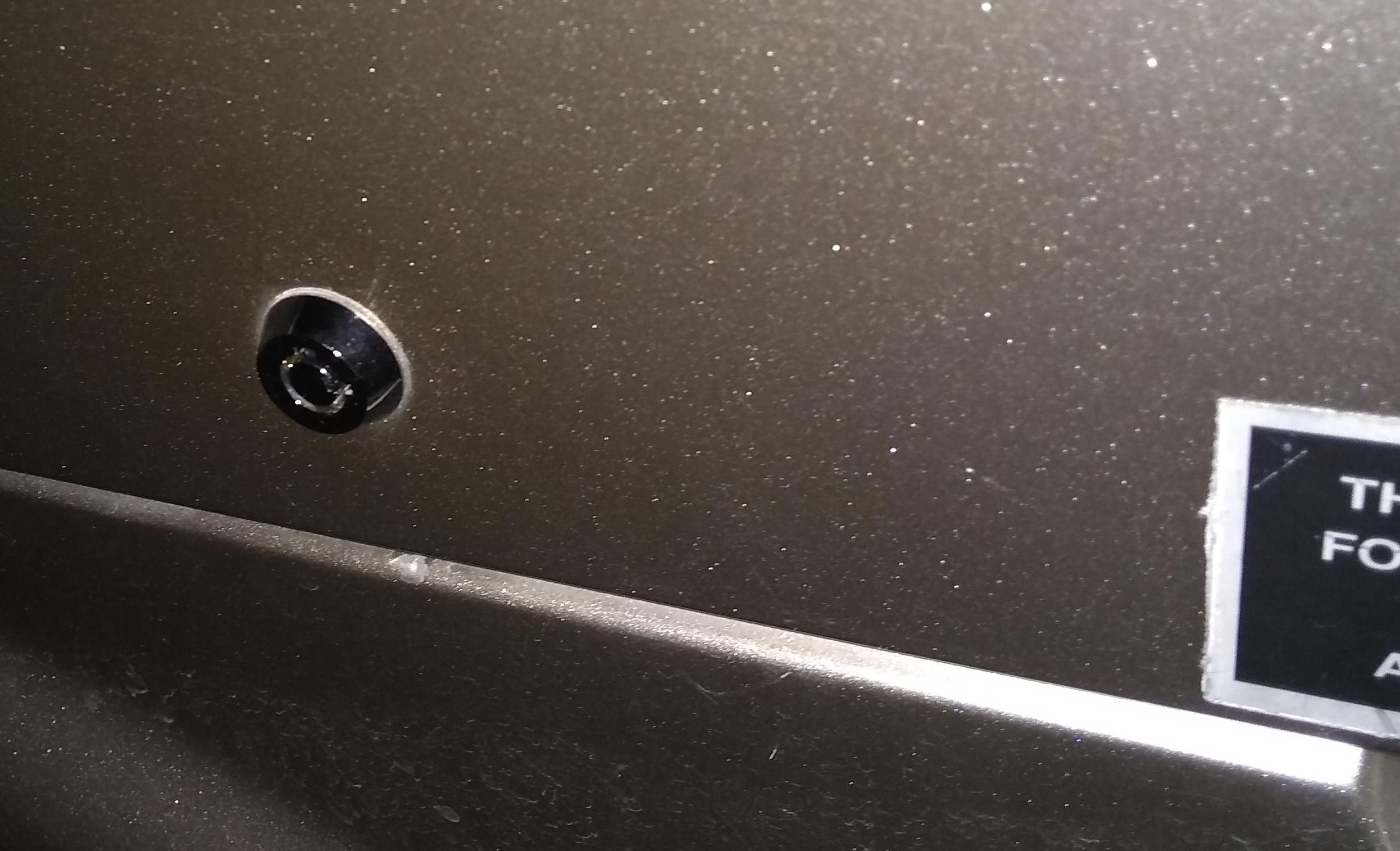

Pictured from 12:00 are the new cams which were too short for what I needed, a couple of old cams which weren't reused - (with the little insert to adapt the square hole to a little oval to fit on the new lock stud), a few sets of key #0103 and the little plastic bag has the original safe lock and only key the rig came with. The other pic is the utilities door - the only one with a single lock and the only one made of metal.
Understanding that these may only help keep an honest man honest or give a man with a CH751 a moment to contemplate, Blue's switch to thumb screws could be argued. The locked doors on my Chinook are the driver's side storage, utilities door with h2o and electical, rear storage and generator.
Note that I had to fiddle with the lock for the safe a bit because I purposely ordered locks which would not retain the key when unlocked. However, I wanted the safe's lock to retain the key due to the fact that the key is used as the "handle" for the small door of the safe. If you get locks which will not retain the key, you can flip the little clip and adjust the key/cam position so that you can get any of those locks to retain the key if desired. If you get locks which retain the key, you'll be required to use two keys each time you want to open any door with more than one lock. Not too convenient and no options with key retaining locks. You can get a non-key retaining lock to retain the key, but you can't get a key retaining lock to release the key.
