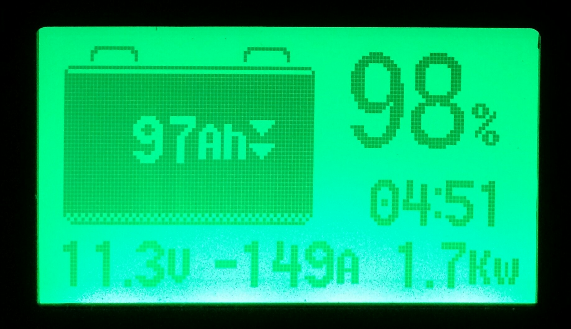

2. My new microwave is 900 cooking watts, so I knew it needed 1.5 times that for power, or about 1350 watts of 120VAC. With inverter inefficiency, that turned out to be 150A continuous draw @11.5V or about 1700W.
3. Most 100Ah batteries only allow max 100A draw. So I went with a 100Ah AGM battery specially designed for high power audio equipment etc... the Kinetik HC-2000 REV. It's a 2000W continuous output battery (166A @ 12V), which was perfect. I'm easily able to run the microwave for five minutes to do popcorn, heat coffee etc.
4. Surprisingly, when my engine was running, the draw dropped to 100A! Apparently even at idle the (130A?) stock alternator was making up the other 50A. Neat! And this has me thinking about replacing it with a 200A output alternator.
