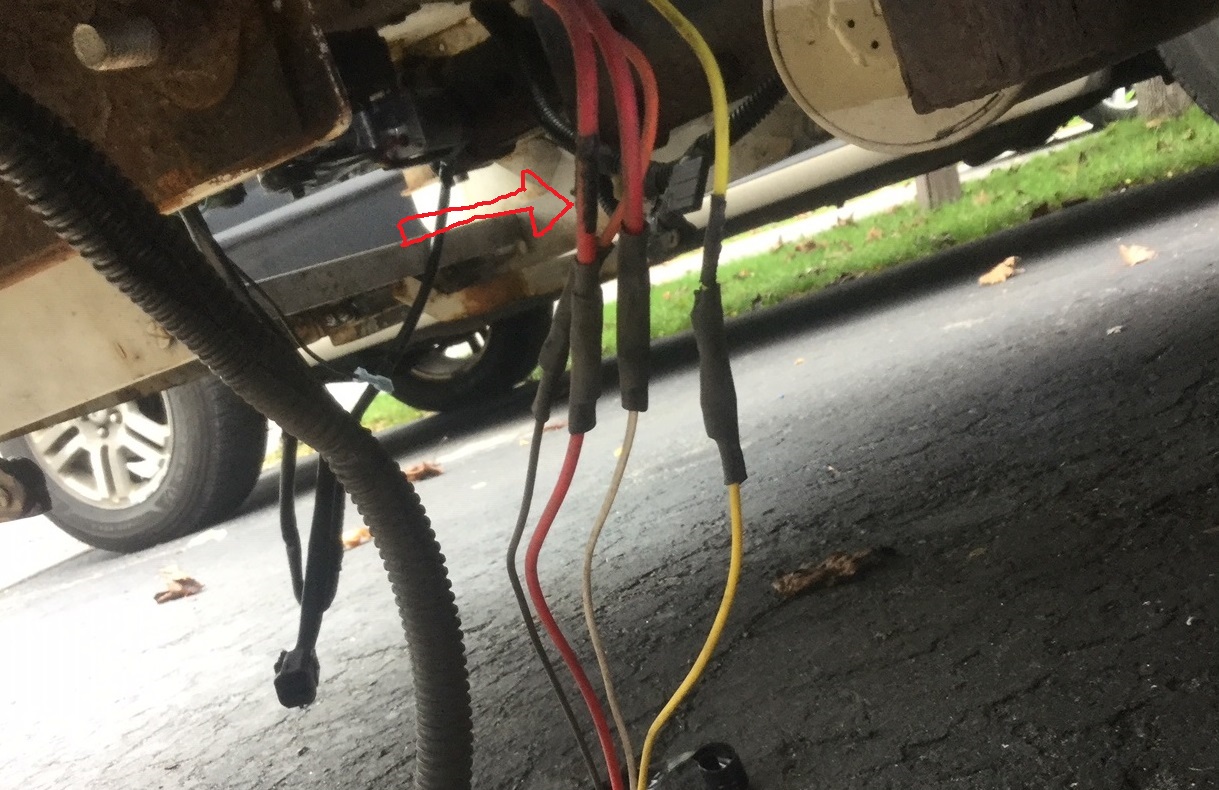

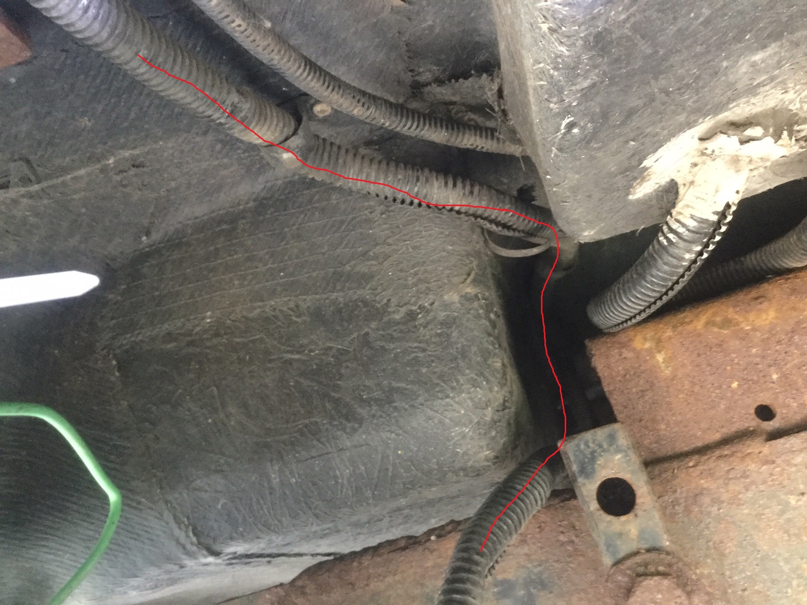

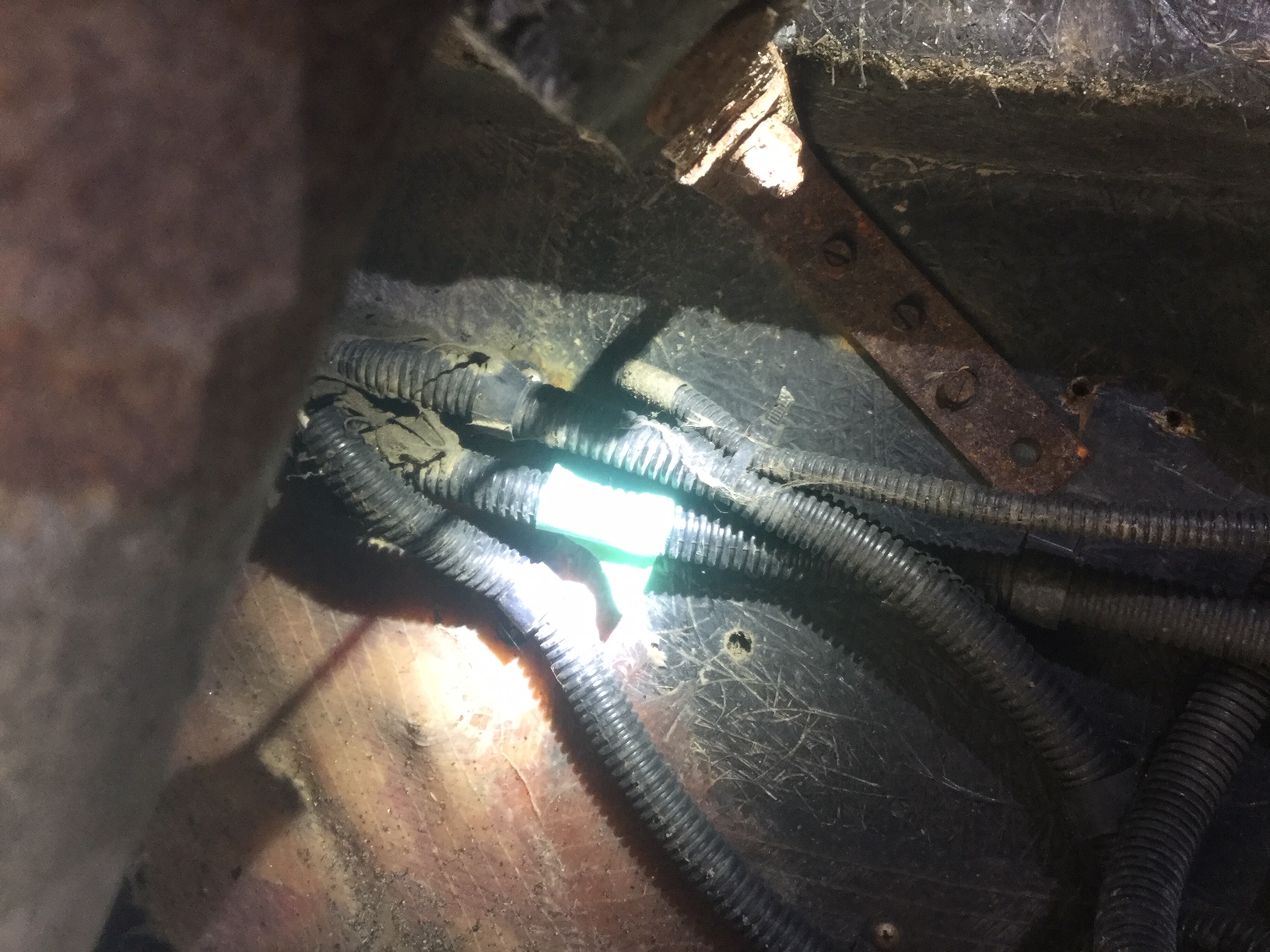

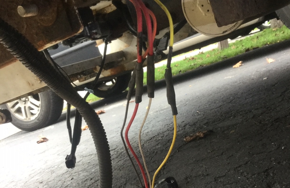

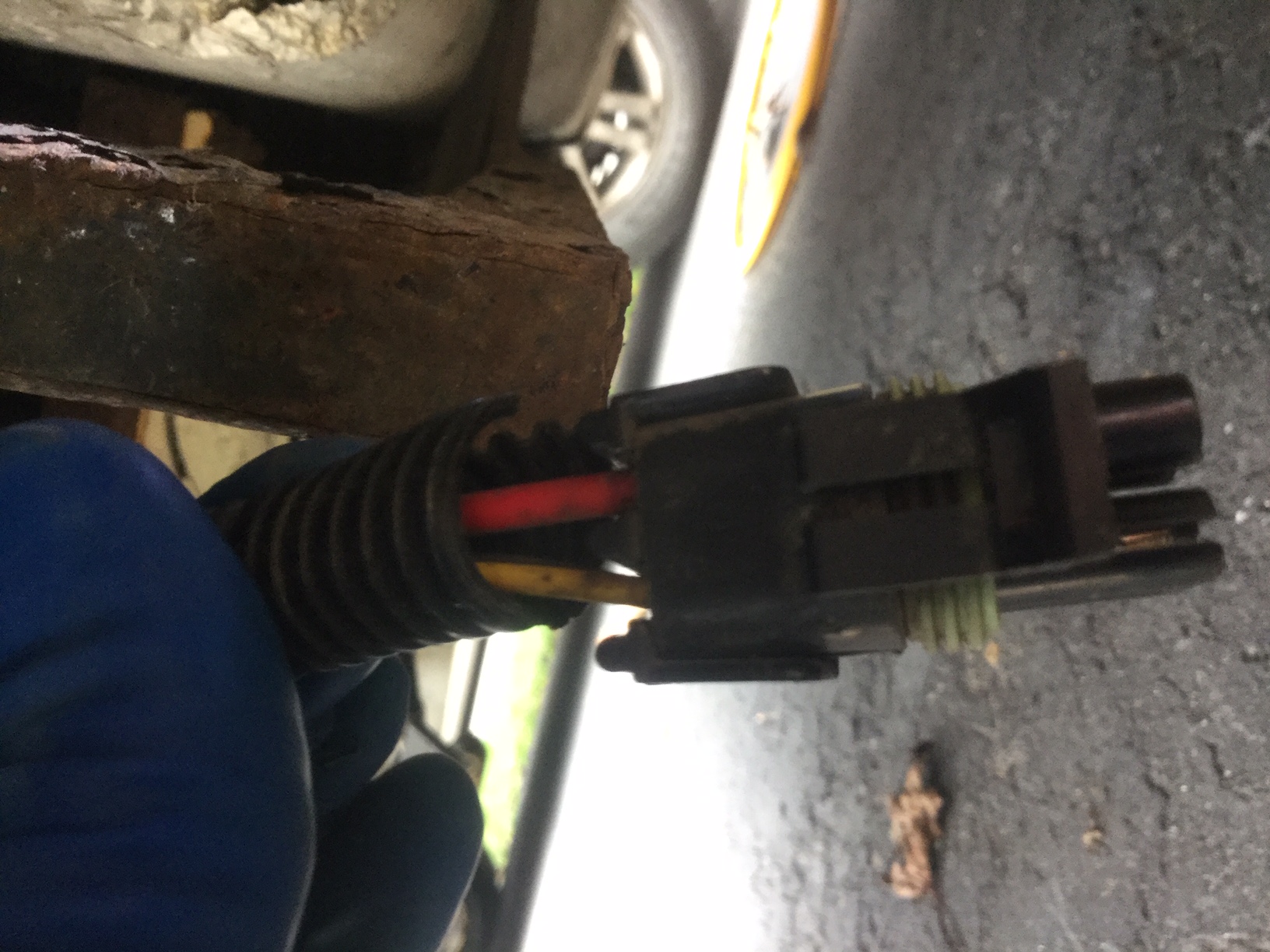

The four pin connector resides at the back corner, rear right or passenger side, below the ladder. They run the wiring up and over a tank towards the driver’s side. EXCEPT, that if you look over the tank, they turned the wire back towards you and up though the wall cavity, just in front of the tail light. I added a piece of green tape so you can see which loom it is that goes up. One photo is the inside cavity through the carbon monoxide detector hole. At this point, the wiring comes up in a few holes and splits in two directions, one behind the microwave and one over the door. Need to determine which wires are which...stay tuned...Dano

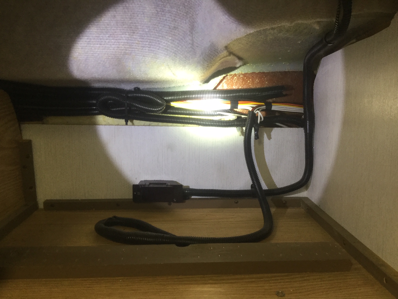

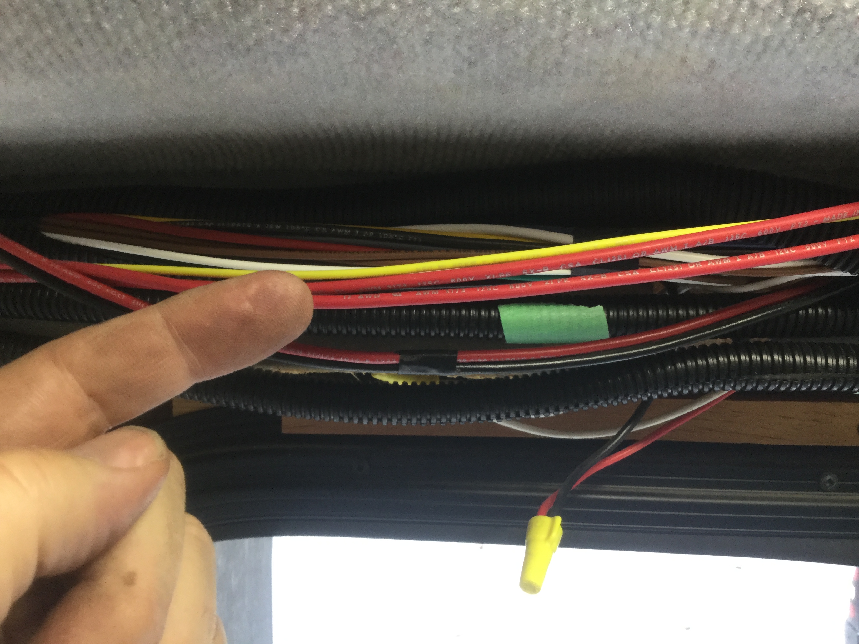

View through the carbon monoxide detector hole and behind the microwave

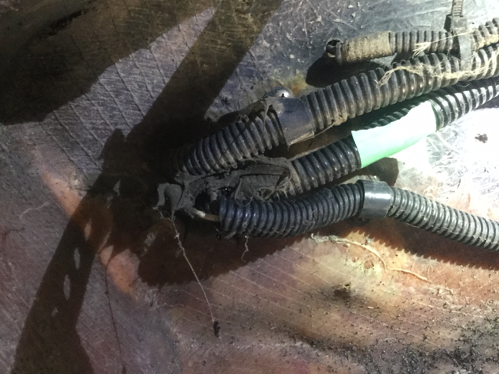

This is EXACTLY why I hate electrical. Anyone looking for an electrical issue, ALWAYS pay attention to factory looms that have all sorts of electrical tape that has been added in the general area of your problem. Cut it away less than a foot from the connector and this is what was there. After looking for a yellow, brow, green and red loom, the actual colours are two red lines, and orange and a yellow! So the red line is red, the other red line is white, the orange line is black and the yellow line is yellow. So, after spending an hour looking for the wrong wires. I have located a run of two red wires taped together with one yellow wire that goes across the top of the door and comes out of the hole in the wall behind the carbon monoxide tester, see image with the arrow. Need to trace this forward to see if it is actually correct or not.....Dano

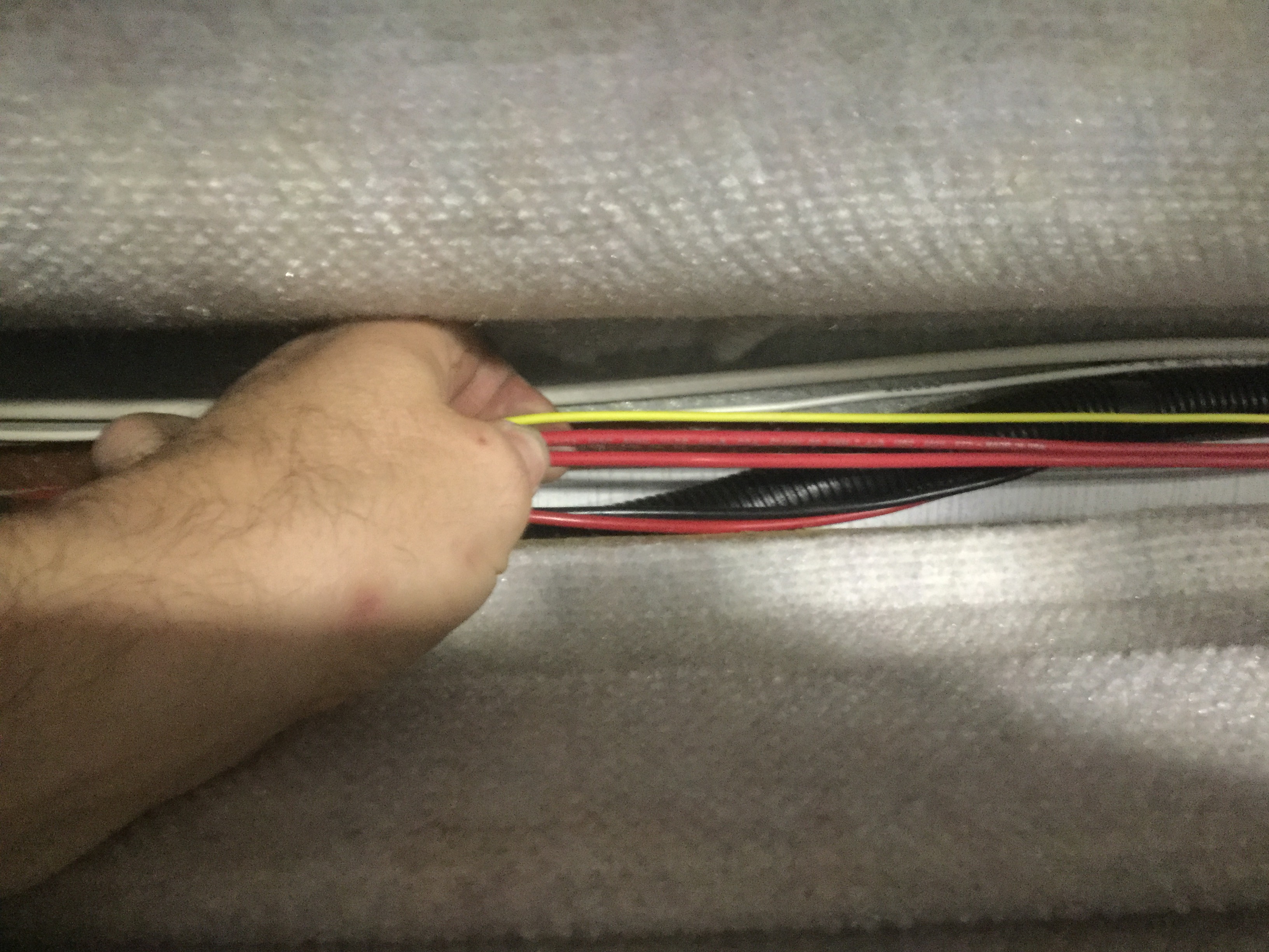

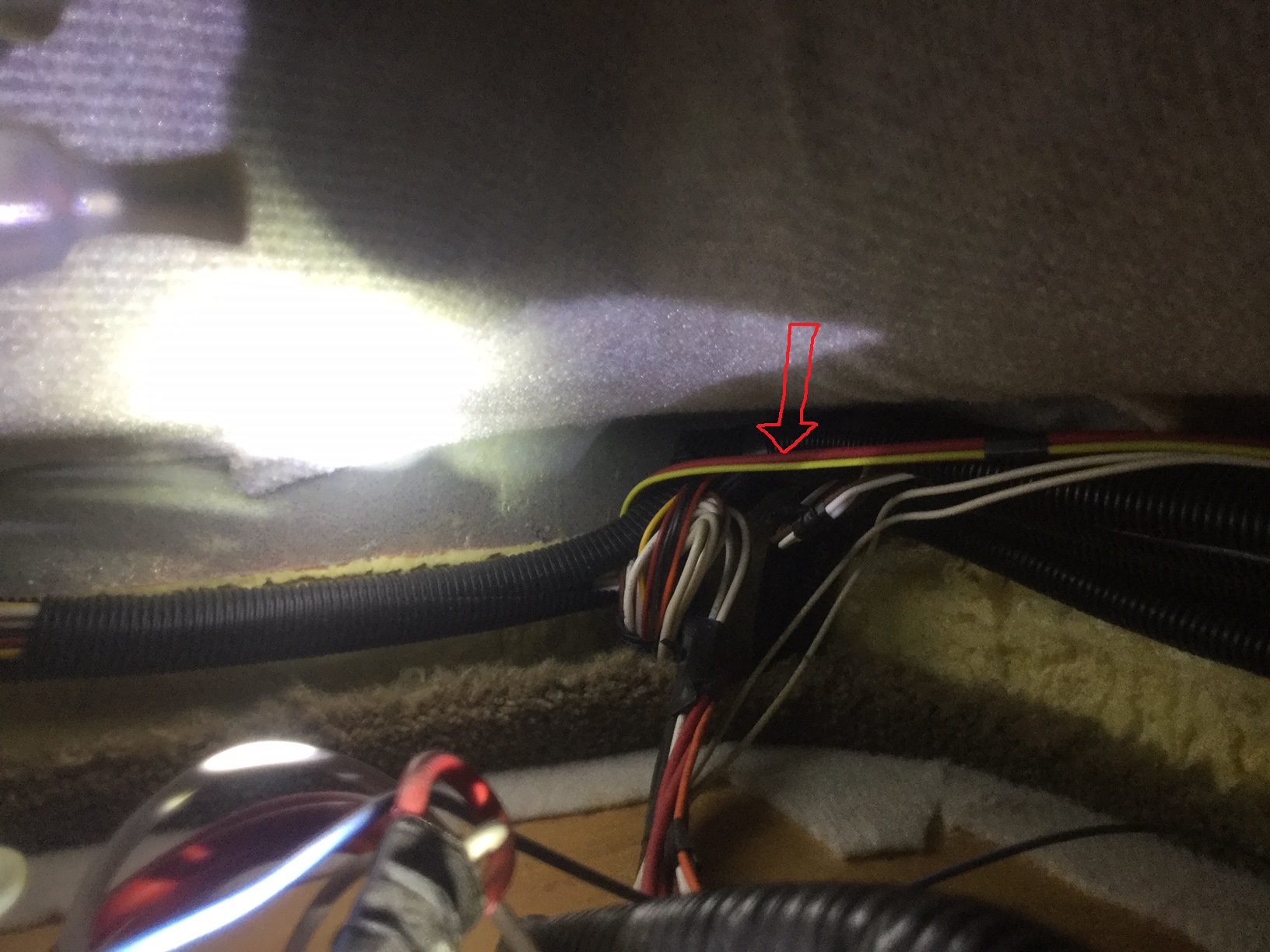

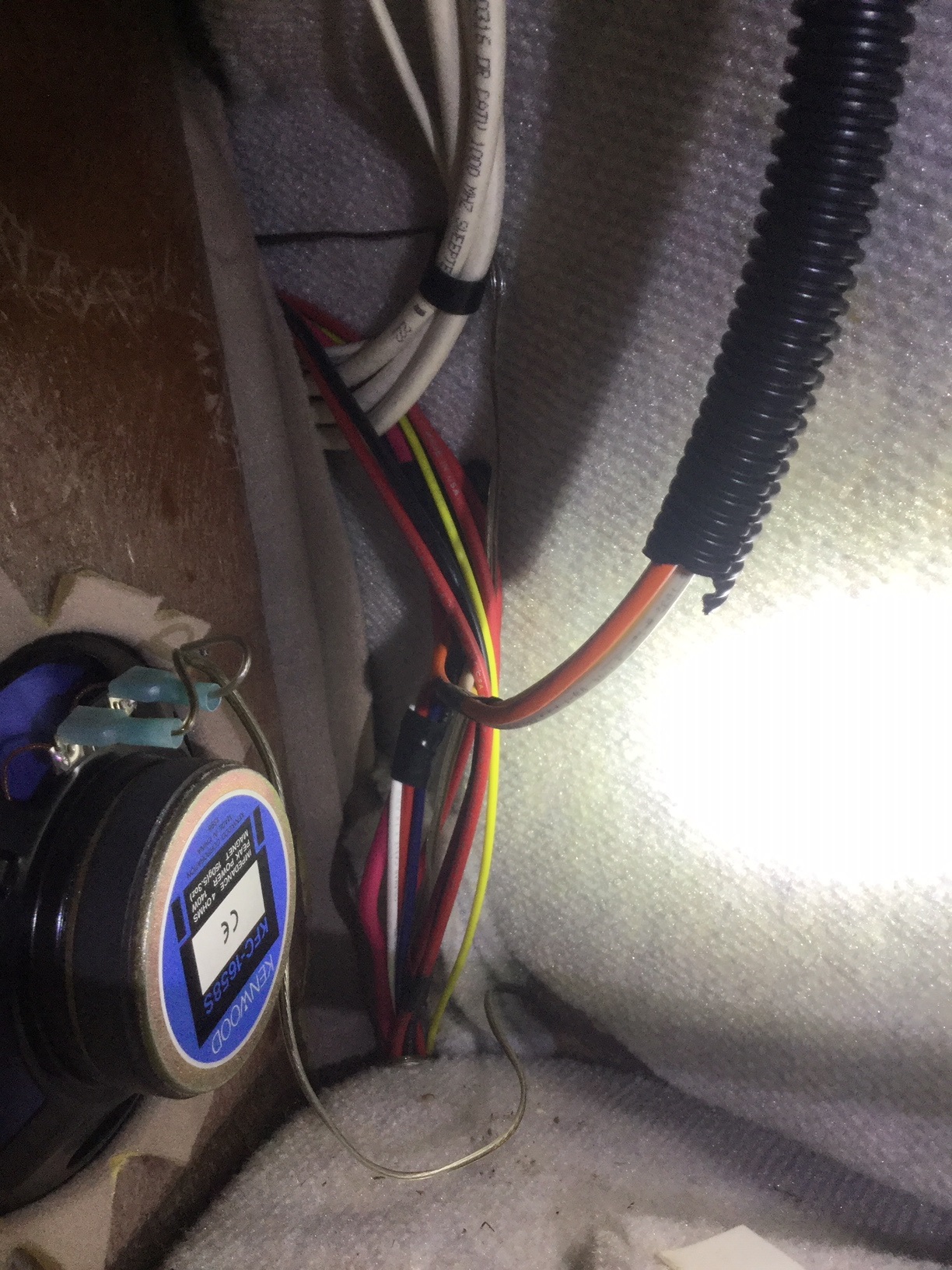

Well, three wires, two red and one yellow over the door go around behind the bathroom I think and come out above the kitchen sink behind the wiring chase and forward to the driver seat area. Need to try and test these lines to see if they do anything. I am going on the assumption they are routed towards the fuses up front and the fact that all 3 wires are taped together in multiple locations and came out of the hole that goes towards the actual connector, they all fit the correct gauge or wire below, no idea if it's right or not but I guess we'll see...
Re: Anyone good with power steps? HELP!

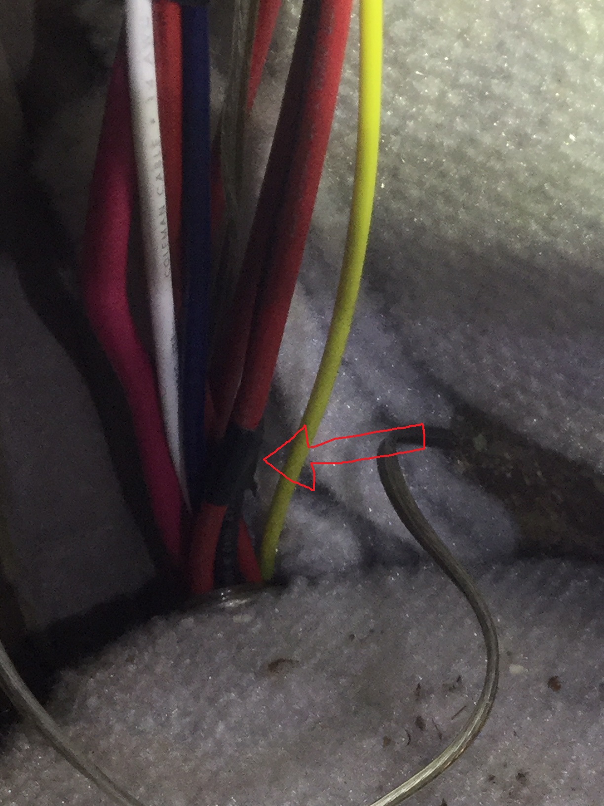

The wires between the overhead chase, behind a panel and come out into the bulkhead over the drivers head, turn right and go down. One good possible indication is that one red wire has a piece of tape on it which matches the piece of tape at the connector at the back suggesting it is the power wire...see photos...I'm sure hoping that lone yellow wire is the one I am looking for...
