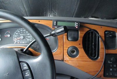

To "install" the Scan Gauge II there are a couple of options:
1) Velcro, somewhere on or around dashboard
a) They give you a piece of Velcro, but I found that the adhesive gives up the ghost in hot weather.
b) I used a couple of pieces of adhesive "Dual Lock" Velcro-like product instead, and that has held up just great through heat/cold/everything.
The cord comes out the side for options 1 and 2, so you can see it. This doesn't bother me, however...
3) The cord can also be led out the back of the gauge (there is a second socket), so if you wanted to drill a hole for it in the dash, the cord could be completely hidden.
Here is mine in place:

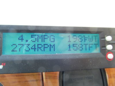

b) Chugging my way up a steep/long mountain pass, while towing, in the Sierra. Really nice to be able to glance over and see that all is okay with the temps, etc. This is after I installed a larger transmission cooler. It was okay before, but I wanted to keep the transmission temperatures even cooler when towing/hot weather.
Here is what it is showing, going clockwise from upper left:
1) Fuel mileage, 4.5 MPG (did I mention it was a really steep grade?)
2) Engine cooling temperature is 198ª
3) Transmission fluid temperature is 158º
4) Engine RPM are 2,734
