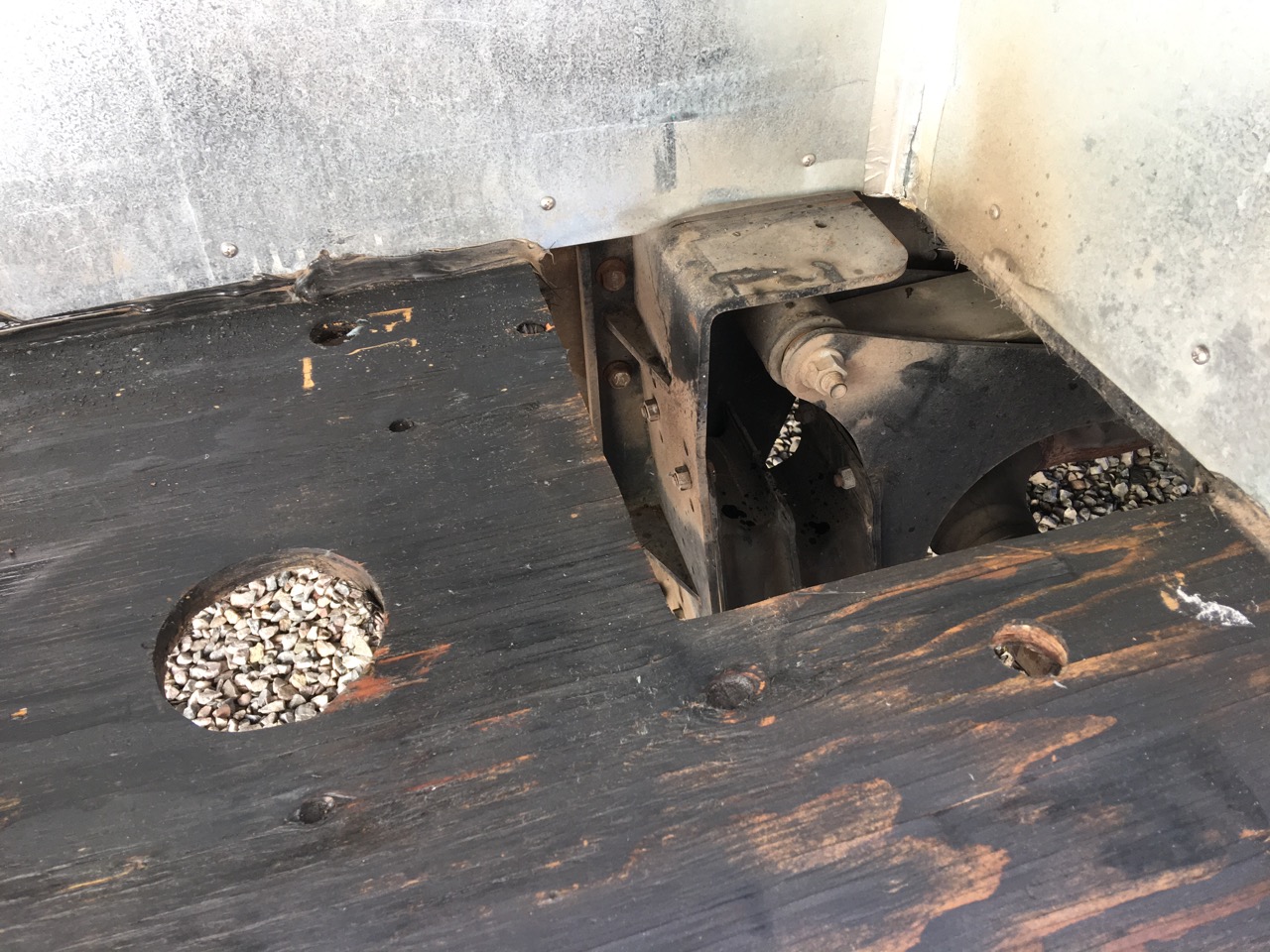

Here I present a quirky solution to sealing the generator cabinet floor effectively. My floorboard was warped with gaping holes, as shown in the first picture. Note the top view of the MorRyde suspension shackle, by the way.
The floor is 34” x 19 1/2” and the door is too narrow to admit a one-piece rigid insert. I chose to tack down a flexible covering consisting of two layers of spare roofing shingles. These covered the gaping holes nicely with a liberal bead of roofing tar as sealant.
The last picture shows the overlay of 1/2” ply board. It is held in place by an interference fit and treated with Thompson’s Water Seal.
Sorry to have diverted from the main battery theme in this thread.
Afterthought: Galvanized sheet metal would be a nicer floor backing material - future project?
