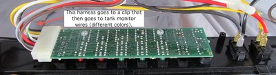

These come in to the left hand side (in the photo and in real life) of the back of the monitor panel (the monitor strip pops out of the range hood). The colors don't match because that's a "harness" coming out of the monitor panel's green circuit board for the tank levels. I have each one marked from before I took it apart (I eliminated it), but either have to dig them out or see if I can find a photo showing which is which. I'll post back if I do.

On the monitor panel (which pops out of the range hood fairly easily), there is a harness coming out of the left (forward) side of the green circuit board on the back. Those are the level wires. The harness colors (provided to Chinook I'm sure) don't match the sensor wire colors, but I do have them labeled or may have a photo (from when I removed it). Will have to find that. If all else fails I have the monitor panel in storage with the wire splices still on it showing which colors join to which.
Another way to see that is that if you pop the monitor display section out (about 2" x 20" panel), then pull it out a little bit you'll see that wiring harness on the left that I show with the arrow. I think if you gently pull that out a bit you'll be able to see where Chinook spliced their wires on and thus figure out which color goes where. You may not need that info, but if you do.
