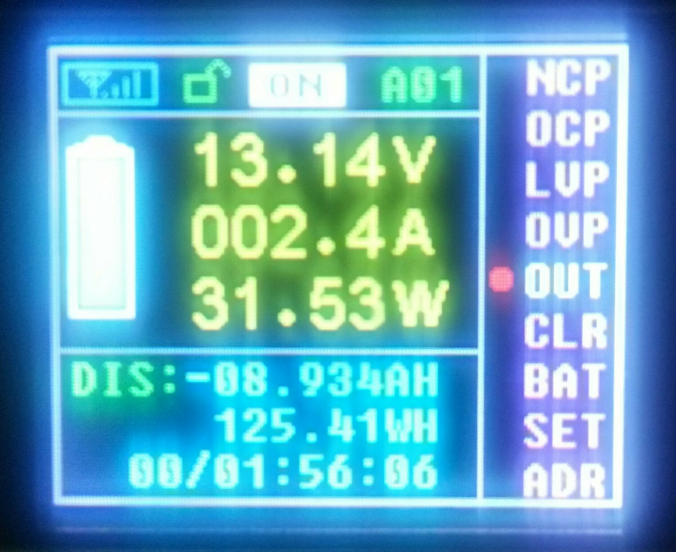

Here's a blurry shot with shore power turned on, charging the battery. I had gone inside to watch TV, and so after about one hour and fifty-four minutes (1:54), the converter/charger had given the battery almost 9 amp hours of juice:
My Progressive Dynamics charger puts out 13.6v from its location back near the fridge area, so I apparently lose .02v on the way forward. Hmm. Seems too little. Will need to check with another meter.
Now a couple of minutes later with the shore power turned off, running the Fantastic fan from the house battery. The accumulated AH and WH will start to tick down now that the battery is being discharged:
The values update once a second, so you have a constant running total of the amp and watt hours that have gone in or out of the battery.
I'll have to get used to positive numbers and green == discharge, with negative and red meaning charge, but hey, for $25 I can do that :)
You can set the amp hour rating of the battery and other parameters, so I just need to get it fully charged and then set that as the full 60AH point in my case. You can even hook up a relay for it to disconnect the battery load if it falls below a custom voltage (LVD).
