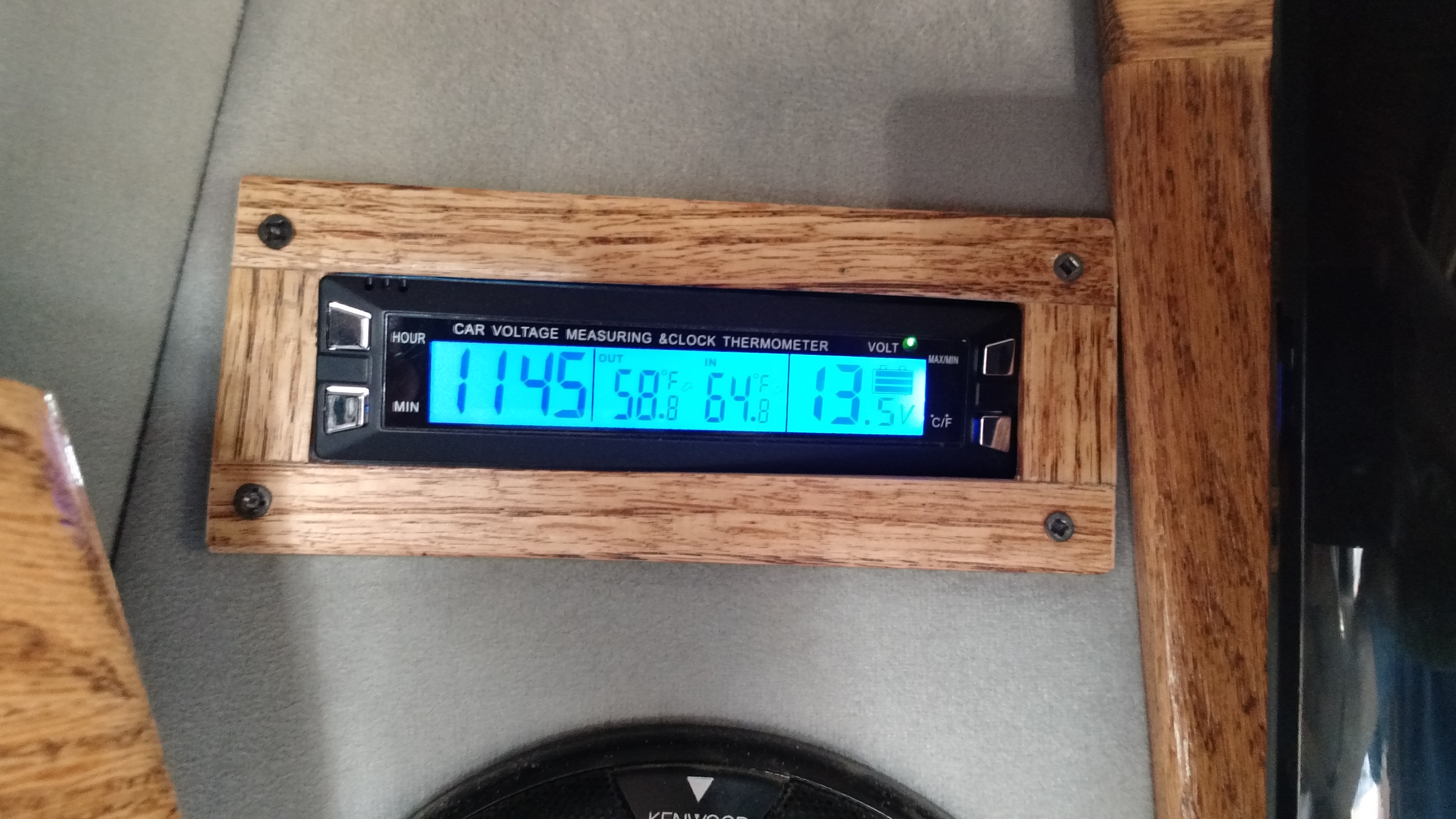

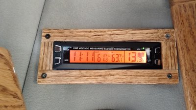

My latest project was adding an indoor/outdoor thermometer with a clock and battery voltage readout left of the TV where the old sound control panel used to be. The outdoor temperature uses the old telephone wire to the outside compartment for the outdoor sensor.
Well this just goes to show that there is often a "nugget" even in a thread that you'd think wouldn't apply. I was reading along just because I find it interesting to see how people do things; but since I don't watch TV figured I'd just be a bystander of sorts. But now you've piqued my interest. You used the old telephone wire for an outdoor sensor? I want to know more!
(I do use a wireless indoor/outdoor thermometer, but wouldn't mind also having a wired one. Plus it just sounds interestingly clever!)
Here is the part:
Innovic EC30 Multifunctional 4 in 1 Car Digital Clock, In/Out Thermometer, Voltage Monitor
https://www.amazon.com/gp/product/B005F ... UTF8&psc=1
It looks like it is now out of stock at Amazon, but I paid about $17 for it. It comes with a wired outside temperature sensor with the wire about 6 feet long. I took an old phone cord with RJ11 connectors, and cut off a few inches on each end. I cut off the temperature sensor wire about a foot from the sensor (so I would have a short pigtail in the external compartment). Then I soldered the bare ends of the sensor cable to a pair in the phone cord stubs. It is very small wire, but can be soldered with care and some shrink tube. I now had the sensor cable separated into two segments with regular phone jacks spliced on. I actually cut the phone cord in the cabin and moved the jack to the corner of the overhead behind the TV. The original location for the jack was under the VHS player. Then I plugged the thermometer cable into the phone jack in the cabinet, and plugged the short sensor cable into the phone jack in the external compartment (next to the outdoor shower). The sensor had adhesive tape to hold it to the inside wall of the compartment.
Finally I cut off the 12v power plug from the main unit and crimped on some terminals, which I spliced to the 12V TV power supply wires (in parallel with the TV feed). This provides the battery voltage readout supply as well as power to the LCD display backlight. This is potentially a parasite load, but it only draws a fraction of a milliamp. I made it so I could unplug it from the power cord if I didn't want it connected. I actually leave it on all the time anyway. The backlight is selectable between blue or orange, and I found you can position the switch in the middle so that the backlight turns off, which is a good unadvertised feature. I made a nice little oak frame, with a downslope angle for a proper viewing angle. It is mounted cock-eyed in the frame so you can see it from across the coach and access the switch on the left side.
