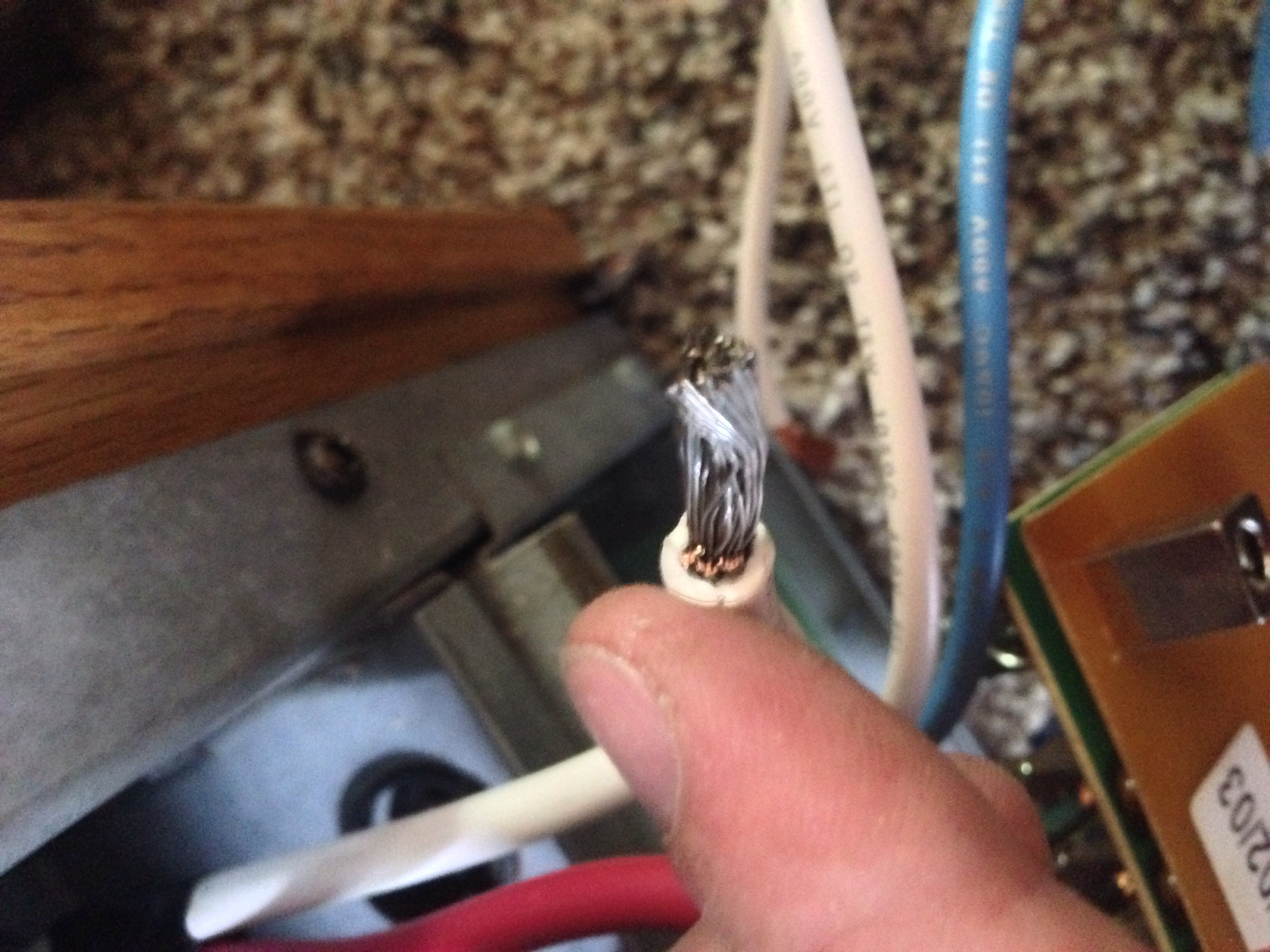

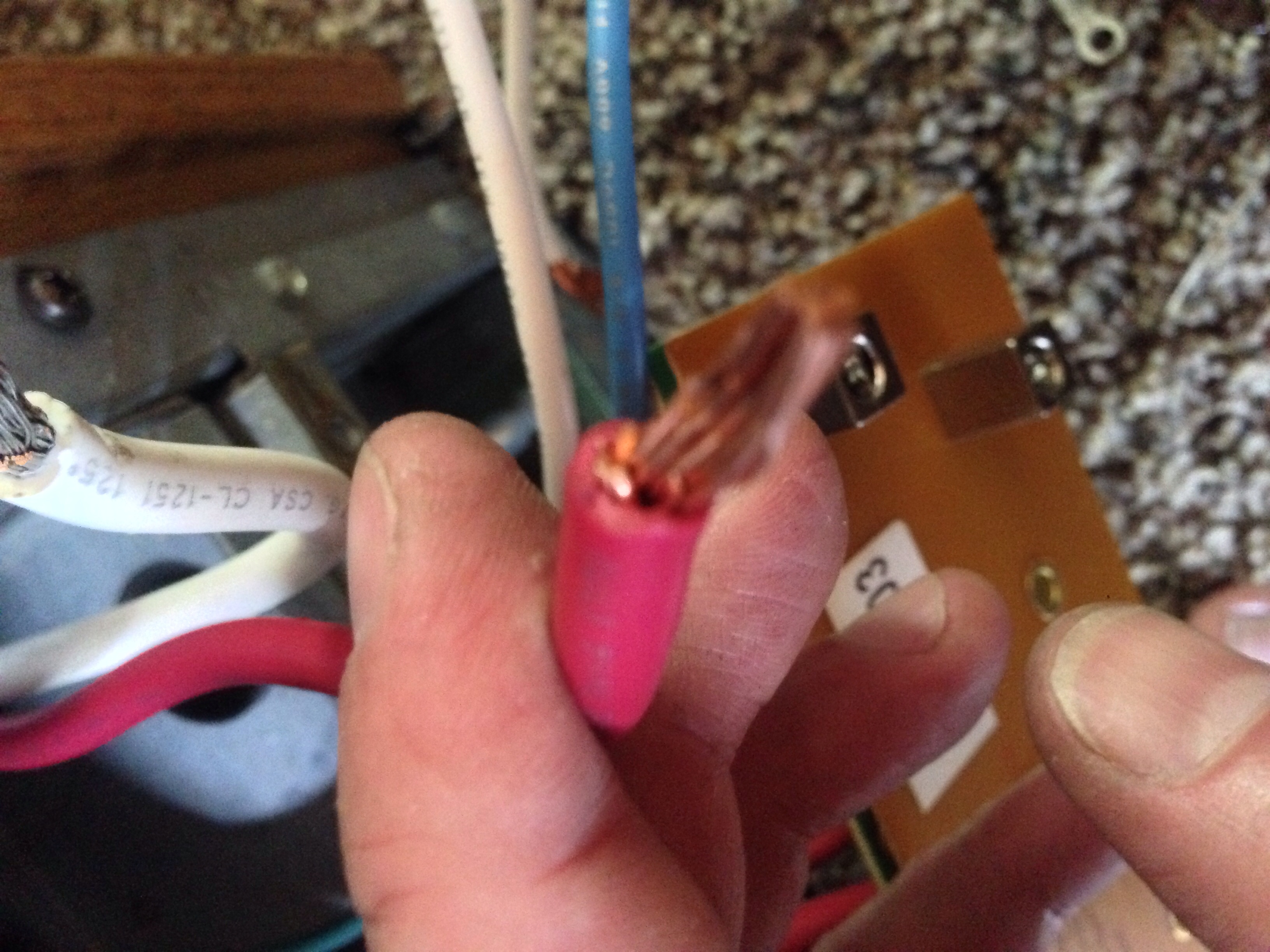

One disturbing thing I found was that the DC wires were only partially installed on the old DC block (see pic for "snipped" wires). Since I upgraded to 55 amp's vs 45amps against the recommendations (they are concerned with wire sizes), I wanted the best connections possible. I had to get more slack by removing the drawer above the power center and adjusting some of the cable management. Then strip a little fresh wire and use that. Not a huge deal, but all in all this replacement took me about 3hrs. This includes finding all the right tools and putting everything away. Actual work time is probably only an hour.
