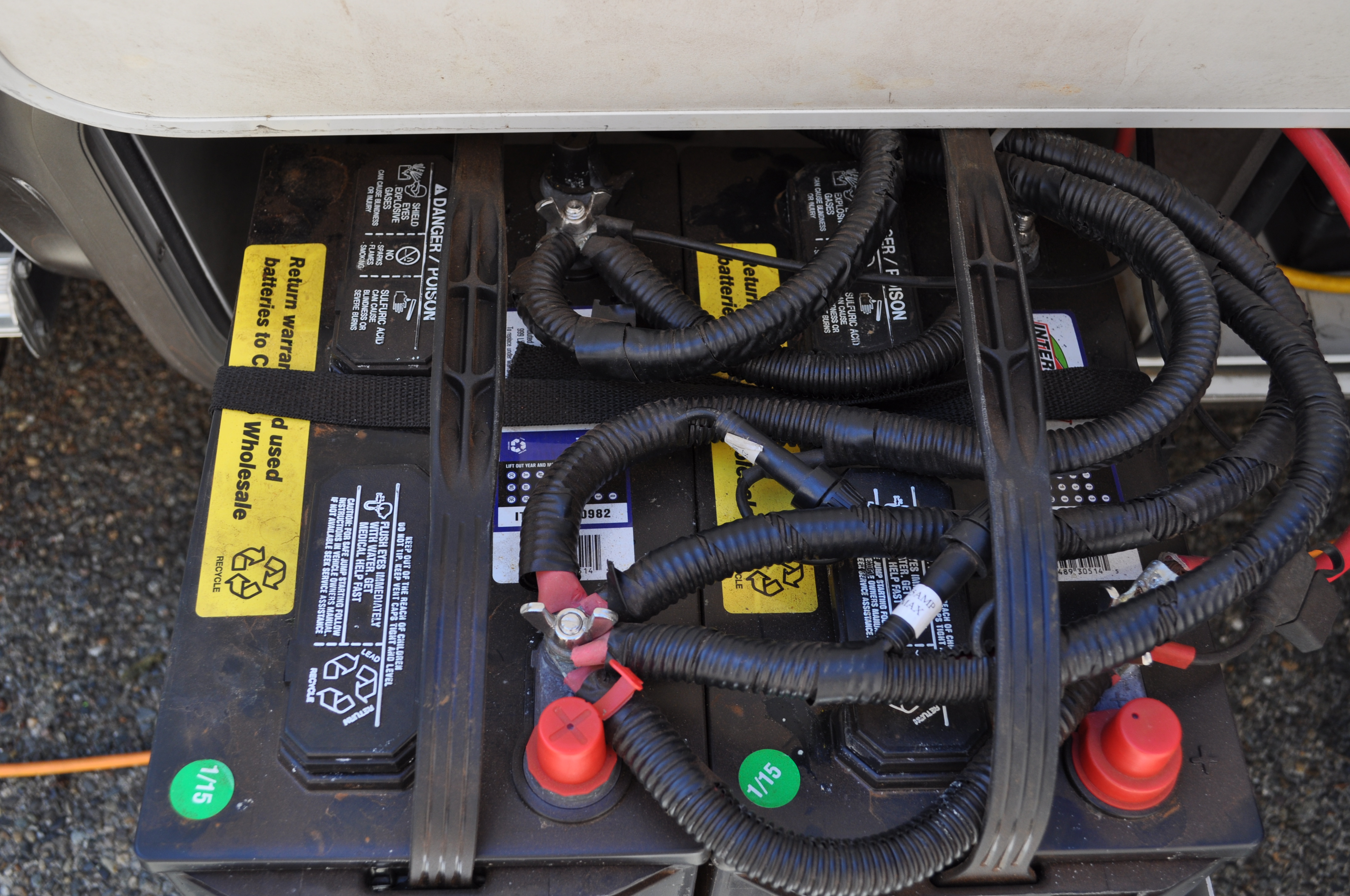

Thanks for the quick reply BG. To clarify I am referring to the two house batteries. The start battery is functioning normal. I'll try to get a picture in the next few days of my wiring. (I'm tied up Monday and Tuesday.) I supposed the Battery Tender leads could be wired wrong although my BT Junior worked fine. I watched the "BT Plus" for quite a while after attaching it without the alternating flashing LED's. For now I can go back to my cheap but reliable BT.

The fused side of the BT connection is on the positive so absent of some other issue it should be correct.

It certainly does look like you have the BT hooked up correctly. So .....? How was the water level (if checkable)? What was the battery(s) voltage when you hooked it up? I wonder if something that didn't have to do with the battery tender could have brought them down (coincidentally).
I've never hooked a charger up to the "opposite" posts from the ones that lead to the bus bars (the crowded ones in your case), but I can't think why it would make a difference to go the other way. (However, coffee is now being consumed, so maybe I'll think of something.)
A couple of suggestions for your bank:
1) An appropriate fuse on the positive post or very nearby (can't see if there is one).
2) Bus bars. Then you can eliminate that giant mess of cables going to the battery posts.
3) Eliminate wing nuts. They can't be tightened correctly (just use regular washer/lockwasher/nut, or serrated flange nuts).
