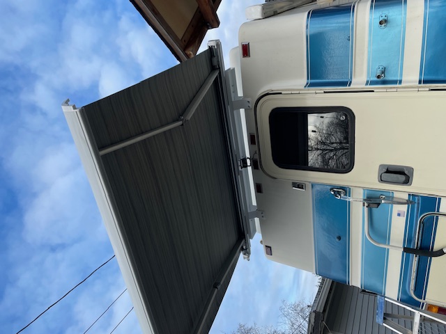

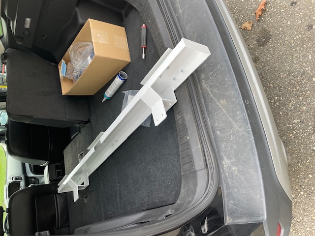

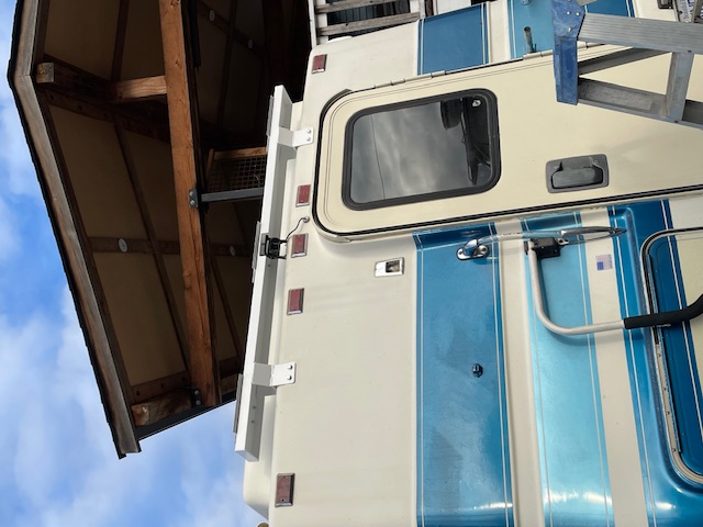

i really wanted a rear awning so i had to ditch the factory ladder and build a custom bracket for the fiamma awning

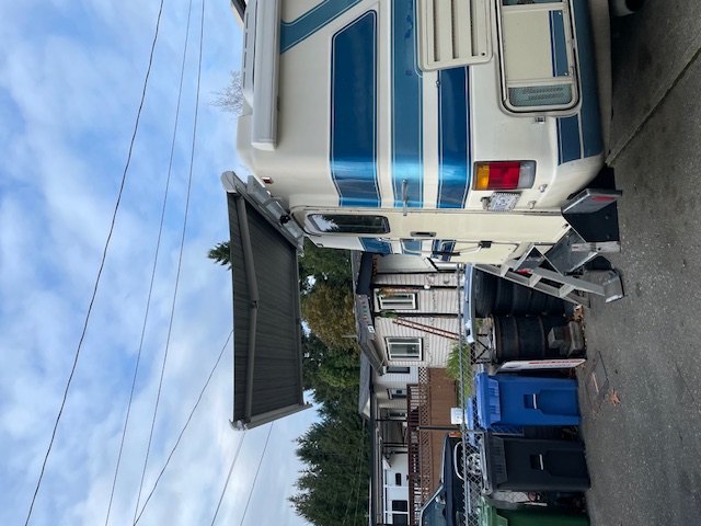

deployed, this awning will stretch out 5' and has no arms,

hey 68, i was faced with a dilemma when i considered mounting styles i really did not like the options of access holes in the shower so i decided to try rivnuts (8mm) really happy how they bit into the fiberglass then used 5200 sikaflex bonding the bracket to the coach (treated it like one of my boats) the fiberglass is about 1/4" thick there and two bolts top and on the vertical face in two locations. so fairly stout

i have to say this is a great addition to the rv, while i have been working in the coach is has been great at keeping the door area dry, even replaced the rear door in a rain storm and was nice and dry
