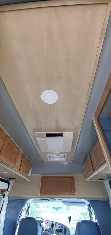

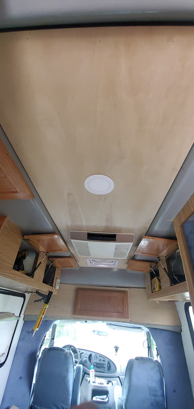

6. Removed the ceiling lights and replaced them with puck lights, as well as removed the upper cabinet lights and replaced them with puck lights.
7. Ran new wiring for said puck lights. as well as adding two outlets to the storage cabinet over the cab (Plan to have computer equipment up there)
8. Shimmed the ceiling down (only way to make the puck lights work and it overall much better.

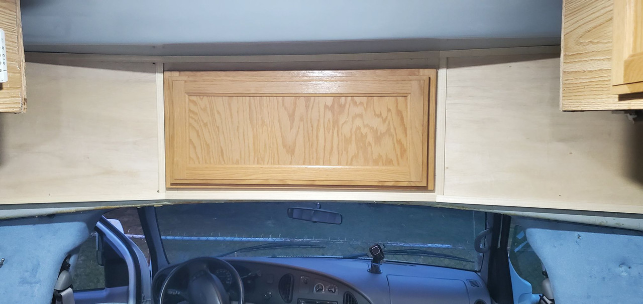

9. Added Wood to the storage over the cab (Better for mounting certain things, also looks better)
10. Added trim to all the cabinets and modifications as well as the shimmed down ceiling.

I can't wait to see final pictures. I like the added wood which gives more open feeling than colored carpet.
