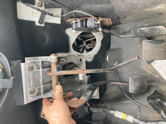

So the project is underway to convert to 4x4 and cummins power and a manual transmission, two of the big hurdles were clutch master linkage and of course the rear axle, so after hours cruising ebay for ford clutch brake pedals i found the ranger kept the master on the clutch side of the pedals and not transfer over to the throttle side were there is no room, and the dodge master is a square hole design as well just a little bigger,

i don't know why the pictures are not the same way as they are in my computer

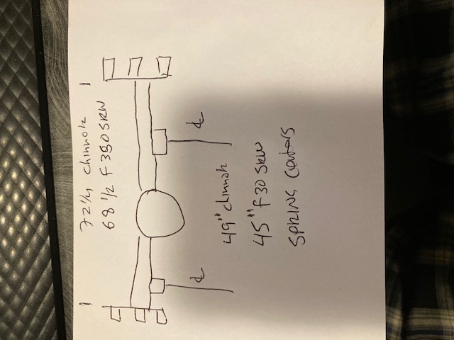

here is a diagram

so i move my spring perchs 2" per side add my adaptors and bolt it in
JabberBox
Post by JabberBox »
And you say its a sterling axle not a Dana80? If its a sterling it came out of a 3/4 ton F-250 versus the 1 ton F-350 which used the Dana80 up until at least 2017. Did you get around to measuring the width of the backing plates to insure it will fit between the springs?
