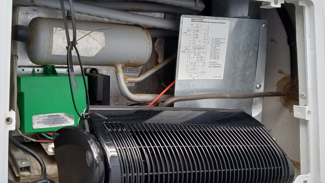

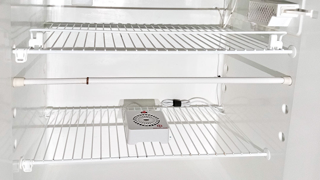

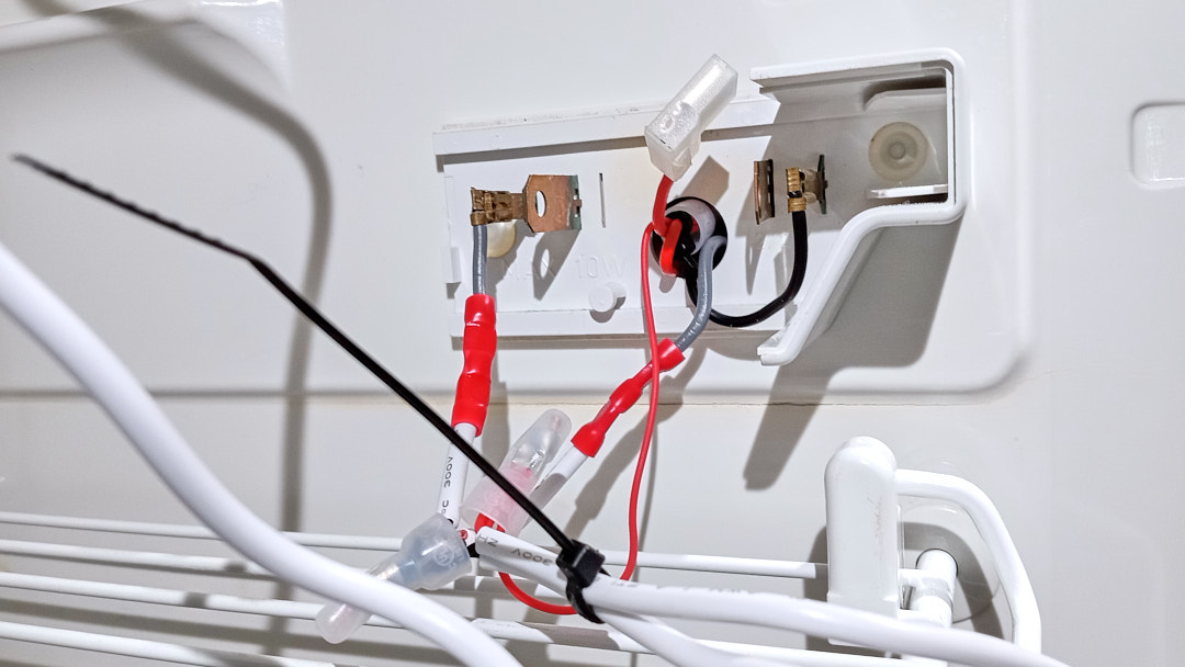

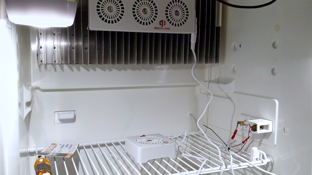

Here are some additional images of the installation that was completed.
Regards!

Once again David thank you for the reply, I recently had the opportunity to contact JC Refrigeration regarding my RV refrigerator's cooling issues, and I must say, their service was impressive. From the moment I reached out to them, they were incredibly helpful and knowledgeable.
During my conversation with one of their technicians, I inquired about the installation of external ventilation fans for my refrigerator. The technician informed me that they could connect the fans directly to the 12 Volts from the battery, providing an effective cooling solution. However, I expressed my concern about the lack of an in-line fuse to protect the circuit and the fans in case of any malfunctions. Surprisingly, the technician agreed with my observation and suggested an alternative approach.
Upon contacting Dinosaur Electronics for further clarification, I received confirmation that my proposed idea of utilizing the 12 volts power from the Dinosaur MICRO P-711 Dometic Refrigerator Board (J2) was indeed feasible. This consensus between JC Refrigeration and Dinosaur Electronics instilled confidence in me regarding the solution I had in mind.

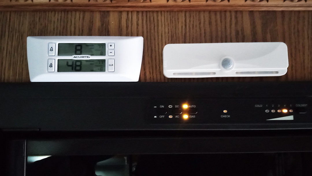

To put the theory to the test, I decided to assess the effectiveness of the internal fans I installed in refrigerator. These fans are designed to circulate air within the refrigerator, contributing to temperature regulation and ensuring a more uniform distribution of cold air. At 12:00 PM, I switched on the refrigerator using propane, and at that time, the internal temperatures stood at 77 degrees Fahrenheit.
After two hours of operation at a setting of 4, I measured the temperatures in the freezer and refrigerator compartments. The freezer reached around 47 degrees, while the refrigerator showed a temperature of approximately 61 degrees. Admittedly, I did not capture the readings with my Remote Digital Wireless Fridge and Freezer Thermometer, as I was already contemplating the addition of external fans.
Curious to see if the installation of external fans would yield any improvements, I connected an oscillating fan to the back of the fridge and rechecked the temperatures at 7:00 PM. To my amazement, the freezer temperature dropped from 47 to 8 degrees, and the refrigerator temperature decreased from 61 to 48 degrees (images available below). Although this experiment lasted only 5 to 7 hours instead of a full day, the results indicated that my refrigeration goals could be met with the help of external fans.
Based on this small test, it is clear that both internal and external fans contribute significantly to maximizing the efficiency of my over 20-year-old refrigerator. Therefore, I have decided to proceed with purchasing the external fans this week. I intend to provide an update after their installation to share the overall impact on the refrigerator's performance.
