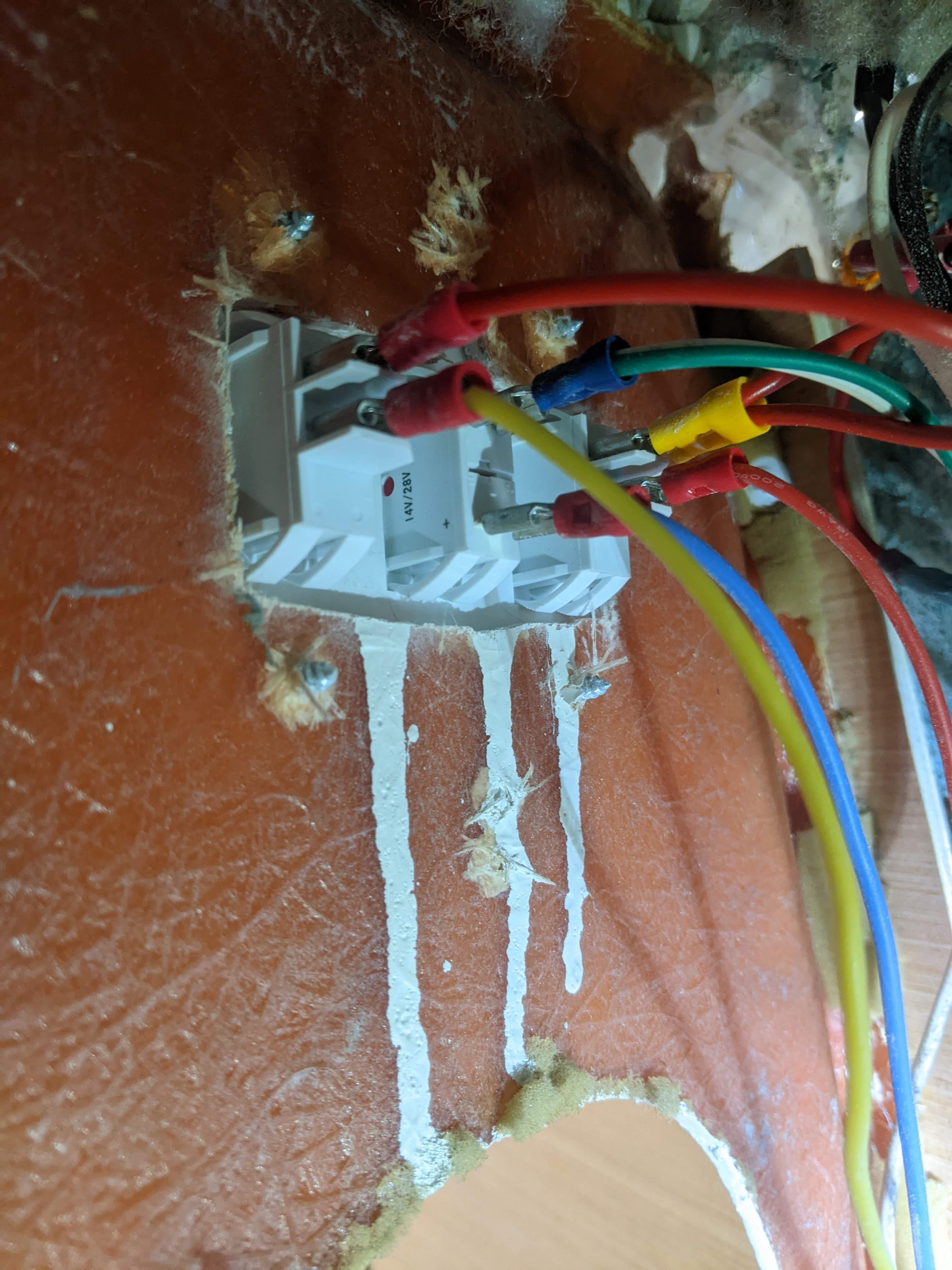

Just some question out of curiosity.
1, what gauge is the AC wiring on the heater that the ROMEX is connected to? It looks bigger than 14 AWG.
2, I did not realize the AC panel have room for a 4th breaker. For mine, it only have cutouts for 3, so I have to replace the double-width 30A breaker with two single-wide one. I am going to take a look at mine and see if it have the space for the 4th one like yours, and also look at the panel specification to make sure it is safe to do that.
3, I see two wires on the yellow-sleeved connector on the back of the heater switch panel. I assume you are using it to bundle the two switches together, correct?
(4, the yellow wire on the back of the heater panel looks like it was not crimped properly. I assume you did it yourself. I am a bit OCD, and would redo it so that you can't see the copper, but that is just me.
(4, the yellow wire on the back of the heater panel looks like it was not crimped properly. I assume you did it yourself. I am a bit OCD, and would redo it so that you can't see the copper, but that is just me.)
2. On my panel door it has four "knockouts". Three had already been removed for the preexisting breakers and the fourth I removed to add the fourth breaker switch.
3. Correct. I followed the electrical diagram for the switch and those two terminals connect to (+)
4. Yes, I've been doing everything myself so I appreciate the second set of eyes (and guidance) on these things. I'll be sure to fix that before heading out on our trip.
