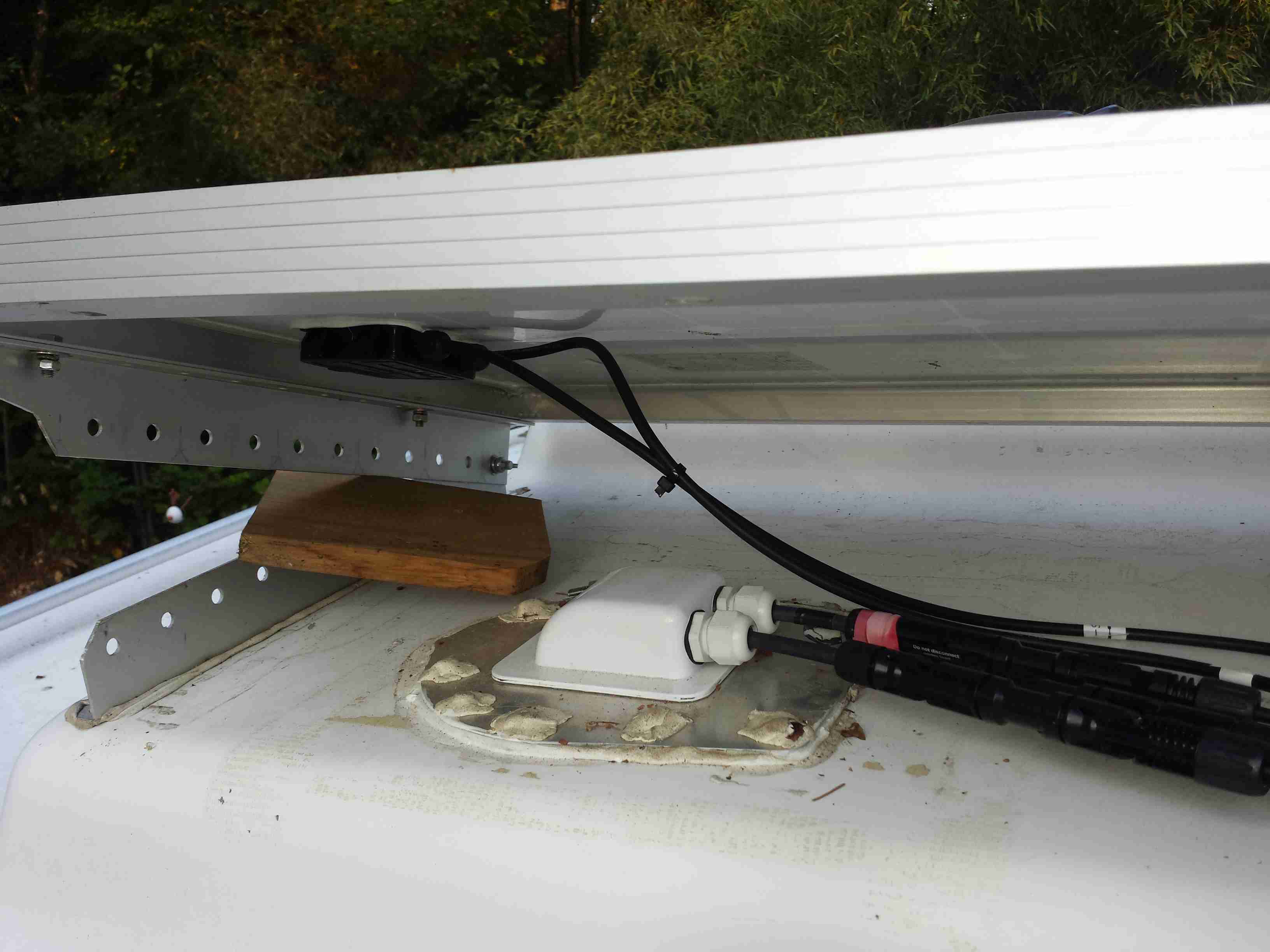

I cobbled together aluminum solar panel mounts that could tilt to a more efficient angle, if you parked facing East or West, and went up there and messed with them.
Roly

Re: Rail adapter for solar panel bracket
Roly, I am thinking using two actuators to tilt it in both directions, but I feel it is overkill for the extra electricity that I will get from it. I probably need to do a simple mechanism like what you have, and see if I can get around the issue with the inefficient MPPT charger problem with a second solar charger. I have one that I put away about a year ago, but forget where I stored it. Getting senile here :lol:
