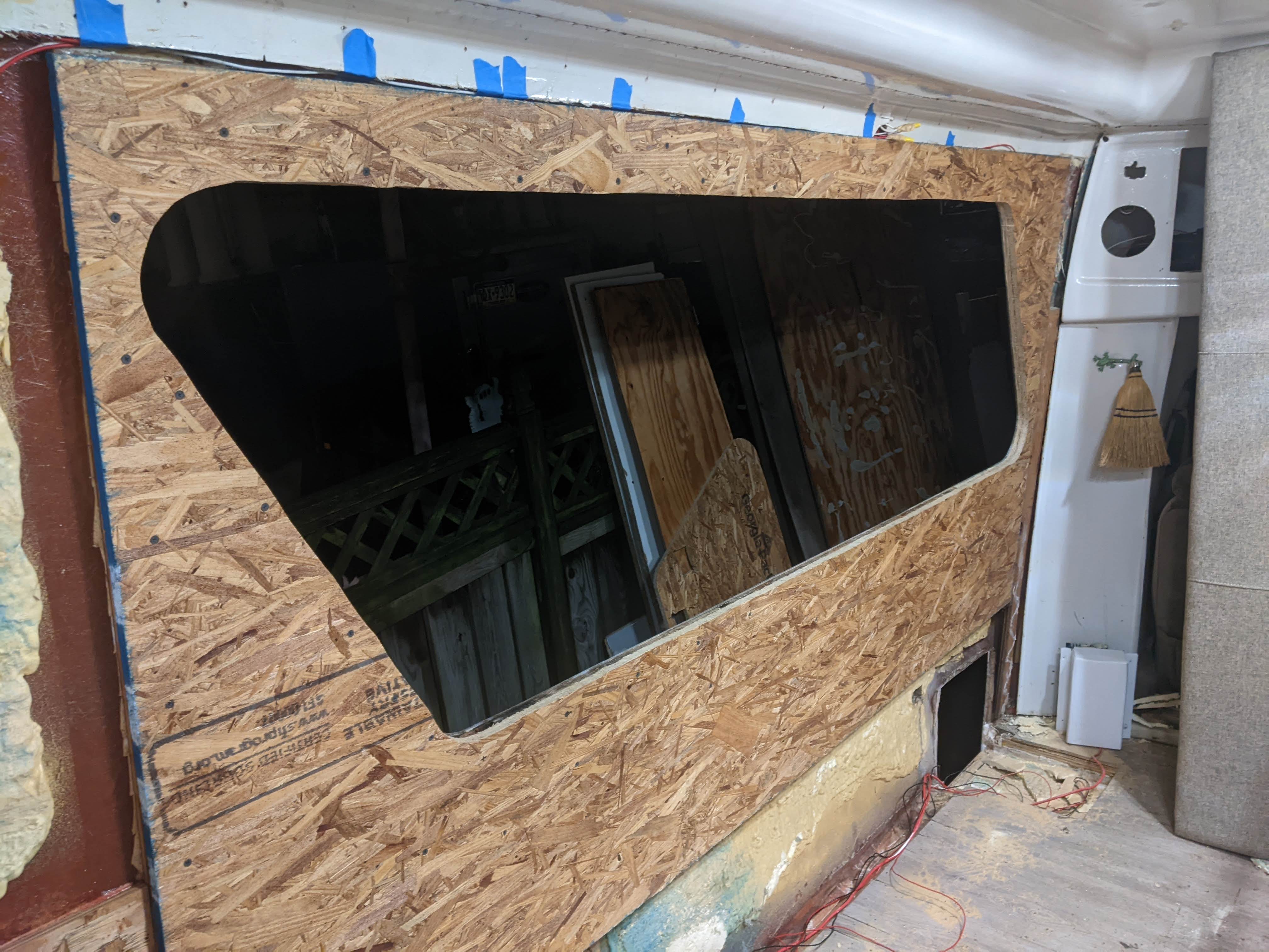

After replacing the damaged pieces with new 1/2" pieces, I placed a 19/32" sheet of 4'x8' sheathing and secured it to the wall using 1 1/8" screws. I then used a jig saw to cut the hole out from the outside. I then placed a 5mm thick sheet of wood over the sheathing with wood glue, finish nails, and a few wood screws near the top where the fiberglass curves slightly. Stacking these pieces together gave my wall a total of 1.5" thickness.
Lastly, I placed some butyl tape on the flange of the window and secured it into place with the ring clamp and new metal screws.
