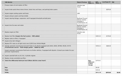

The left column is a list of the 120k Service (1 to 14) as listed in the Ford Scheduled Maintenance Guide.
12. Do I need to change the transmission fluid or just check the level? Do I have AX4S, AX4N, etc…? How do I confirm?
15. I added because Auto Repair #1’s estimate threw in something I don’t understand or I found this from another list online. What should I do with this entry?
I supposed the last column TBD should be a Ford Dealer estimate, correct? Maybe they will answer my questions above?

Interestingly the Santa Margarita Ford dealer prices were lower than two of auto repair places i visited.
#8 Fuel Filter Replace - $164.95
#12 Transmission Service - $349.95
The Santa Margarita Ford dealer says I probably have the AX4S or 4R100 and recommended a fluid change not just an inspection.
But as of April 2022 they won’t work on RVs anymore. I believe I heard that Huntington Beach Ford doesn’t work on RVs either. Huntington Beach Ford did my 90k service in 2016.
#15 Differential Service - Santa Margarita Ford - $299.95
