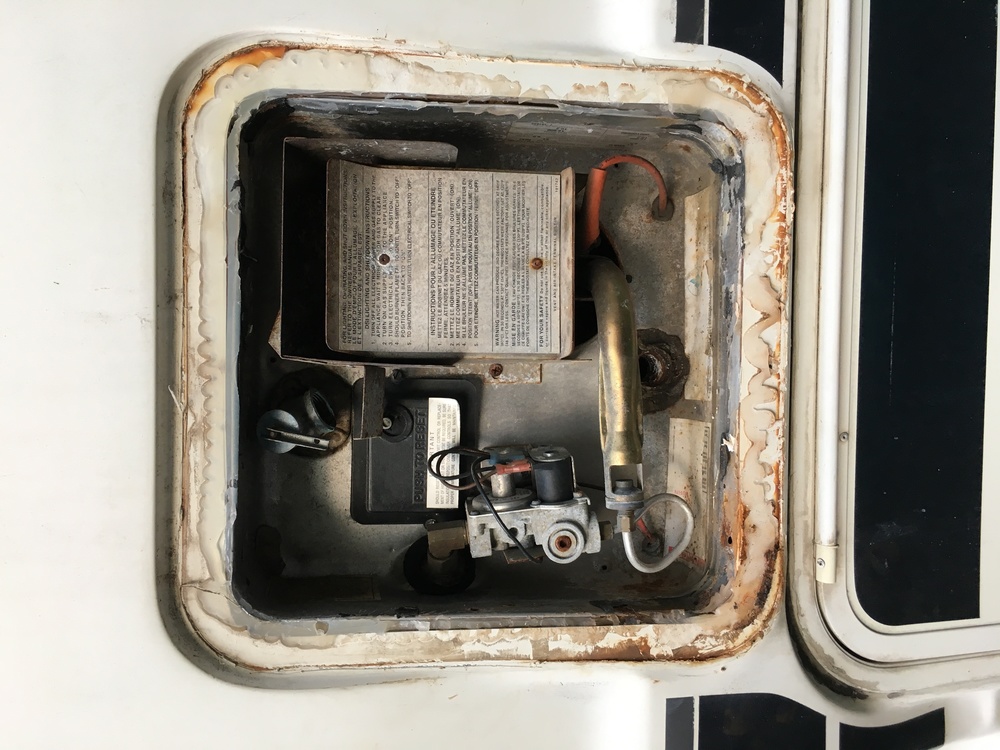

The first picture shows the tank bulging in the middle. It is showing sideways, click on it for the full size and correct orientation.

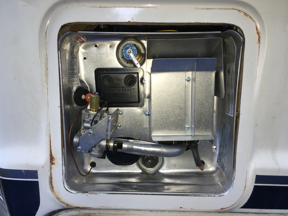

This picture shows the old heater without the frame. It fits okay around the edges, with a fairly consistent gap all around. It is showing sideways, click on it for the full size and correct orientation.

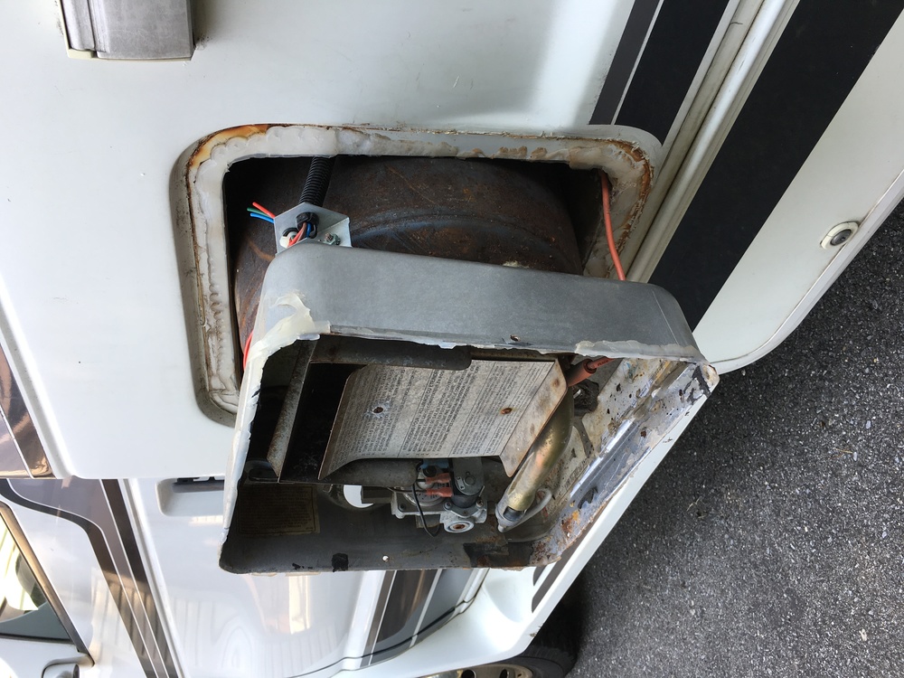

This last picture shows the new heater without the frame. You can see what a large gap there is at the top.
